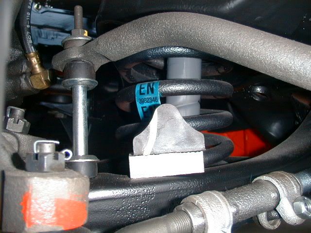

Ok, I am going to post two pictures that will pretty much tell the story. Again, I reviewed these on the basis that I would be subjective and let both party know of where I stand about this car. When I reviewed these 2 pictures I knew right away that something was very wrong. I have a 1970 Z/28 sitting in my driveway and have owned more of these cars then I can remember. I'm not saying I am an expert but I know a thing or two about these cars.
Anyways, the following pictures of the rear swaybar frame brackets are in no way factory installed. They look nothing like any factory bracket I have ever seen. Matter of fact if you look close to the framerails you will not see any evidence of the correct brackets ever being installed. The welds are bad and you can see the undercoating.
Factory swaybar brackets have an eliptical shape to them and are welded to the sides of the framerail. Any 1970 Z/28 owner should recognize this right away. The ones shown in the following pictures are homemade.
I have nothing to gain from this and want to see that all parties are satisfied.
There are other issues with the car but these pretty much sum it up.
Rick H.

COPO 02-24-2006 05:45 AM
Re: Needing reassurance on purchase
As another '70 Z-28 owner, I can tell you those rear sway bar brackets aren't even close to factory appearance.

chevjon396 02-24-2006 06:14 AM
here is a photo of the correct 70 Z28 rear stab upper bracket.
http://i2.photobucket.com/albums/y45...emblyrear1.jpg
Charley Lillard 02-24-2006 06:19 AM

70Z 02-24-2006 06:38 AM
Holy crap, not even close is right. I have a close up pic of what they should look like but I don't know how to resize it and post it.

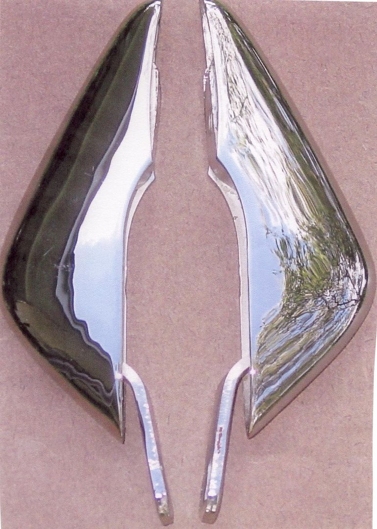

Hotrodpaul 02-24-2006 07:02 AM
Here is a pic of an original bracket off of my 70 Z-28.
http://i3.photobucket.com/albums/y86...6/DSCN4065.jpg
Also, I noticed that the car in question had no rear bumper guards and I did not see the cup style bracket that hold the gas pedal studs. The studs seemed to be attached directly to the floor. Take a look at an original bracket:
http://i3.photobucket.com/albums/y86...6/DSCN3914.jpg
Paul
Rick H 02-24-2006 07:42 AM
Two pictures for comparison.
Rick H.
http://www.camaros.com/rick/sway03.jpg
http://www.camaros.com/rick/sway02.jpg

I am not a 2nd gen z28 expert, but I have seen (and fabricated) plenty of non-original hangers, traction bars, etc., and those pics clearly show the work of a back yard mechanic.
