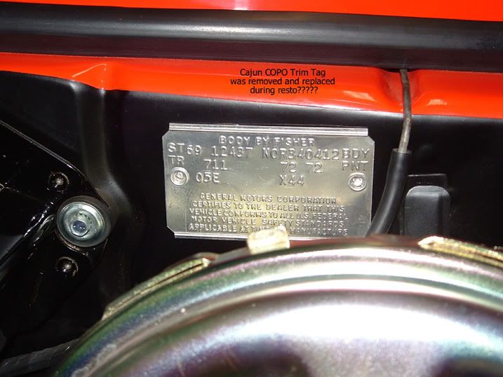

Below pic is TRIM TAG......which seller says was removed and replaced as a result of restoration....any "EXPERT" opinions on how much water this will hold......
Also if ALL 69 COPO's received BE Heavy Duty 4:10 axle's , how can this cars BV standard duty 4:10 diff be explained???
Chuck S

Kurt S 12-14-2004 02:57 AM
Re: COPO Camaro
There is a difference between 'removed and reinstalled' and 'removed and replaced'. This one is the latter, IMO.

GM-26 12-14-2004 03:00 AM
Re: COPO Camaro
There are companys that provide "replacement" trim tags. I'm sure most people on this board know that, but some may not.

DarrenX33 12-14-2004 03:10 AM
Re: COPO Camaro
Maybe I am wrong but those numbers just look to crisp. Also the fold in the top and bottom of the tag are very straight. Originals appear more rounded. Look at an original. https://www.yenko.net/ubbthreads/imag...lins/dunno.gif
Tim Greer 12-14-2004 10:32 AM
Re: COPO Camaro
I somehow don't see a brand new, shiny trim tag being a good sign.
firstgenaddict 12-14-2004 05:11 PM
Re: COPO Camaro
Nor do I. IMO like was stated earlier the top and bottom ridges appear to be too sharp.
Belair62 12-14-2004 06:55 PM
Re: COPO Camaro
Has anyone seen the actual tool to install that type of rivet ? It must be a strange looking piece.
