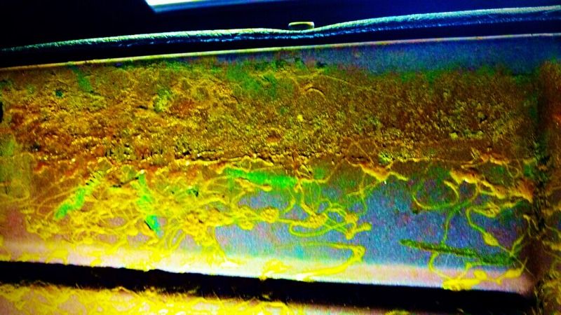

I would try a black light on the X2 under the glue. It is a grease/wax pencil, and I think UV lights can be used to trace oil leaks, etc.
Worth a simple try.

Yes I already printed the form out I just need to get the form notorized saying the title is in my nane. I hope I am lucky enough to get something back. Bob you are the 2nd guy who said try a black light I will have to get one.

John leave the glue. It's X2.
http://img.photobucket.com/albums/v6...0DE31A2E8C.jpg
