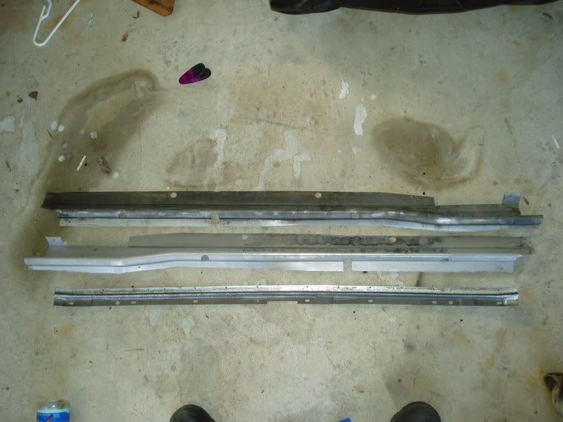

In the never ending search for more metal things to soak in that www.safestrustremover.com liquid, I found the inner sill plates and the front headliner mount. Since they are all about 5 feet long and I only have a limited supply of the precious liquid, I had to create a five foot by 3 inch deep by 5 inch wide trough. I went to the local Home Depot and bought a section of plastic roof gutter for $3 and some 4 mil plastic sheet and created an plastic lined trough the exact size. I then filled it with the liquid and placed the parts in it for an overnight soaking.
Of course, I had to acquire the specialized tools to hold the contraption in place: Only an officially licensed, battery operated, mini-Bigfoot monster truck will do.

Xplantdad 05-12-2007 09:40 AM
Re: 72 T/A progess
Amazing...whoever caller you Mc Gyver was right on...in a good way, that is https://www.yenko.net/ubbthreads/imag...mlins/grin.gif https://www.yenko.net/ubbthreads/imag...lins/beers.gif

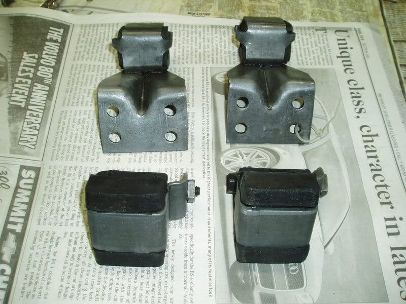

More amazing results from the amazing rust remover stuff. The guy that invented this should get the Nobel Prize in Automotive Chemical Engineering. After dipping overnight, you can even see the "W" stamps plain as day. After rinsing them off and letting them dry in the sun, I sprayed them with Boeshield to preserve the original metal finish. I love this stuff!
These were the completely rusted tail pipe and main muffler hangers for the T/A (totally unavailable for years. And the repros made by Gardner, while very close, have manufacturing differences that are visible to the trained eye)

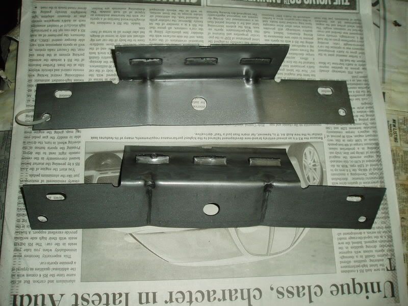

I even threw in the interior door panel mounting plates which were surface rusted.

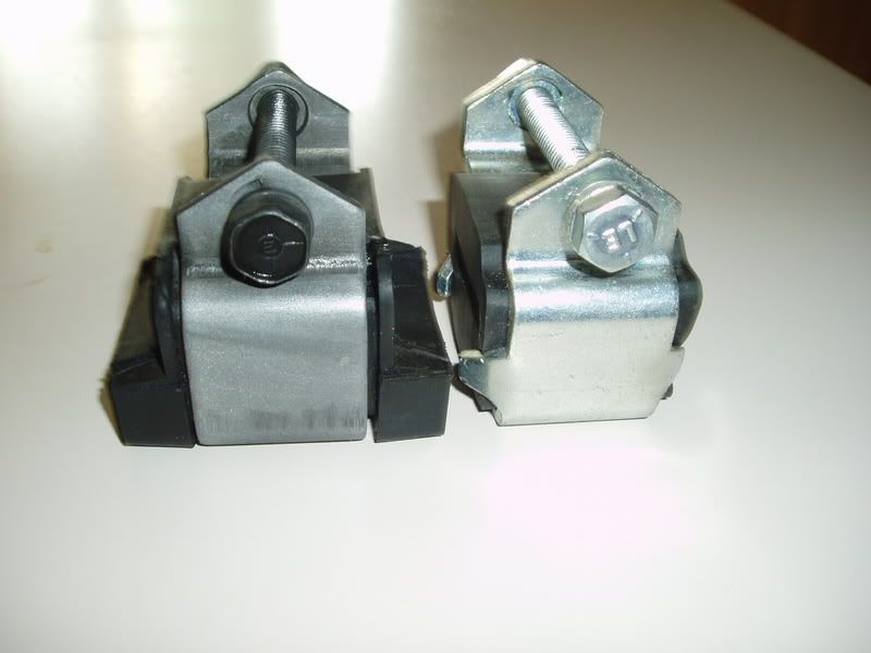

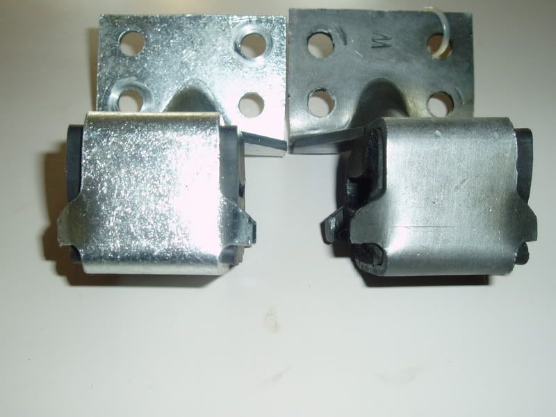

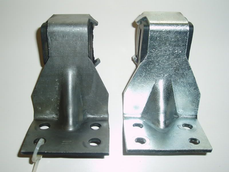

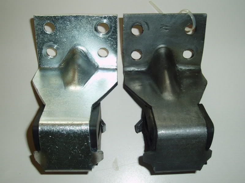

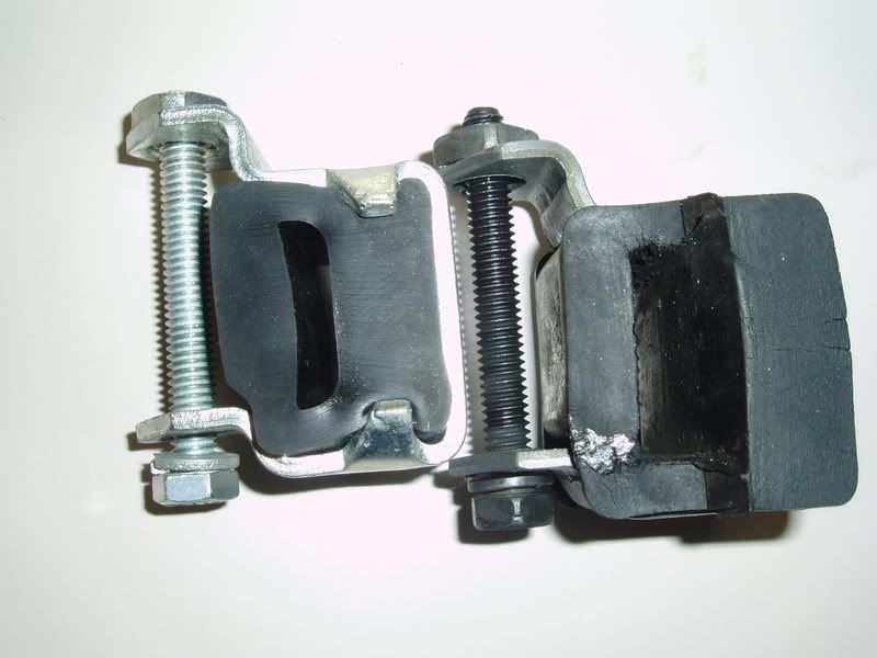

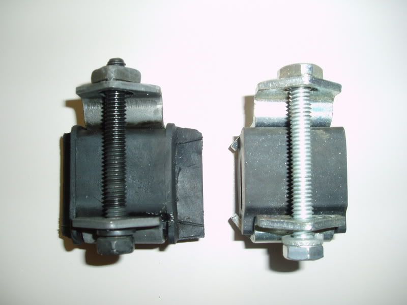

Here is a photo comparison of my original hangers and the Gardner ones. I don't mean any disparagement concerning the quality of the repros. They look awesome but maybe there was a running assembly line change by 1972???
The muffler hanger definitely uses a different rubber bushing and method of containment for it. Smaller bushing with bent retaining tabs on the repro vs. extended shoulders on the original bushing. As for the rear pipe hanger, the triangular support bracing is shorter on the repro but interestingly enough it uses the same type of bushing as the reproduction muffler hanger (with tabs.)
