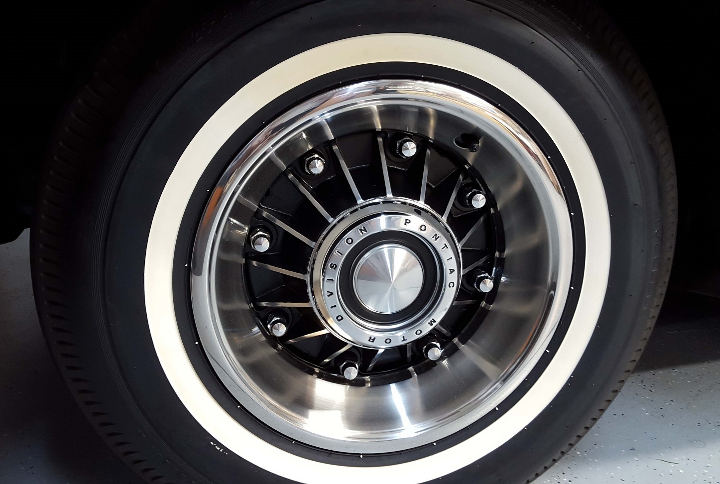

Keith Seymore 01-18-2023 01:18 PM
1 Attachment(s)
Originally Posted by Keith Seymore (Post 1611727)
I just went through quite an ordeal buying tires...
Speaking of which: now that I have the new tires mounted up and put some miles on them - I've encountered an issue where the trim ring is "walking" out of position. It's rotating far enough around the wheel that it is pushing the valve stem over hard and I fear it is going to cut it. I added a little piece of rubber hose around it to protect it as a short term fix.
Anybody ever have this happen, and any potential solutions come to mind? I'm about to add a drop of weld on the wheel to interfere with the clip as it tries to move.
K
Z282NV 01-18-2023 01:35 PM
Is it possible the trim ring is touching the sidewall of tire and the rotation is causing the ring to move? Also possible the clips on the back of the trim rings have seen better days?
I don't think I would strike any arc on the wheel itself until you figure out what is causing the movement. Maybe a bead of epoxy or silicone on the wheel instead.

Keith Seymore 01-18-2023 01:46 PM
Thank you; yes - and yes. Front rings seem to be worse than rear. Maybe JB weld would work.

Lynn 01-18-2023 05:12 PM
I have dealt with "hubcap walk" many times over the years. Steel wheels flex a little bit with every rotation. That creates a vibration on the retainer tabs and makes the hubcap (or in this case, the trim ring) walk around the wheel. Kind of like your old vibrating electric football game. I have seen it get so bad it actually rips the valve stem out, or at least over far enough that it pulls partially loose and starts leaking. Some Studebakers from the 50s are especially prone for two reasons. 1. The wheels are thinner than most, and flex more than most, and 2. The tabs are permanently attached to the wheel on some models instead of the cap.
I have cured many of them by just bending the tab to give it a bit more bite.
Look on your wheels where the tabs contact. I think you will see where the scratches have moved a bit over time as it rotates. YMMV.
