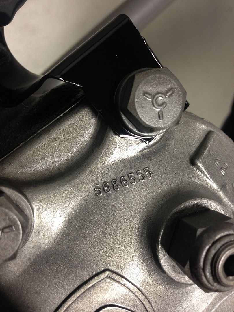

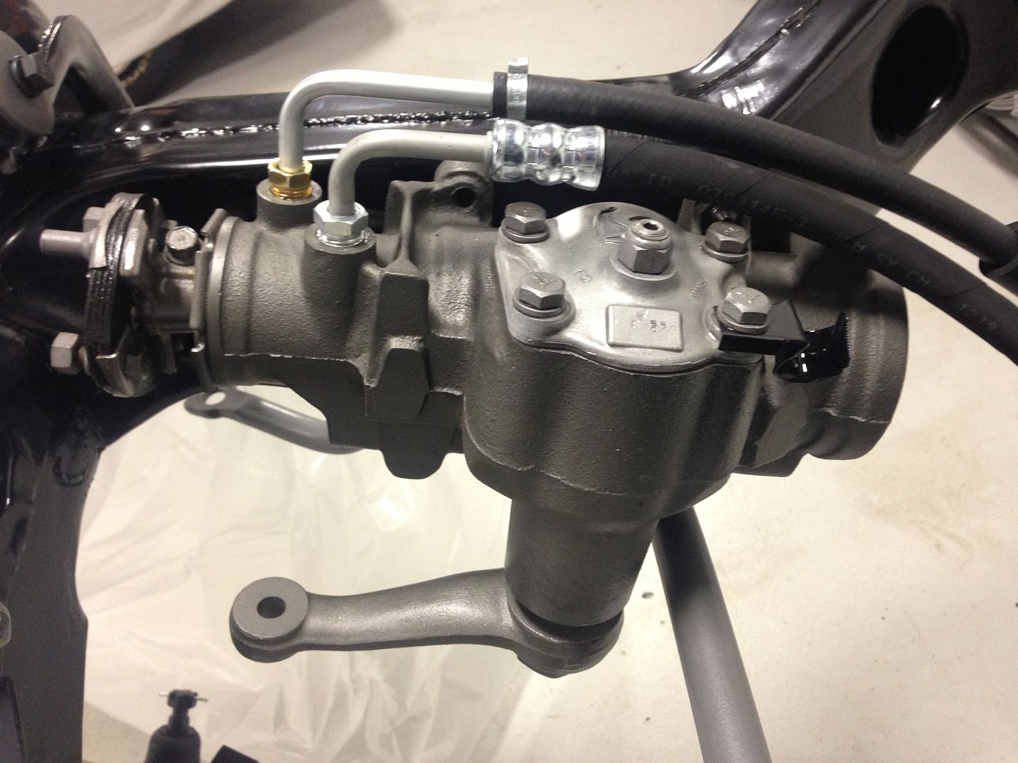

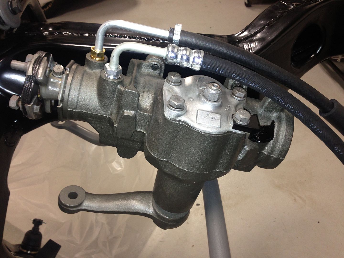

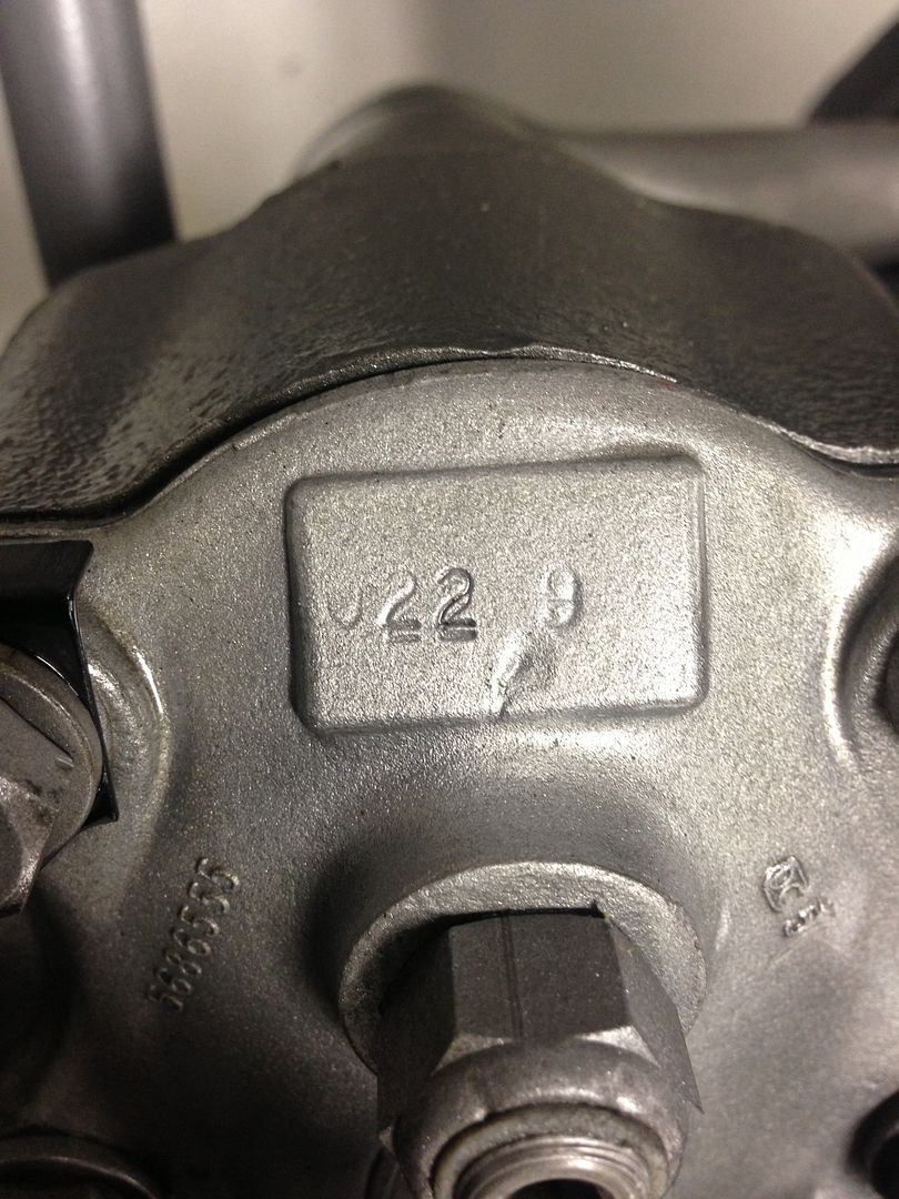

Postsedan 12-23-2015 10:05 PM
Re: 1969 SS396 325hp Chevelle
Finished restoring the power steering unit today [img]<<GRAEMLIN_URL>>/biggthumpup.gif[/img]
Check out the dual punch date stamp.

chevyman0429 12-23-2015 11:31 PM
Looking good Dan. What type of coating did you use on the gear box!
Postsedan 12-24-2015 12:13 AM
Cast paint
Damien 12-24-2015 02:31 AM
Nice work on the power steering box Dan. Did it need a rebuild as well as the cosmetic treatment?
Postsedan 12-24-2015 02:44 AM
No rebuild required [img]<<GRAEMLIN_URL>>/biggthumpup.gif[/img]
MarcDant 12-24-2015 03:01 AM
Here is dual punch date on this power steering box. Maybe the assembly line worker had
one to many scotch on the rocks for the new year. Marc.
https://www.yenko.net/ubbthreads/pics...ringbox011.jpg
