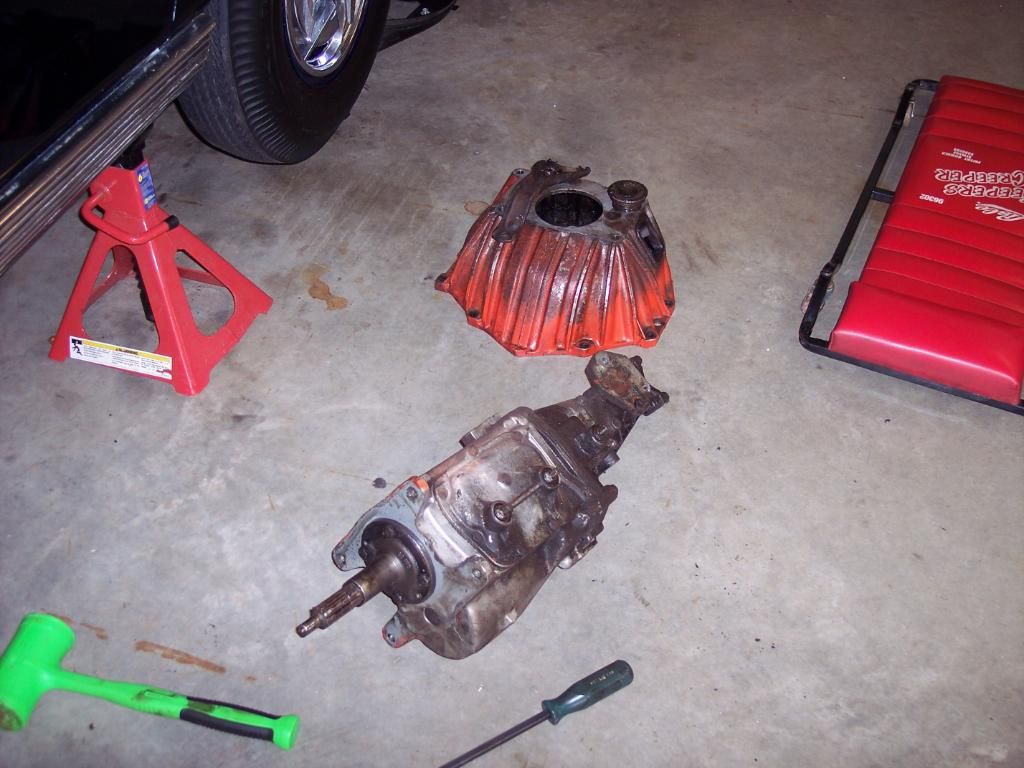

Fast67VelleN2O 02-23-2012 01:58 AM
Re: 63 Corvette SWC L84 Restoration
That transmission has the wrong input bearing retainer for a 1963. If you're using the 3788421 bell housing... that takes the small bearing retainer. For Corvettes, the early assembly line correct piece is aluminum. Later service replacements were cast iron.
-Matt

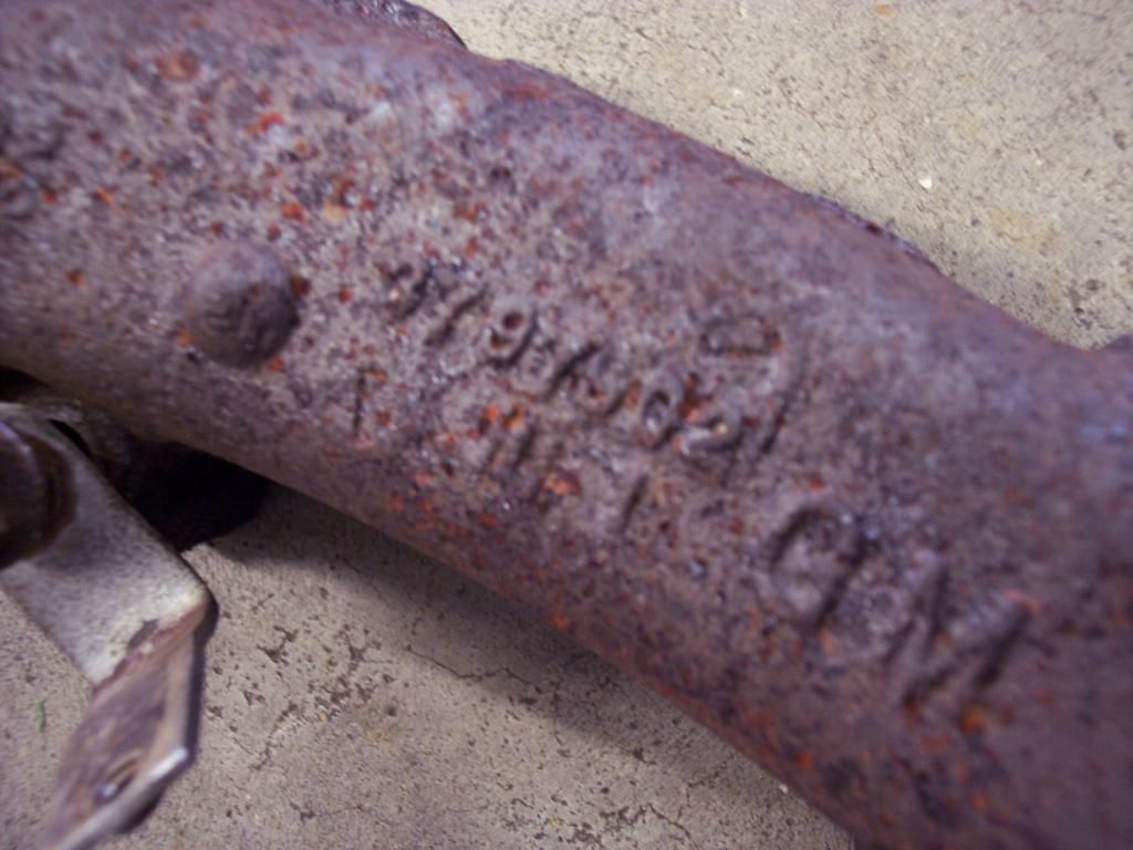

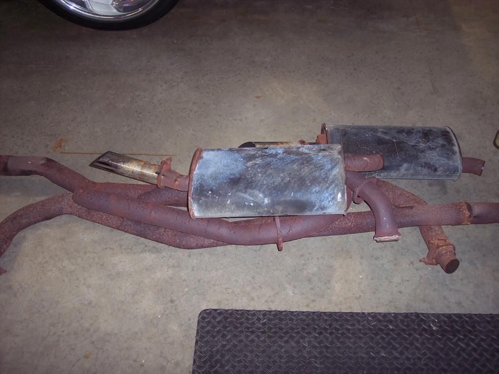

junk exhaust
http://i1043.photobucket.com/albums/...0L84/009-2.jpg

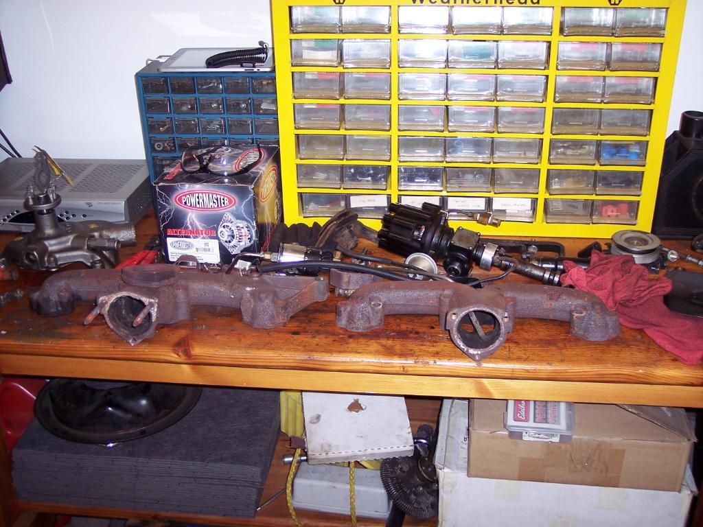

ned to send the manifolds out to have the flanges repaired. I suppose Jerry McNeisch is the best choice
http://i1043.photobucket.com/albums/...0L84/013-2.jpg

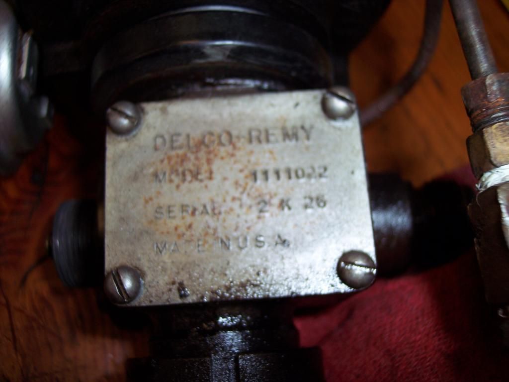

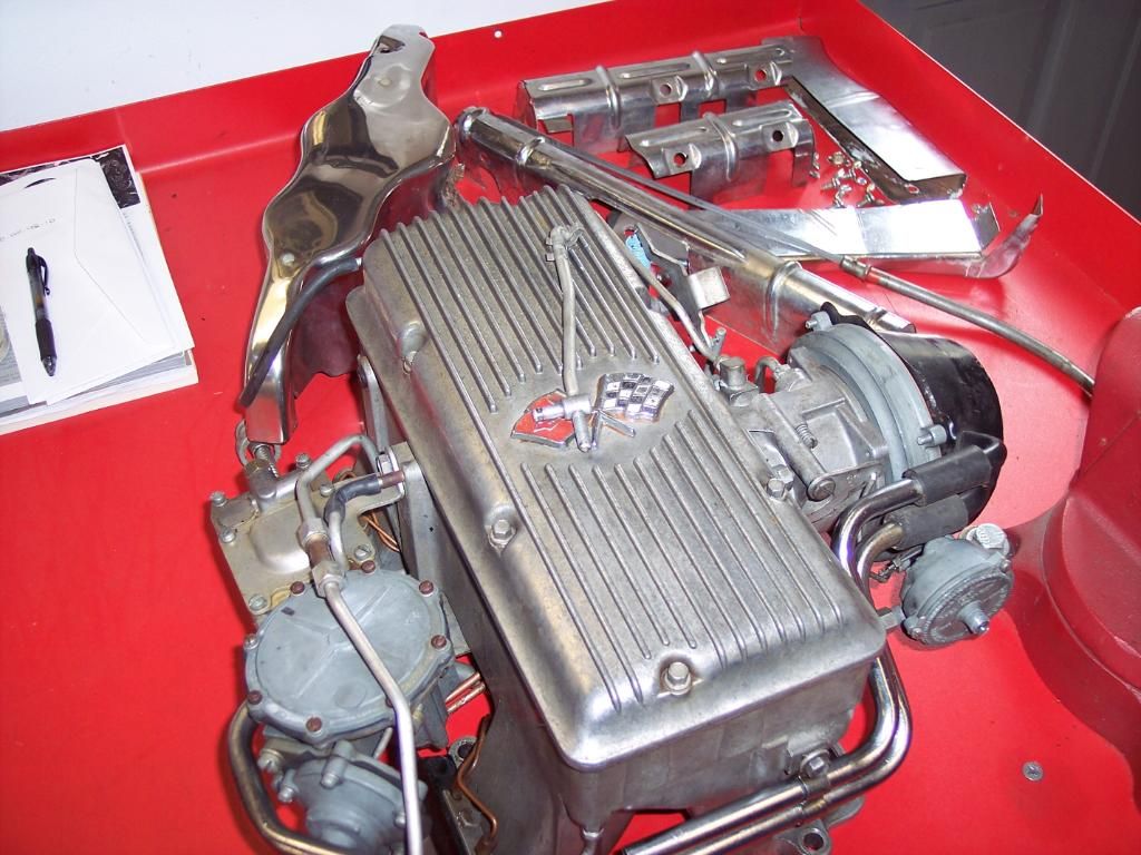

Data tag on the F.I unit
http://i1043.photobucket.com/albums/...0L84/017-2.jpg

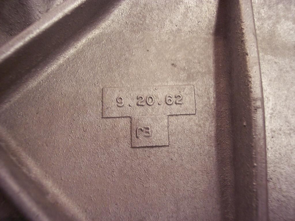

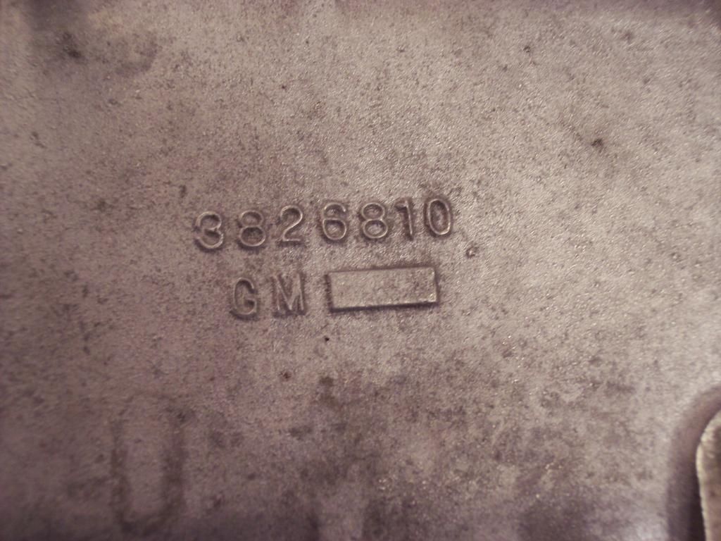

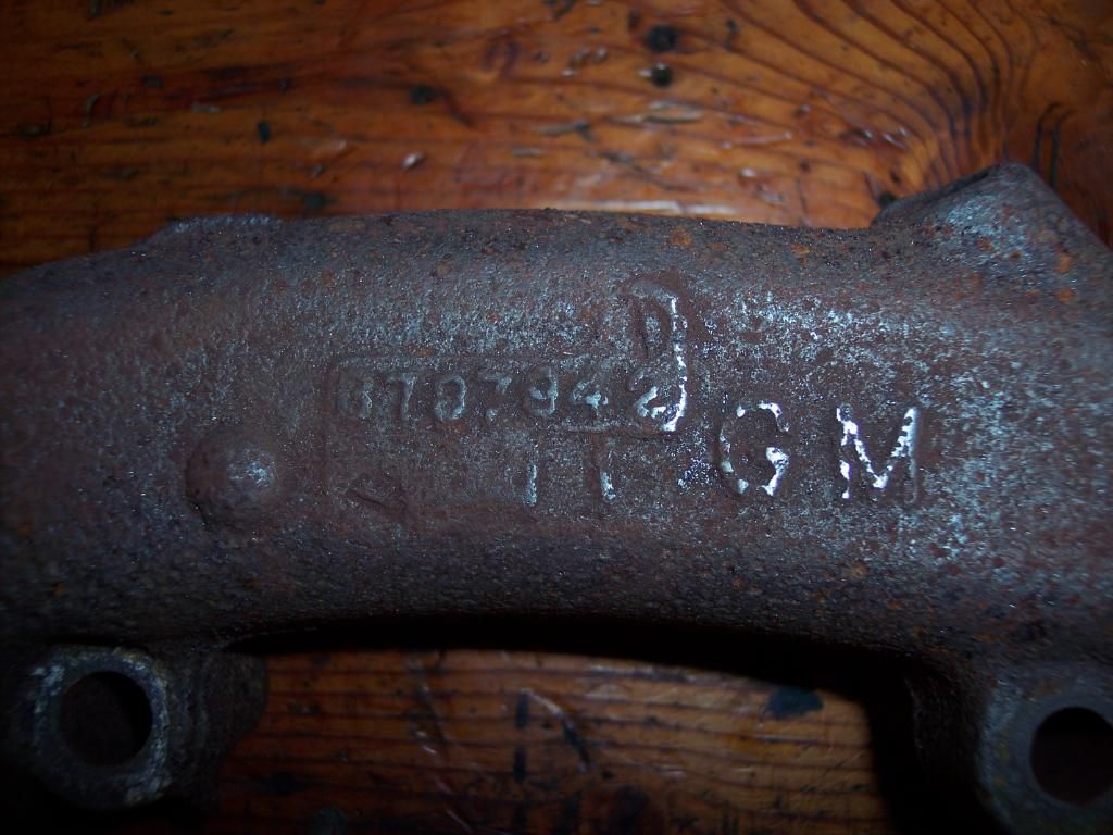

Intake casting and dates
http://i1043.photobucket.com/albums/...0L84/023-2.jpg
http://i1043.photobucket.com/albums/...0L84/021-2.jpg

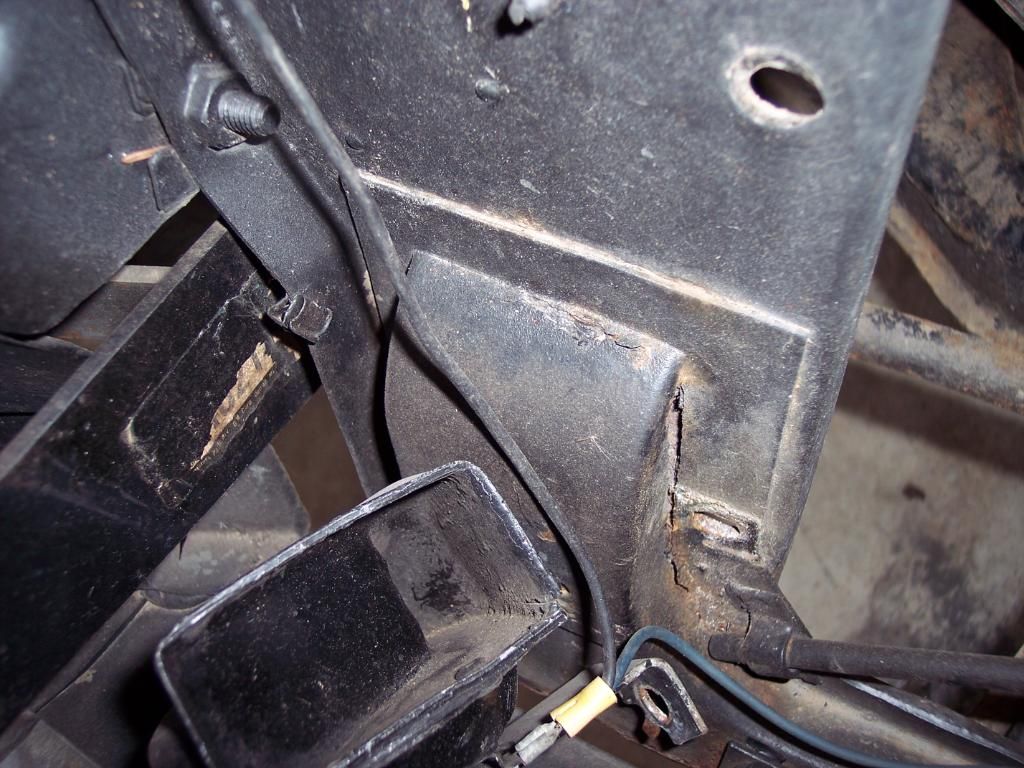

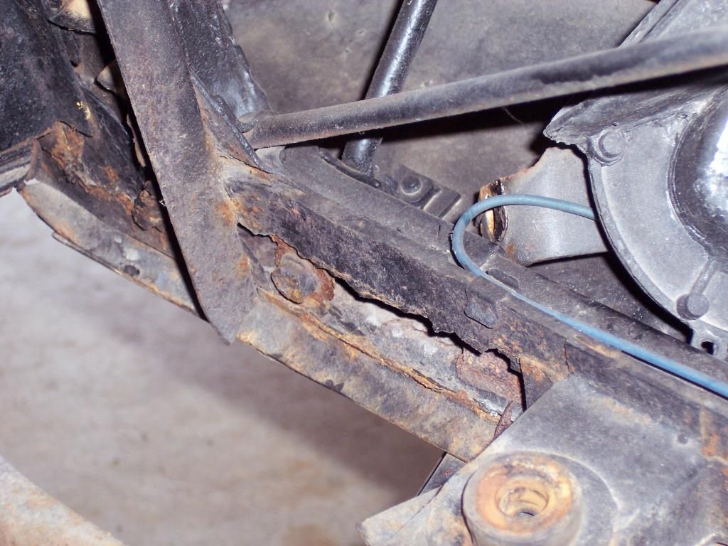

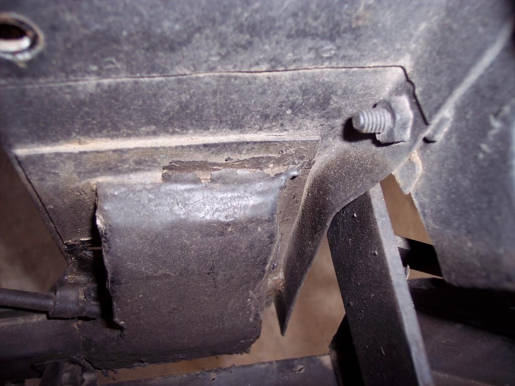

This car has the original radiator support. It's rusted more than I originally thought. I'll just have to be on the lookout for a nice used one. Please contact me if you know of one.
http://i1043.photobucket.com/albums/...0L84/031-2.jpg
http://i1043.photobucket.com/albums/...0L84/030-2.jpg
http://i1043.photobucket.com/albums/...0L84/034-2.jpg
GRNDNL 04-08-2012 04:53 PM
Does the radaitor support bolt in?

<div class="ubbcode-block"><div class="ubbcode-header">Originally Posted By: GRNDNL</div><div class="ubbcode-body">Does the radaitor support bolt in? </div></div>
Yup! Thankfully! [img]<<GRAEMLIN_URL>>/smile.gif[/img]

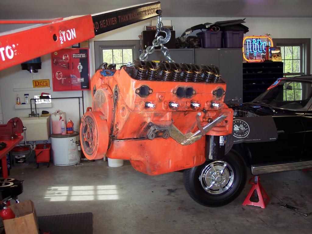

A little progress this week.

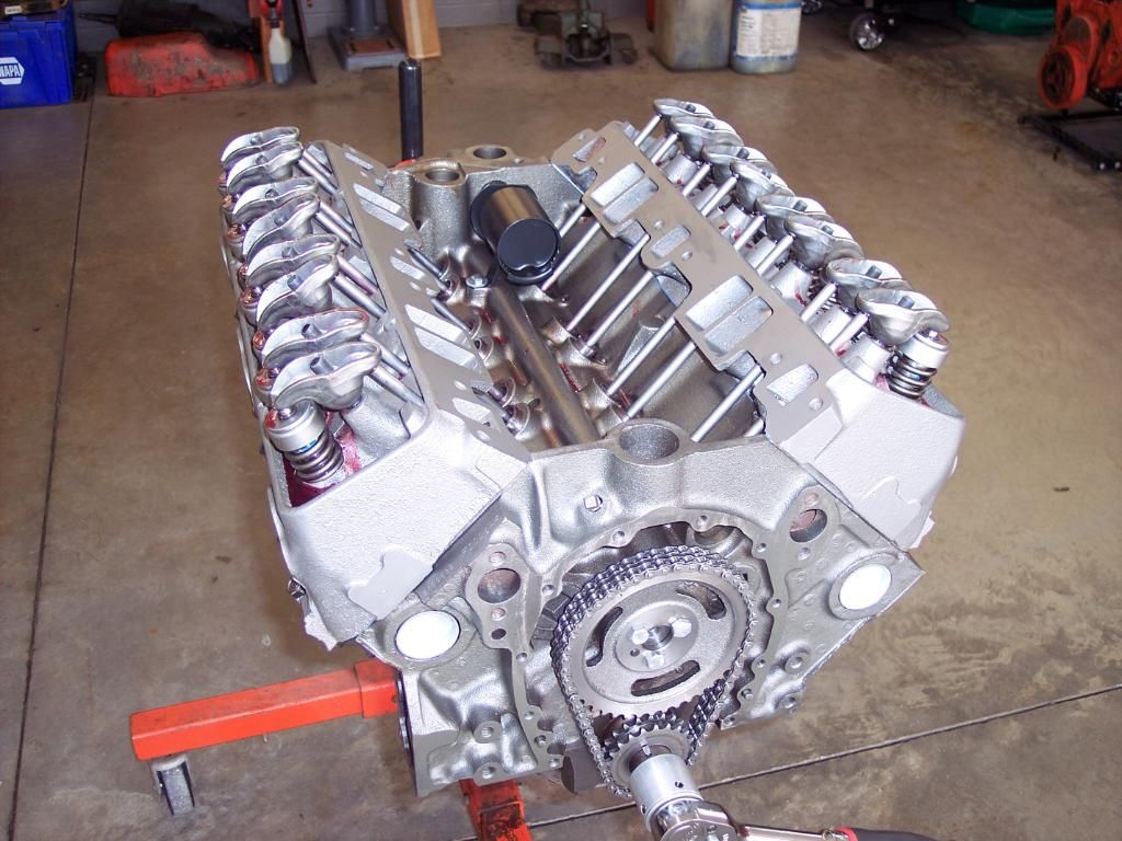

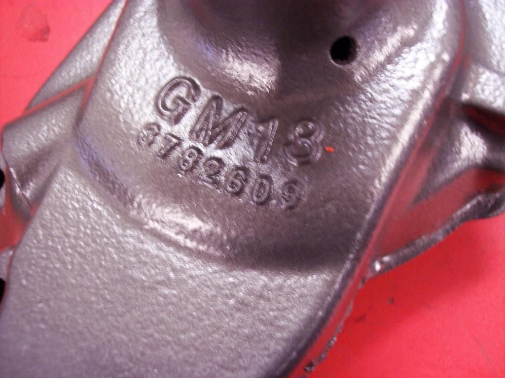

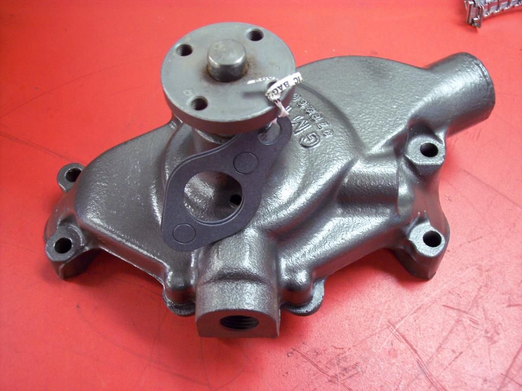

My 609 pump
http://i1043.photobucket.com/albums/...0L84/003-3.jpg
http://i1043.photobucket.com/albums/...0L84/002-2.jpg
stripping the oil pan
http://i1043.photobucket.com/albums/...0L84/001-2.jpg
and my buddy Kevin checking the cam install
http://i1043.photobucket.com/albums/...0L84/004-3.jpg
http://i1043.photobucket.com/albums/...0L84/005-3.jpg

Stop by with the radiator support, doesn't look that hard to fix from the pics.
