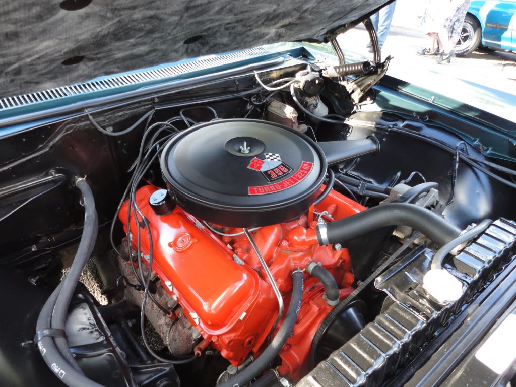

kwhizz 08-30-2011 06:07 AM
Re: slow heating
http://i13.photobucket.com/albums/a2...1/DSC03365.jpg
http://i13.photobucket.com/albums/a2...1/DSC03366.jpg
