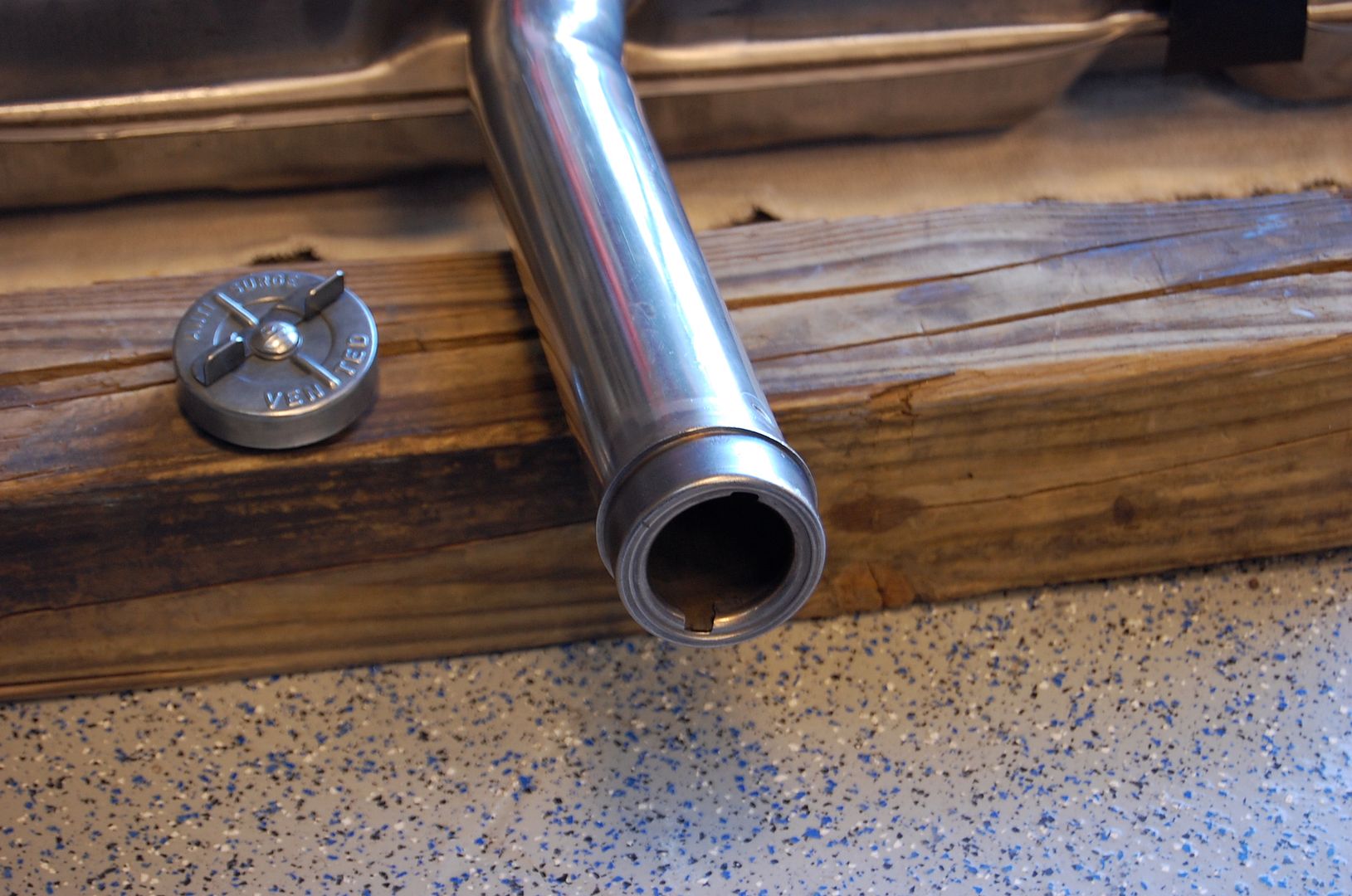

mockingbird812 03-29-2010 09:18 AM
Re: Gas Tank Filler Necks: Anatomy/Physiology?
Conducted the procedure this weekend. Mikey didn't steer me wrong. Dry-ice worked like a charm and the original gas cap has been mated back with the cap receiver. Thanks for all of your input. https://www.yenko.net/ubbthreads/imag...lins/beers.gif I feel much better now! https://www.yenko.net/ubbthreads/imag...lins/laugh.gif
P.S. the notion of an exploding gas tank made me think of the tank as a rocket ship, so I made a launch pad!https://www.yenko.net/ubbthreads/imag...mlins/grin.gif
http://img.photobucket.com/albums/v6...DSC_0026-1.jpg
You can see the dry ice doing its thing here. By the time i was done the project and ready to mount the tank back on the Nova all of the dry ice had disappeared with no residue.
http://img.photobucket.com/albums/v6...DSC_0028-1.jpg
http://img.photobucket.com/albums/v6...DSC_0029-1.jpg
http://img.photobucket.com/albums/v6...s/DSC_0034.jpg
http://img.photobucket.com/albums/v6...s/DSC_0036.jpg
