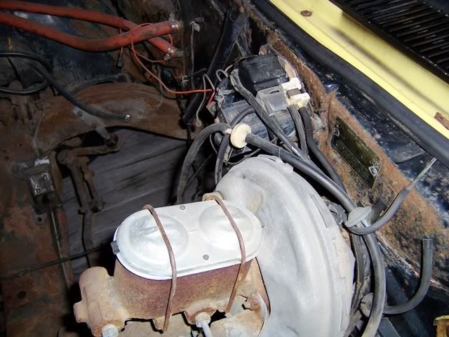

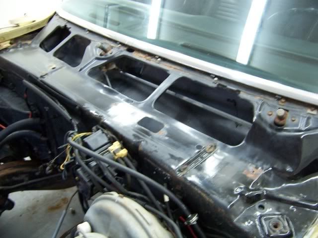

67L78conv 07-26-2009 07:14 AM
Re: 1968 Z28 COWL COLOR
These are some shots from an 04D LOS special paint 68Z that was at Carlisle this year. Original paint and most components still on the car. Looks to me like the area under the cowl is all black gloss same as stripe color on this one as well.
Hope it helps. https://www.yenko.net/ubbthreads/imag...lins/beers.gif
http://www.musclecarmediallc.com/posts/68Zfirewall.jpg
http://www.musclecarmediallc.com/posts/68zcowl.jpg
http://www.musclecarmediallc.com/posts/68zcowlb.jpg
