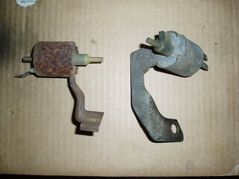

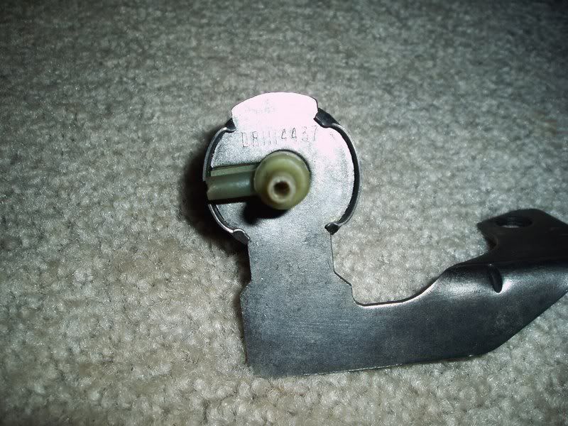

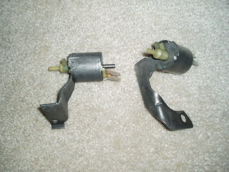

I've been playing around with the derusting liquid again. https://www.yenko.net/ubbthreads/imag...mlins/grin.gif This is what it did for two rusty spark control solenoids in my parts bin. This was after a two day soaking.
Here's the before:

and the after:

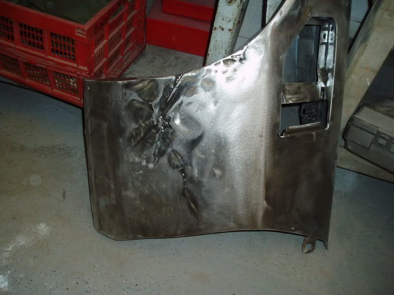

ENOCH just stripped the drivers side fender on the T/A and the he found this. It looks like the result of a tire getting loose and caving in the fender. The metal is extemely overworked, brittle, and stretched and the best bet according to ENOCH is to weld in a section from another fender that would go from the lower body line to the upper body line. Does anyone have a regular 70 to 81 Firebird fender that is wrecked in the front that would be good as a donor? I dont need a whole fender and the shipping costs are crazy for a complete one. I am open to suggestions.

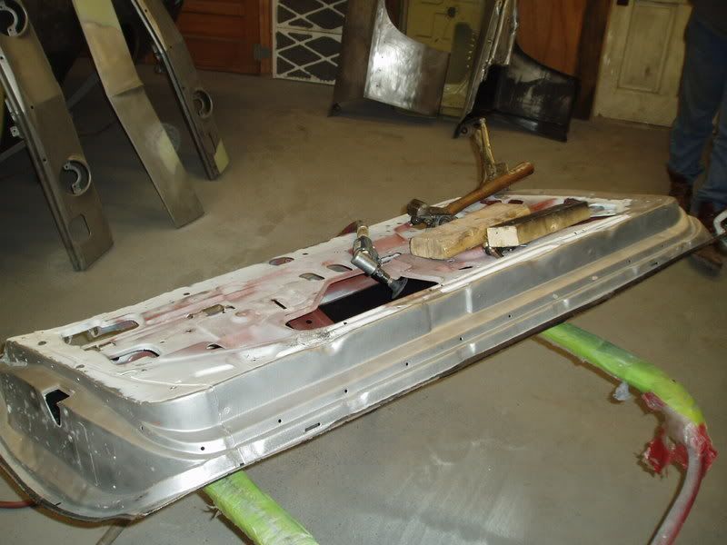

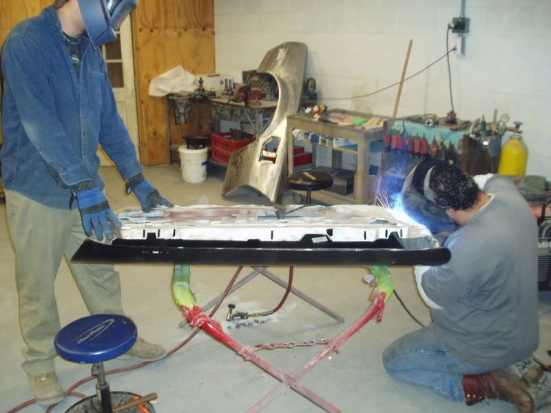

Here's the drivers door getting the NOS doorskin fitted and tack welded. A lot of hammering and welding going on here in order to make the original factory doorskin fit the original factory door!
