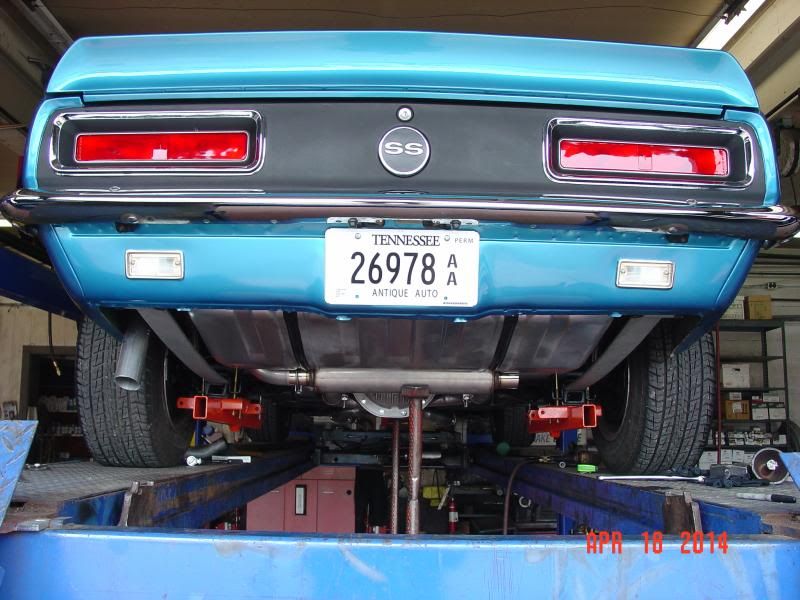

Not to steer you one way or another but I ordered a Jones x-pipe, Pypes Race Pro Crossflow muffler then went to my local exhaust shop and had the guy fab up the pipes and made it look and work with stock brackets and clamp locations. Ran headers with 3.5&quot; collectors that reduced down to 2.5&quot; all the way out. Total I have less than $400 in the exhaust. Of course I already had the headers, reducers &amp; hangers.
http://www.summitracing.com/parts/pye-mvr100
http://www.summitracing.com/parts/jex-xp4/overview/
http://img.photobucket.com/albums/v6...psfffade20.jpg
http://img.photobucket.com/albums/v6...psb8db40eb.jpg
