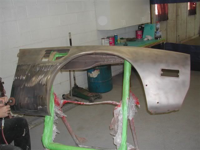

njsteve 11-26-2006 05:35 PM
Re: 72 T/A progess
The front sheet metal and other panels are at ENOCH's shop in Pennsylvania. He updates me with photos of the progress. Once the front clip is done I hope to bring the rest of the car to him to finish the job. It's been 2 years since I started this project in November, 2004 and I'd really love to get her on the road for next spring. Here are some shots of the trunk lid and passenger fender getting done. Both were rust-free so they were stripped, scuffed and primed. The fender had a small dent in the flare area and had to be massaged back into place.

Xplantdad 11-26-2006 06:30 PM
Re: 72 T/A progess
Looking good Steve. Massaging metal...a sort of lost art these days... https://www.yenko.net/ubbthreads/imag...lins/beers.gif
