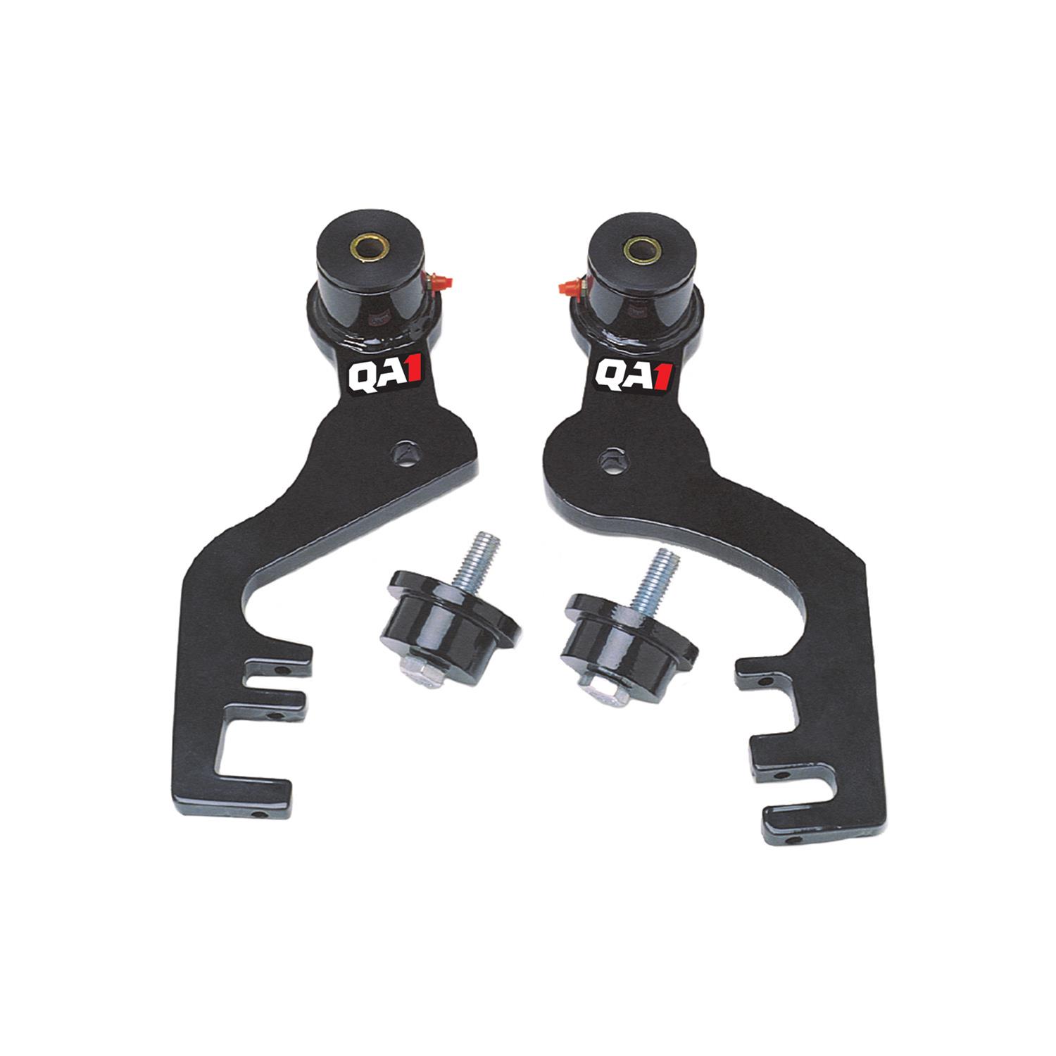

I think Bill is talking about "Southside Machine Bars". This is a brand name but they locate the rear of the lower control arm lower than stock. I've used them in the past and noticed no difference in ride quality. JMO
Too Many Projects 09-21-2023 06:46 PM
These bars don't affect the ride at all. The bars that are similar to leaf spring bars might. The holes in the 3 "fingers" would require you to drill thru the "fins" on the diff housing for a long bolt to go thru. If you prefer to not do that, they still work well.

Yes, the QA-1 bars are the ones I am considering - but I did see where one person had said they made the car ride worse. But you can hear anything, especially in the internet era.
The South Side Machine bars are not legal for the Pure Stock Muscle Car Races.
If the QA-1 bars help with traction - as well as stopping the wheel hop - I should be able to get my 60 foot times into the 1.9 sec. area - as I had several 2.07 60 foot times this year.

What are you running for shock absorbers ? Good, HD shocks will help curb the rebound of the diff/springs releasing tension. The stop hop bars relocate the upper control arm higher at the diff to give the suspension a better geometry to combat the hopping.
olredalert 09-23-2023 04:50 PM
----Thanks for a better explanation, Mitch. Yes, stop hop bars push the instant center about three feet forward and the result is no hop! Used them on Red Alert with great outcome....Bill S
