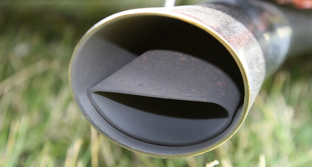

https://i.postimg.cc/MpP33VLH/00000.jpg
BTW . . . they are not Chrome Exhaust Tips. Inside the "tip" is a restrictor to reduce noise. This also reduced performance.

Ha! I've got experience with this, too.
We released a stainless tip on the GMT800 Denali/Escalade program.
With the tip in place we were not able to pass our Noise Pass-by testing criteria. Without the tip we were able to pass.
Turns out the shape of the tip was making it act like a megaphone. Our solution was to leave the diameter of the pipe intact and run it out to the end of the styled tip, rendering the stainless part as cosmetic only.
