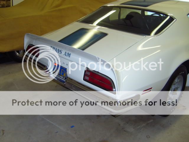

Got the rear spoiler installed today. Took a while to get the three sections lined up with each other while also fitting properly on the rear quarters. The key is to use a small circle of body dum-dum on each mounting pad so the sections can compress the dum-dum and settle properly instead of just riding directly on the quarters and trunklid.
It also took a while to get the center section of the stripe measured and lined up correctly prior to installation. Measure twice and apply once is the rule... except when you measure ten times and the math just doesn't work out. That was, until I figured out that the top of the center section is about 1/2" wider than the base. DUH!
http://i466.photobucket.com/albums/r...b/S7004836.jpg
http://i466.photobucket.com/albums/r...b/S7004839.jpg
http://i466.photobucket.com/albums/r...b/S7004835.jpg
Nice rear end! https://www.yenko.net/ubbthreads/imag...ns/naughty.gif
I always liked the look of the 70-73 'birds. Pontiac got the look just right.
http://i466.photobucket.com/albums/r...b/S7004846.jpg
So now at least the back end of the car is finished! If only I could get the shaker, hood, nose, valance and front spoiler painted and installed, then the car would be done. And then I can crown the acheivement with the installation of the restored steering wheel that has been sitting in my closet for 4 years now...if I can still find it.
