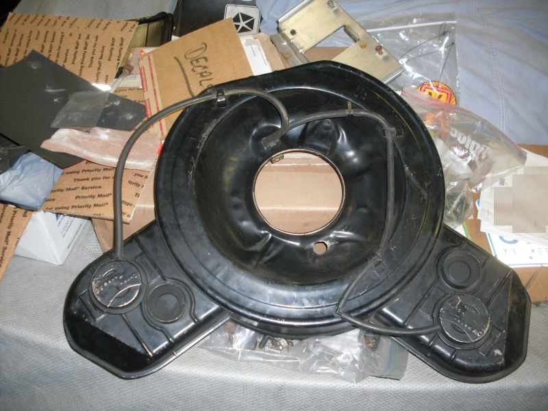

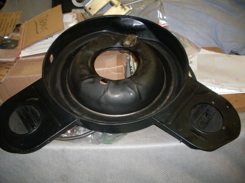

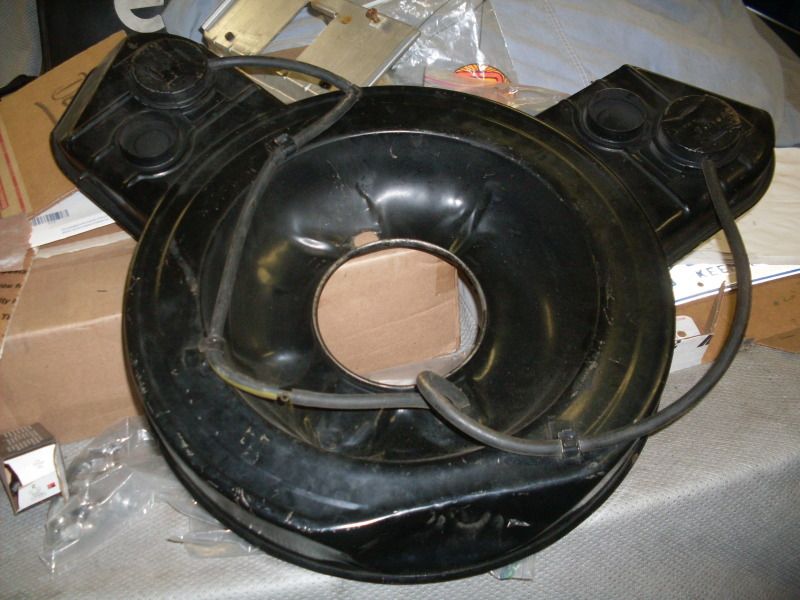

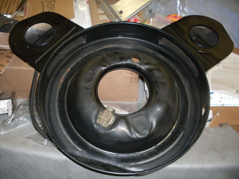

I have gotten a couple requests for photos of the super rare, Formula 455HO Ram Air, air cleaner, so here you go:
One interesting thing I noticed is that these were dip painted originally. You can see the paint line inside the two snorkels, where the air pocket kept the paint out. (The Formula 455HO air cleaner had two heat risers and the Formula 400 had only one.)
http://i599.photobucket.com/albums/t...c/SDC11962.jpg
http://i599.photobucket.com/albums/t...c/SDC11963.jpg
http://i599.photobucket.com/albums/t...c/SDC11961.jpg
http://i599.photobucket.com/albums/t...c/SDC11964.jpg

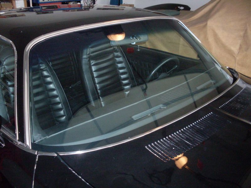

Got the windshield in for the second time...
The first date coded windshield that arrived from Pilkington Glass had some issues. The date code was supposed to be flipped but it was readable from the outside, and there were a couple scratches in the glass that looked to be from the rack they must have been stored on. Pilkington was very attentive and immediately shipped out a second one.
I can't say enough about Bob at Finishline Auto Glass in Hackettstown, NJ (908) 399-6461. He came out to the house three times - first to remove the original glass so I could clean up any possible rust issues (none found), then several days later to install the first windshield. (The scratches weren't visible until after it was installed), and then a thrd time to carefully remove the first new windshield so it could be shipped back, and then to install the second one. Extremely nerve-wracking to watch, but he is a professional and made it look easy.
FYI: if you order date coded glass make sure you give them a photo of your existing code if possible. The date codes were put on in a variety of ways and positions - the most important of which is where are you standing when you are reading the date code: is it read from the outside of the car, or read from the inside like mine.

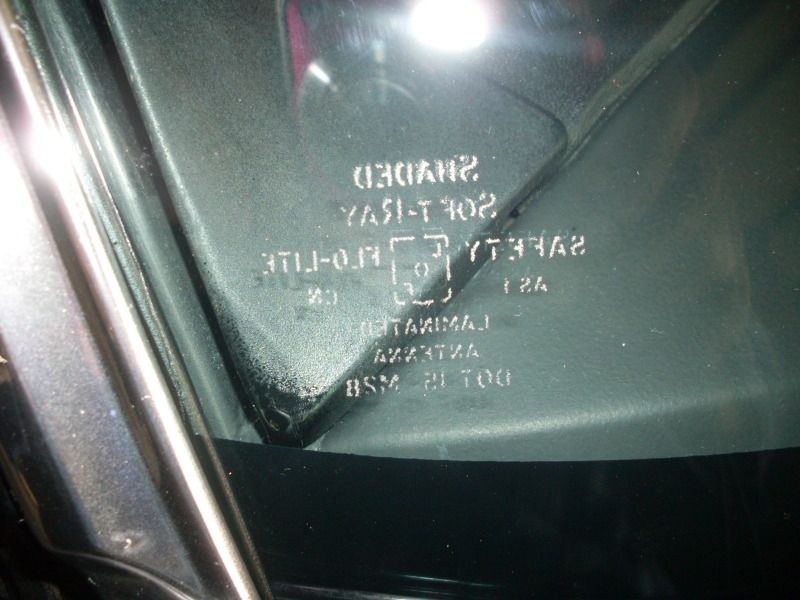

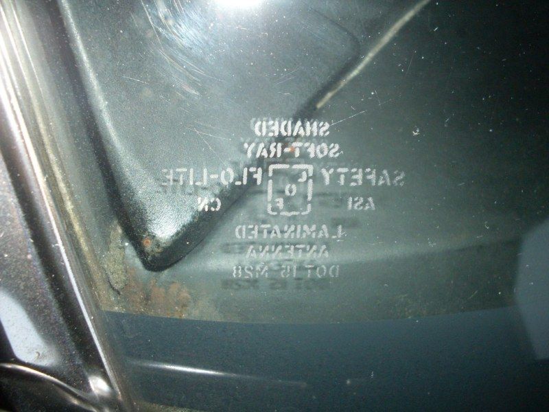

Here's the original date code:
http://i599.photobucket.com/albums/t...windshield.jpg
And the date code on the second windshield:
http://i599.photobucket.com/albums/t...c/SDC11967.jpg
And the finsh installation photos:
http://i599.photobucket.com/albums/t...c/SDC11966.jpg
http://i599.photobucket.com/albums/t...c/SDC11969.jpg
