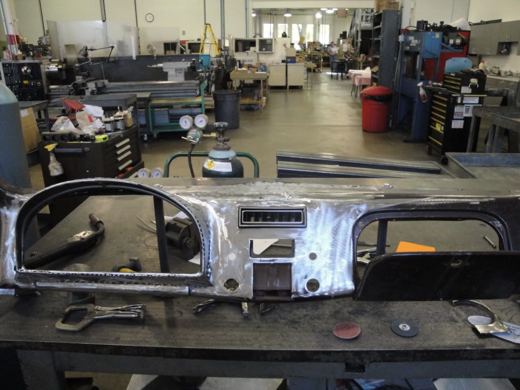

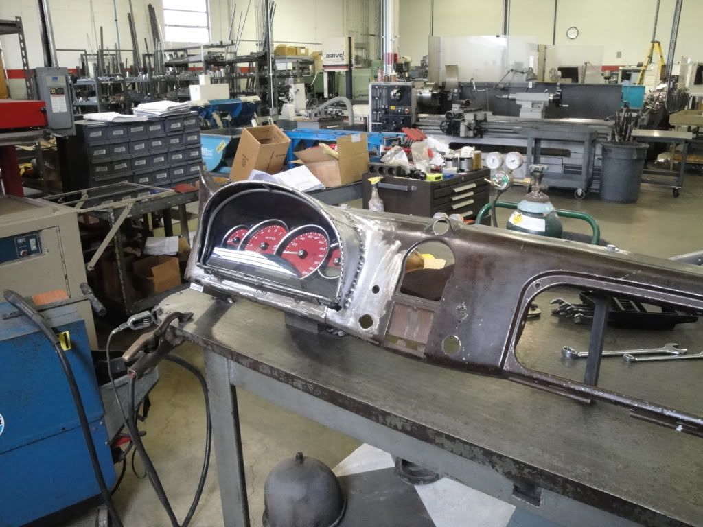

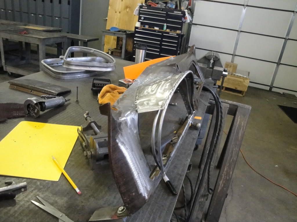

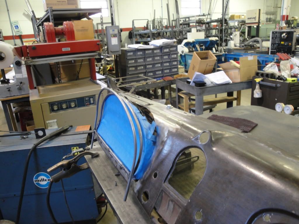

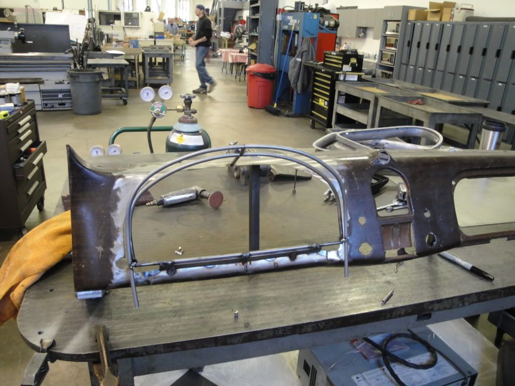

Taking the car to the Upholstry shop tomorrow.....I held off on finishing the dash until I knew that we were going to get the GTO Dash Module to be functional.......Since that happened, I can now finish up the install......Here are some pic's.....I originally roughed in a basic frame for the module......
Starting point.........
http://i13.photobucket.com/albums/a2...t/DSC01827.jpg
Bent up another Bezel to form a outer frame so the module will be recessed in the final assy.......
http://i13.photobucket.com/albums/a2...t/DSC01832.jpg
http://i13.photobucket.com/albums/a2...t/DSC01836.jpg
http://i13.photobucket.com/albums/a2...t/DSC01840.jpg
http://i13.photobucket.com/albums/a2...t/DSC01843.jpg
http://i13.photobucket.com/albums/a2...t/DSC01845.jpg
Partially Finished
Ken

Here's the part I've been waiting for. What's your framing; rod or tubing?
I'm anxious to see the blend of old and new on the dash. [img]<<GRAEMLIN_URL>>/biggthumpup.gif[/img] [img]<<GRAEMLIN_URL>>/biggthumpup.gif[/img]
kwhizz 04-29-2010 08:23 PM
Re: 37 Ford LS2 Continuation thread
3/8&quot; dia x 1/16 wall tubing......Bent everything by hand.....Patience and minimum Brain activity are all that's required...........LOL......Just dropped off the car at the Upholstery shop so I'm not going to get to do anything on the Dash today.......I had my camera with me today, but I was so excited about getting the car in, I forgot to take any pic's....But, it's only a 1/2 hour away so I'll be posting progress pic's as Dave progresses........Looking to get it back on May 15th, that will give me a week to bolt the sheetmetal on so I can (if the Planets are in alignment) take it to the Automotion show in the Wisconsin Dells......

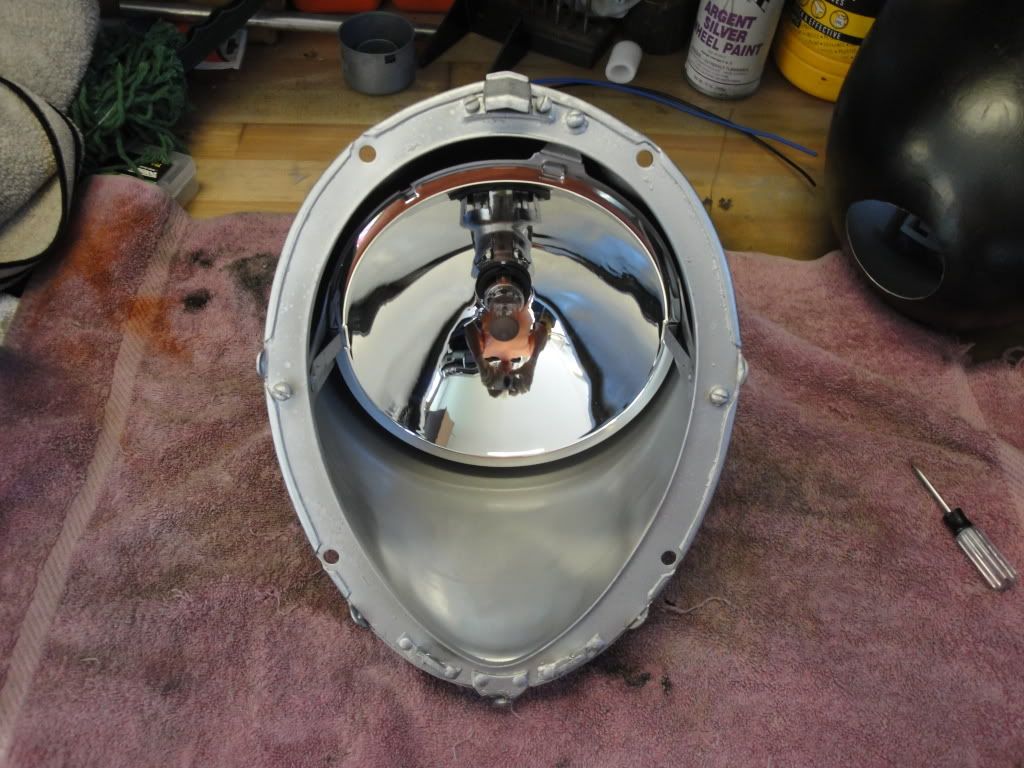

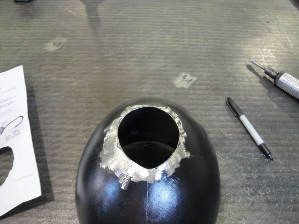

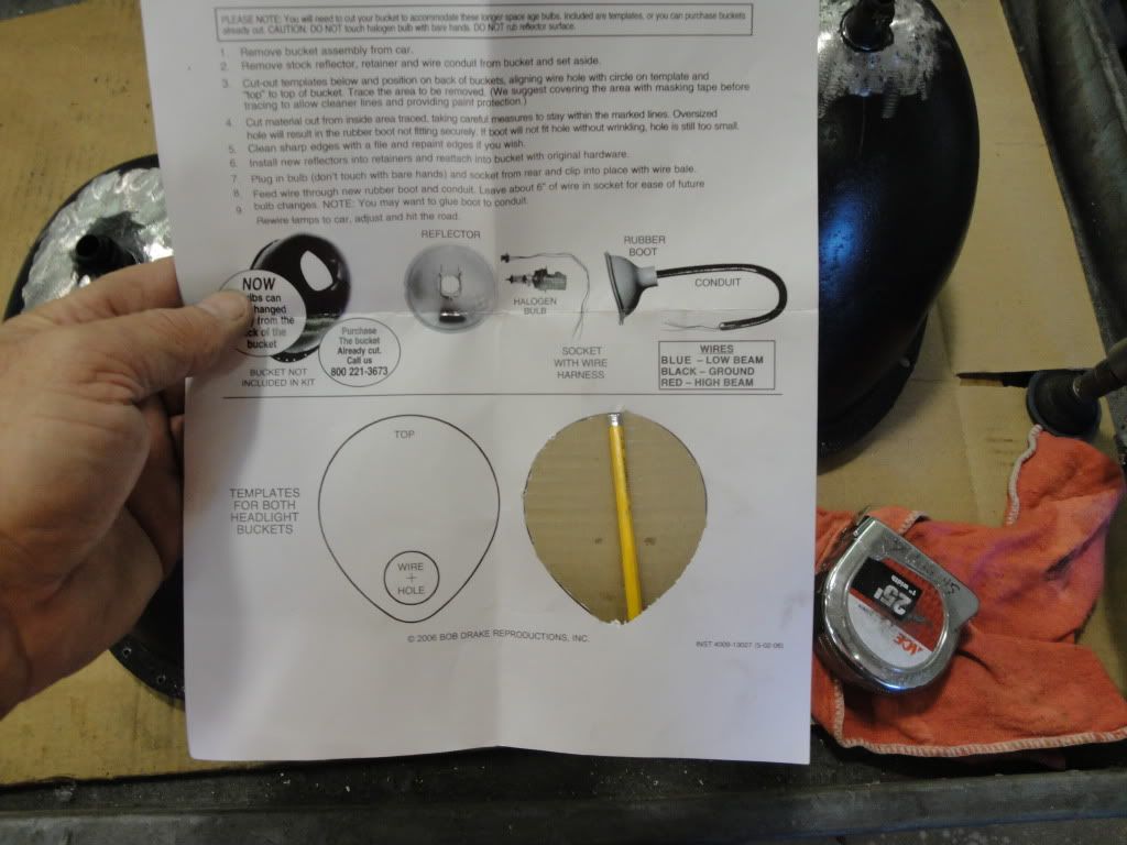

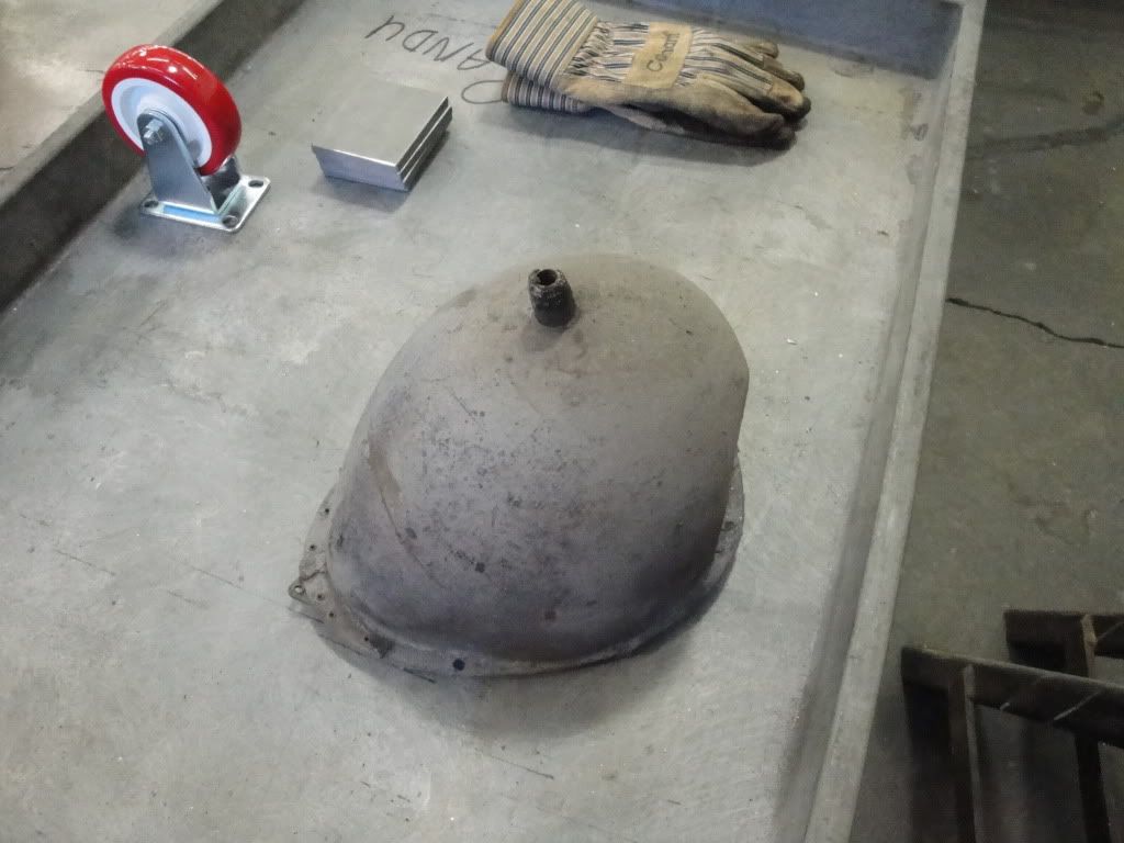

I also got the headlight buckets stripped, modified for the Halogen light kit, painted and assembled, they are just waiting for the car to come home for installation...
http://i13.photobucket.com/albums/a2...t/DSC01861.jpg
http://i13.photobucket.com/albums/a2...t/DSC01869.jpg
http://i13.photobucket.com/albums/a2...t/DSC01874.jpg
http://i13.photobucket.com/albums/a2...t/DSC01880.jpg
http://i13.photobucket.com/albums/a2...t/DSC01879.jpg
http://i13.photobucket.com/albums/a2...t/DSC01882.jpg
Ken
