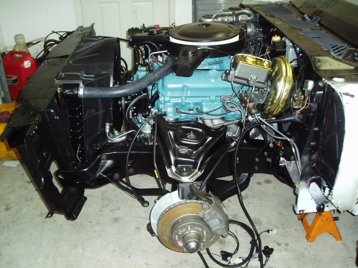

I took a little break while getting the Camaro sold and delivered, so now it's back to work. I sent the original radiator out to be recored and got it back a week later. I went to reinstall it and it wouldn't fit. Very strange, it was 3/4" too wide for the saddles. The following Monday I called the radiator guy (very reputable, long-time radiator overhauler and custom tank fabricator) and he was scratching his head also. Until finally he says: "Hey wait a minute I was recoring a Camaro radiator the same week...could I have switched the cores? He picks up the phone and calls the Camaro guy and asks him if he installed the rad yet. The guy says: "I was just about to, right now." The rad guy tells him: "Just bring it back now, I'll explain later." Turns out he did swtich the cores and there was a 3/4" difference in the widths for the same year cars. He redid my radiator with a new corre (and the other guy's too) and had it back to me in a few days. No charge. I have to say he was a stand-up guy about the whole thing, no questions, no excuses. You don't find that very often these days in service industries. I would definitely recommend him: Arts Radiator Fabrication in Flemington, NJ. He was surprised that I wasn't angry. I explained it this way: if it was a simple mistake that I could have made, there is no way that I would fault anyone else for making the same mistake. So I guess the lesson for all of us is the old saying: "measure twice and cut once." Or in this case: "measure twice and install once."
I also found a correct, original master cylinder on ebay for $18, complete with the bleeder screws and had my local auto parts store send it out and had it rebuilt. I installed it and filled the system with silicone brake fluid and bled it. I prefer the silicone fluid on restorations because if you ever have a leak or a drip, it won't hurt the paint. Easy insurance.
http://i20.photobucket.com/albums/b2...adinstall1.jpg

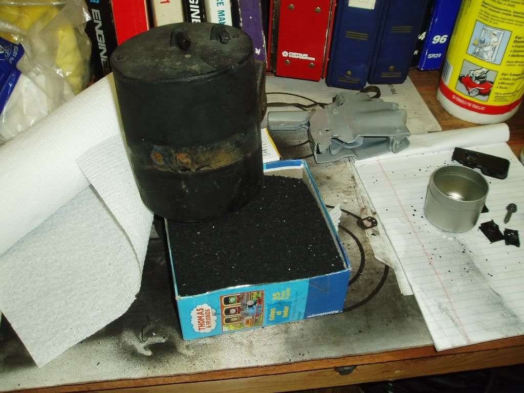

I found another 1971-72 charcoal cannister and restored that. My original had some slight nipple damage (insert joke here) from the previous owner's fire. Being the dummy that I am I always wondered why they called it a charcoal cannister. That was until I pulled the filter off the bottom while having it right side up. Here's what came out: about two pounds of charcoal.
http://i20.photobucket.com/albums/b2...8/charcoal.jpg

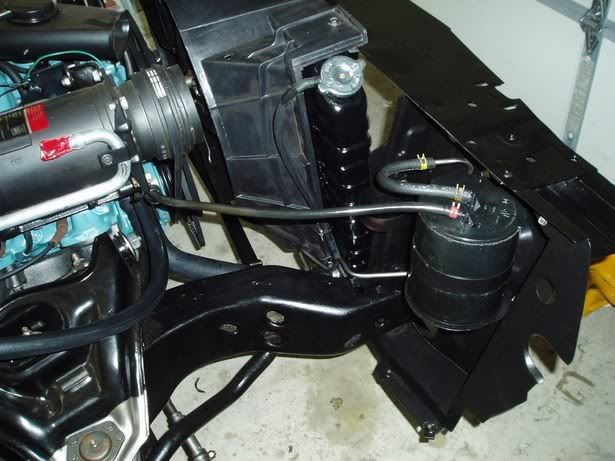

njsteve 03-13-2006 06:02 AM
Re: 72 T/A progess
Here's the new one back in the car. I reused the original hose clamps after cleaning them up a little. I went to the local pet store and bought two pounds of activated charcoal (for fish tank filter use) and poured that into the cannister and then capped it off with a new filter on the bottom. I then reinstalled it on the base and bolted it back up to the radiator support. It should actually work as intended now.
http://i20.photobucket.com/albums/b2...adinstall2.jpg

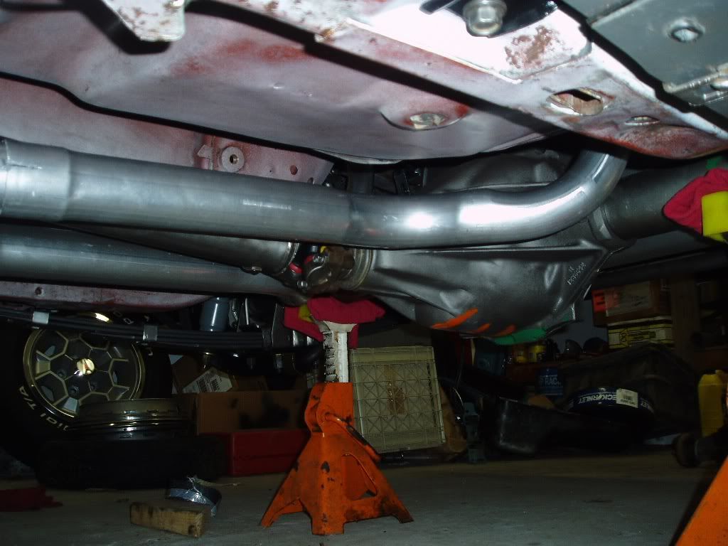

I've been working on my other project lately (1987 IROC Z) and have been collecting parts for the T/A. I recently received my Gardner exhaust system and trial fitted it this afternoon. Amazing quality stuff! It took longer to bolt up the hangers than it did to hang the entire system. Everything slid into place by hand. The only problem I ran into was trying to finagle the intermediate pipes under the car without the car being on a lift. I was like one of those twisted nail puzzlers that you see in novelty stores. There was only one way to move, twist and rotate the pipe(s) around to get them into place. But after using my brain and lifting the car as high as possible on the jack stands, they eventually fell into place. I highly recommend their products. I trial fitted (no clamps) everything so I can start the car with an exhaust in place. The engine hasn't been run in 6 months or so and now that I have the radiator, power steering and everything else hooked up I want to get it sorted out. I'll try to link some photos in the next day or so.
njsteve 05-26-2006 03:06 AM
Re: 72 T/A progess
Here are some photos of the Gardner exhaust trial fitted to the car. The pipes hung perfectly -no tools required.
http://i20.photobucket.com/albums/b216/nk15268/exh1.jpg
http://i20.photobucket.com/albums/b2...5268/exh2a.jpg
http://i20.photobucket.com/albums/b216/nk15268/exh3.jpg
http://i20.photobucket.com/albums/b216/nk15268/exh4.jpg
http://i20.photobucket.com/albums/b216/nk15268/exh5.jpg
http://i20.photobucket.com/albums/b216/nk15268/exh6.jpg

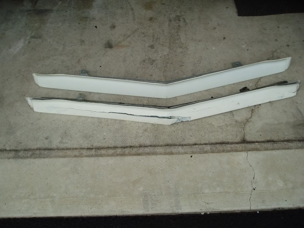

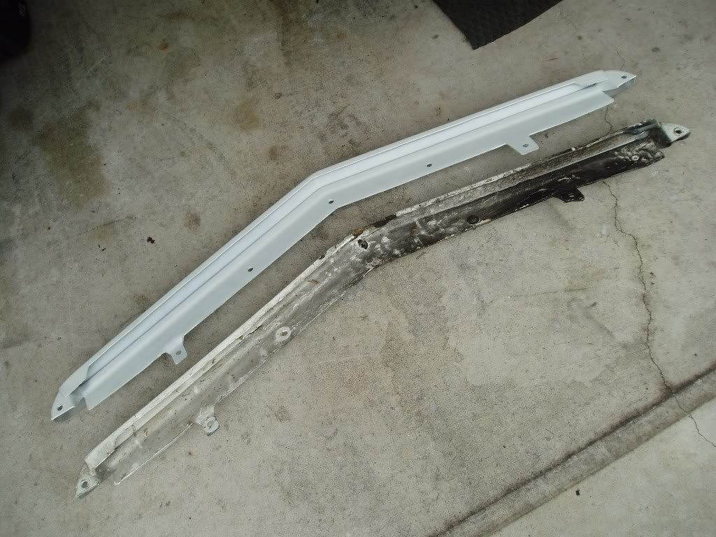

njsteve 05-26-2006 03:20 AM
Re: 72 T/A progess
Once in a while you actually find a bargain on ebay: I have been looking for an NOS front spoiler for the T/A. When you can locate one they run between $300 and $400 dollars. The reproductions are total garbage. This one was somewhat mis-described in its auction and I ended up getting it for $128! It is definitely an original NOS GM piece that came factory pre-painted in white. Here it is alongside my slightly used (smashed and burnt) original one:
http://i20.photobucket.com/albums/b2.../fspoiler3.jpg
http://i20.photobucket.com/albums/b2.../fspoiler4.jpg
