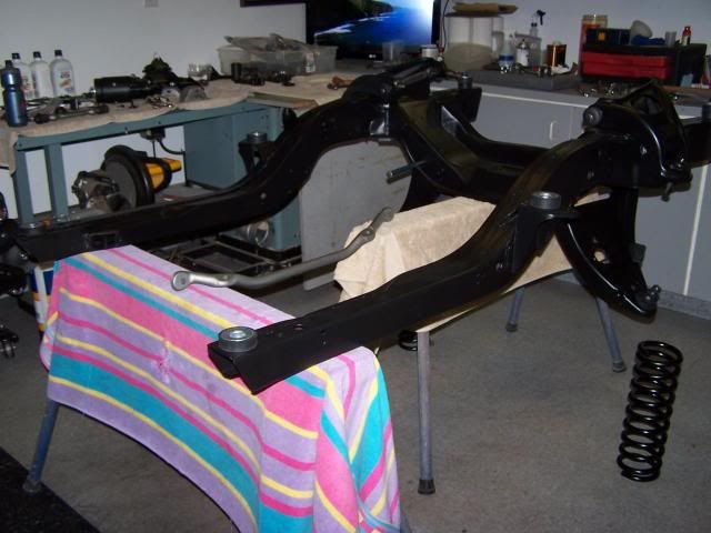

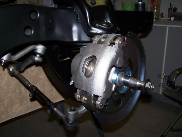

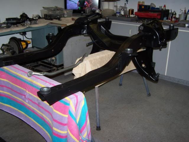

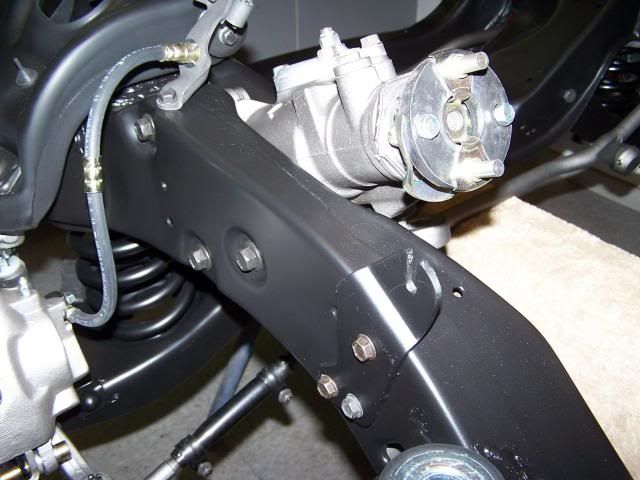

I haven't posted progress pis in a while. I got the frame out, it's blasted. I also have the body work on the frame done. I also have most of the front end parts painted. Still have to work on the control arms. Have to fix some minor pitting, then press all the bushings in. Here's some pics of the progress.
http://i533.photobucket.com/albums/e...ps234b0bf4.jpg
http://i533.photobucket.com/albums/e...ps002ce9d5.jpg
http://i533.photobucket.com/albums/e...ps4e5cbae7.jpg
http://i533.photobucket.com/albums/e...ps564e01f0.jpg
This is the original idler arm. Got all the paint off it, and detailed it. It's still tight.
http://i533.photobucket.com/albums/e...ps28895948.jpg
http://i533.photobucket.com/albums/e...psf1614dc9.jpg
http://i533.photobucket.com/albums/e...pscf757502.jpg

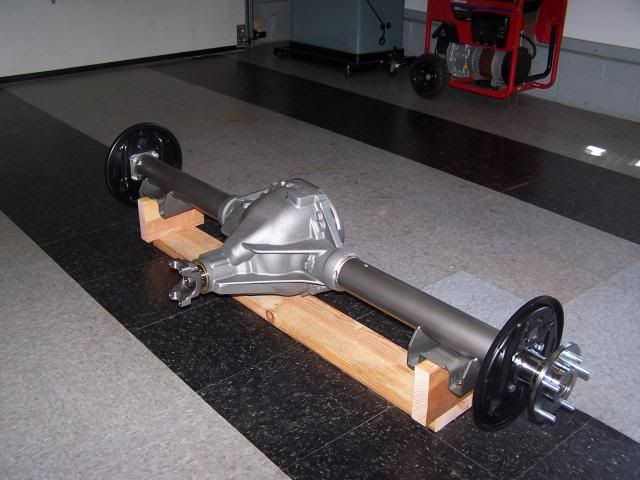

Tom had put new brakes on the Nova, so I used them on the new 12 bolt.
http://i533.photobucket.com/albums/e...ps0697496f.jpg
I also got the high build primer on the frame today. It should be ready for the top coat, after another sanding session.
http://i533.photobucket.com/albums/e...pse5c6c3ab.jpg

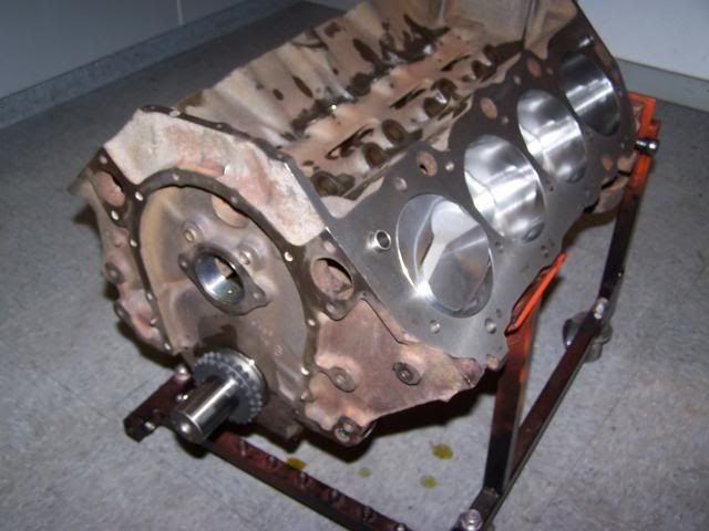

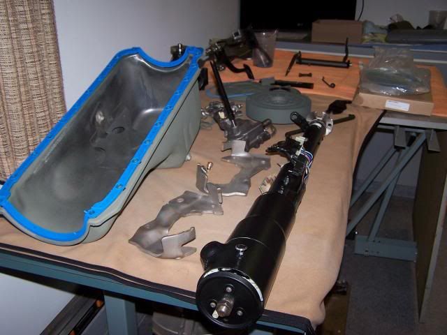

Bill Rose 05-30-2013 04:41 AM
Re: Project: Hot rodding a 69 Nova
Albert was able to paint his wheels because I was able to get my newly painted frame out of the booth, because it finally stopped raining.
Well, I'm on my way now. Lots of progress, and on to the &quot;funner&quot; stuff. Got the frame painted and started assembling it. I need some hardware for the assembly, that never got here after ordering it last week. I called and made a stink....it will be here tomorrow.
I'm gonna take a few days off and take the Elky to an AACA show this weekend, then back to business, finishing up the frame.
The rotisserie is also available now, so the body undercoating removal will begin next week. Here's some shots of the progress.
http://i533.photobucket.com/albums/e...psfcb05b5c.jpg
http://i533.photobucket.com/albums/e...psf3d0a05d.jpg
http://i533.photobucket.com/albums/e...ps82f58f62.jpg
http://i533.photobucket.com/albums/e...psd23595d4.jpg
http://i533.photobucket.com/albums/e...ps4049e696.jpg
http://i533.photobucket.com/albums/e...pse5879598.jpg

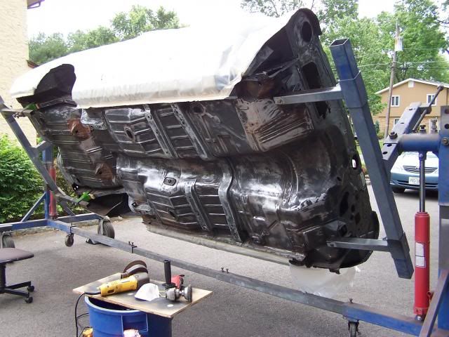

Bill Rose 06-07-2013 02:50 AM
Thanks for the positive feedback folks. I'll keep adding progress pics if anyone is interested.

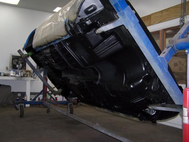

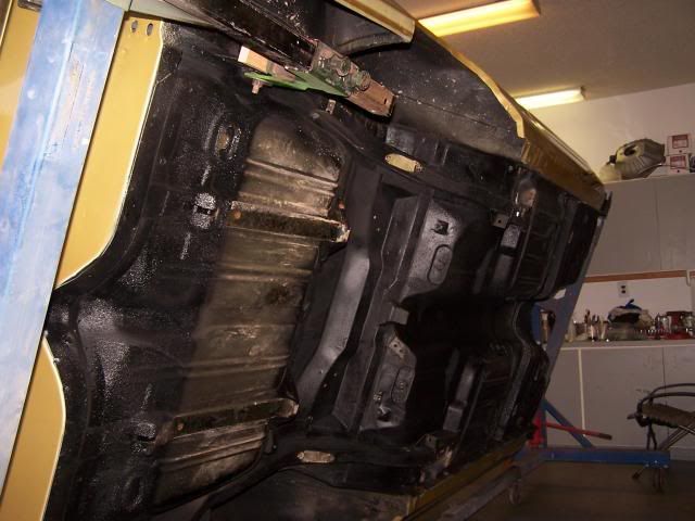

Lots of progress. I got the majority of the undercoating off. I still have some small areas to clean up a bit more. Mostly it was removed with fire and scraping. Then cleaned it up with a DA, and wire wheel on the grinder. Also used some paint remover in tight areas.
I'm very happy with the condition of the underbody. You never know what you'll find when removing undercoating, but this car was 99% rust free. Just a couple areas of surface rust, which I'll fix with some body work. Also got the firewall stripped. Found a couple numbers under the black paint. Also found big check mark. Not sure what that was for. Here's a few pics.
http://i533.photobucket.com/albums/e...psb59980cc.jpg
http://i533.photobucket.com/albums/e...psfdd068a7.jpg
I still have to remove, and redo the seam sealer.
http://i533.photobucket.com/albums/e...ps3c693272.jpg

Hi ,very nice work on the car so far.... I have a couple of questions. Did you replace the a arm bushings and then paint them? What did you coat your drag link with to protect it? Are the washers on the upper a-arms bare metal or painted black ?
Thanks Rob
Bill Rose 06-19-2013 01:48 AM
<div class="ubbcode-block"><div class="ubbcode-header">Originally Posted By: ban617</div><div class="ubbcode-body"> Hi ,very nice work on the car so far.... I have a couple of questions. Did you replace the a arm bushings and then paint them? What did you coat your drag link with to protect it? Are the washers on the upper a-arms bare metal or painted black ?
Thanks Rob </div></div>
I prime and paint one coat on the control arms, then install the bushings. Then I mask off the bushings and repaint the black. The drag link has cast iron paint on it. The upper a-arm bushings should be natural or nickel plated. I used a phos paint, but I'll change them before the project is finished.

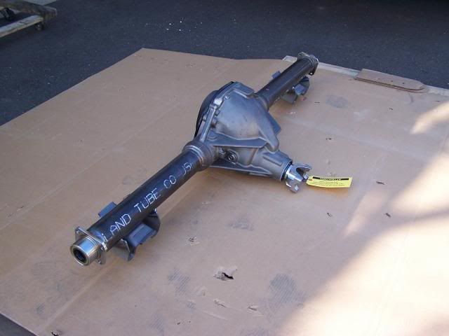

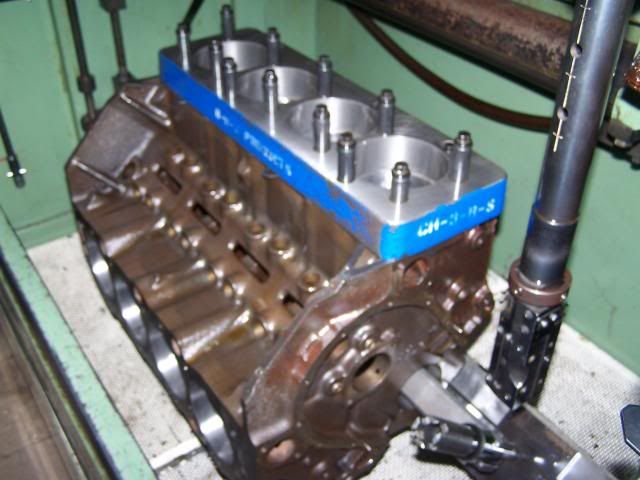

It's been a busy couple weeks. Got the rest of the bottom striped of all the undercoating. Then sanded it one last time. Then sand blasted the tight areas, that I couldn't reach with the sander..
Yesterday I stuck the whole thing in the trailer, and took it around the corner to Alberts shop, to prime, and paint the bottom in his spray booth. It came out great. Tomorrow it comes back here, and the Elky goes in the trailer for GM Carlisle. When I get back, I hope to start the assembly process.

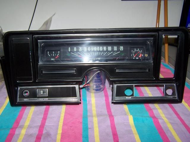

I also found a tack that fits the factory dash bezel. I got the dash all cleaned up, and reassembled/ready to go back in the car.
http://i533.photobucket.com/albums/e...ps0440ce7c.jpg
http://i533.photobucket.com/albums/e...ps2994dff7.jpg
http://i533.photobucket.com/albums/e...ps820dc4fa.jpg
http://i533.photobucket.com/albums/e...psd80401ab.jpg
