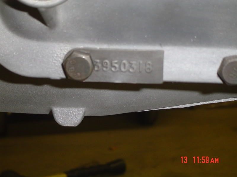

Re: MUNCIE METAL TAG ID
1969 M22 tag from Ed Ernsts COPO..BKH
http://i61.photobucket.com/albums/h5...h/DSC04299.jpg
