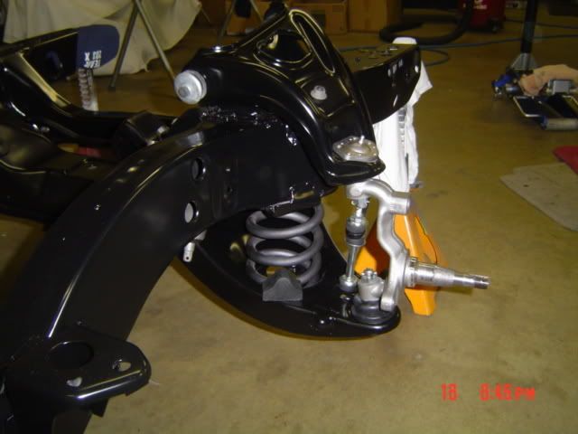

The best tool I know of is by OTC. It has two heavy plates that go between the coil. Then an all thread type center section uses a bearing and a heavy nut to compress the spring. I have never had a safer tool, and I have used many different types. They cost between 3 to 5 hundred dollars depending on vendor...BKH
http://i61.photobucket.com/albums/h5...h/DSC03991.jpg
http://i61.photobucket.com/albums/h5...h/DSC03989.jpg
http://i61.photobucket.com/albums/h5...h/DSC03990.jpg
http://i61.photobucket.com/albums/h5...h/DSC03996.jpg
