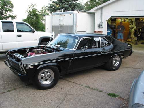

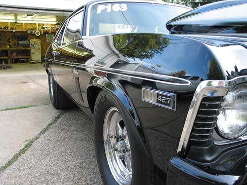

Thanks for the measurements, I will call my friend to let him know right now. He wasn't goin to get involved with this problem right now. But last week the pickup fell off the oil pump and cavatated and wiped the bearings out in the motor. So since its out might as well address the problem. We were thinking about putting a new front half in the car but he doesn't want to spend the money right now. It is ashame that he has this problem with the car. It is one of the nicest and straightest BLACK "racecars" I have seen.
http://i13.photobucket.com/albums/a2...2/IMG_0721.jpg http://i13.photobucket.com/albums/a2...2/IMG_0670.jpg
The car is also an oringal 396 4speed car.

A468BU 09-10-2005 12:44 AM
Re: Question about a 68 nova
Well its measures 35.5 inches like you say yours is. So maybe it has not moved and our eyes are playing tricks on us. We're goin to keep a close eye on it now.
