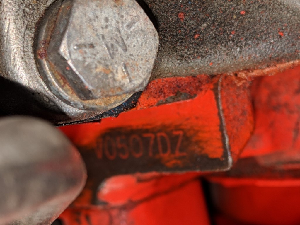

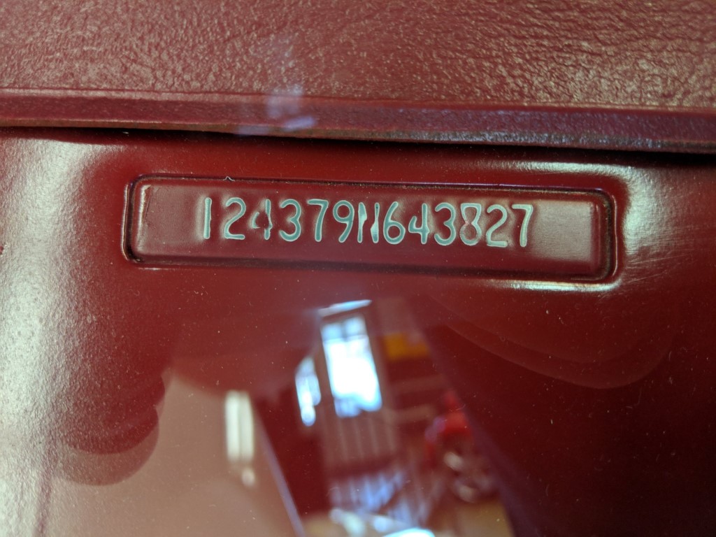

rlw68 01-31-2022 10:28 PM
2 Attachment(s)
Originally Posted by scuncio (Post 1580376)
Would be nice to see some pics of the engine and drivetrain stamps to back up the # claim. Odd to see a body color firewall and 'caution fan' sticker on what looks to be an otherwise stock appearing car....
Source
https://www.americanmusclecarz.com/v...let-camaro-z28
Attachment 212589
Attachment 212590
PeteLeathersac 02-01-2022 12:55 AM
All that plus actual VIN 643827 still different than 634827 POP.:hmmm:
