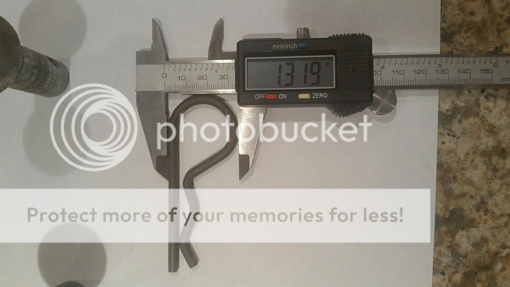

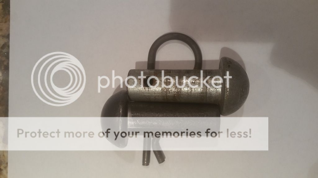

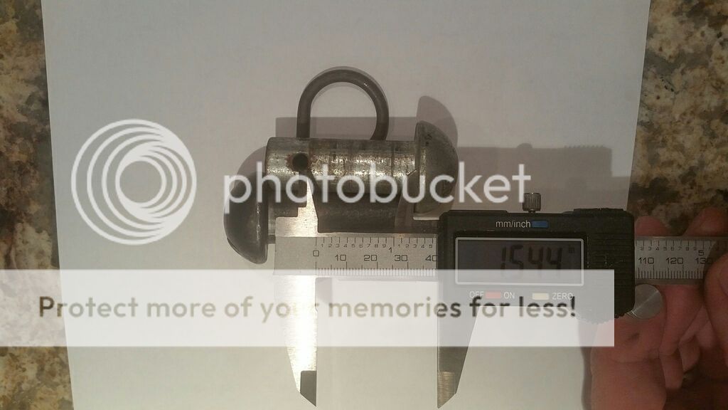

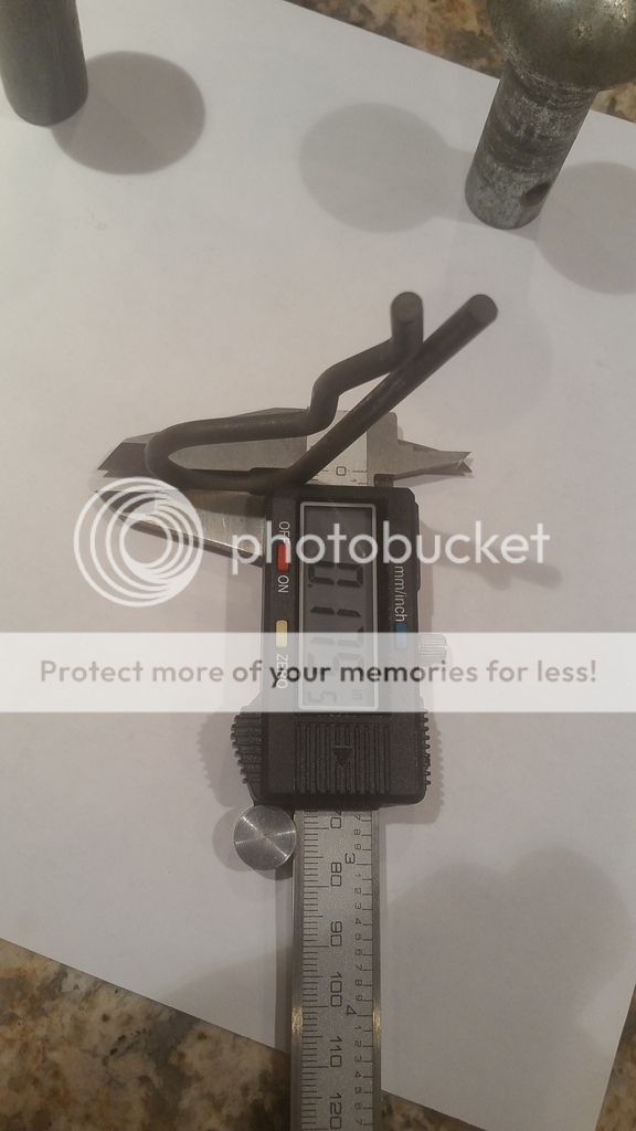

Hope this is enough, but ask if anything needs to be clarified.
Both pins are close enough to be considered the same length.
http://i710.photobucket.com/albums/w...psdga8fhh9.jpg

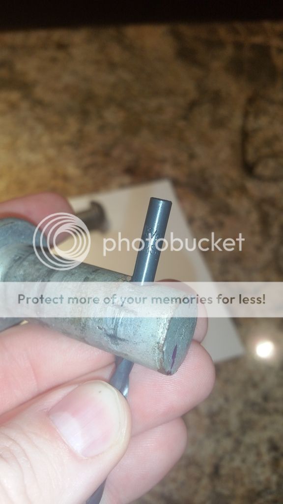

If you measure from flat side under the radius head, this should do a good place to locate the hole.
http://i710.photobucket.com/albums/w...psjpfn1xxx.jpg
You can use a 13/64 drill bit, then chamfer the hole.
http://i710.photobucket.com/albums/w...psuu7y4xpb.jpg
The pin is a little bigger than the cheapie at the flea markets.
http://i710.photobucket.com/albums/w...ps5tbijiee.jpg
The radius is also bigger.
http://i710.photobucket.com/albums/w...psodgzpbbf.jpg
