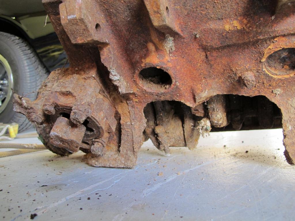

Tracker1 09-15-2016 12:58 PM
Re: Cracked Block - How bad is too bad?
This is a block I had from a '69 Dodge Daytona a few years back - I was given the name of Bob Himes to repair it. I sent him the pics and he told me &quot;No problem&quot;. I never did get it done as I sold the car later but he came highly recommended for cast iron welding - He was in Indiana - 317-831-8069

A12pilot 09-16-2016 06:45 AM
Awesome! That's good to hear. Thanks for the other lead!
