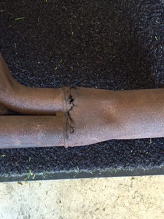

Reason for the switch...
https://www.yenko.net/ubbthreads/pics...27-blowout.jpg

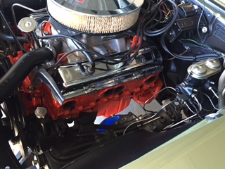

Drivers side..
https://www.yenko.net/ubbthreads/pics...ivers_side.jpg

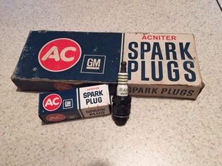

Fresh set of NOS R44 Acniters
https://www.yenko.net/ubbthreads/pics...9-acniters.jpg
