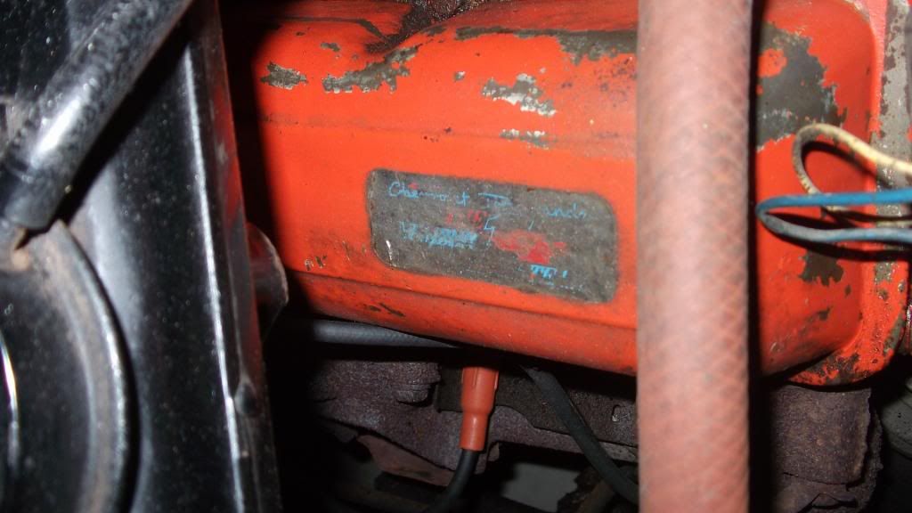

Here are some pics from an all original '69 Chevelle Concours station wagon. It has a 350 300hp. w/4speed...
https://www.yenko.net/ubbthreads/pics...3-dscn1522.jpg
https://www.yenko.net/ubbthreads/pics...4-dscn1527.jpg
https://www.yenko.net/ubbthreads/pics...5-dscn1528.jpg
https://www.yenko.net/ubbthreads/pics...6-dscn1529.jpg
