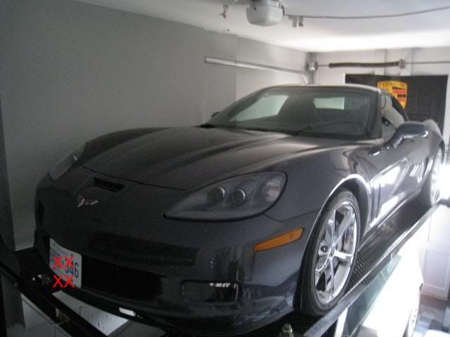

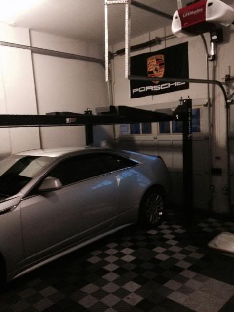

I have the Direct Lift and love it. My ceilings are 128 inches and I have the jackshaft opener. The lift I have is 58 inches clear underneath, so you'll need the next model up to clear your truck. I'll go out and take a quick pick and post in a minute...
http://i152.photobucket.com/albums/s...otos/lift2.jpg
http://i152.photobucket.com/albums/s...otos/lift1.jpg
http://i152.photobucket.com/albums/s..._photos/GS.jpg
