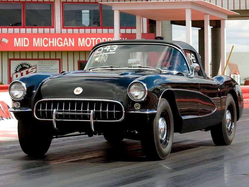

L78racer 09-20-2013 02:15 PM
Re: 62 Corvette Pure Stock Build
on my '57 i picked up a set of 15x6 impala/caprice wheels from '78 vintage. ran the '57 dog dish caps.
i used F70-15 redlines with the black side out.
you'll never get it hooked with the skinny tires. we tried it.
http://i24.photobucket.com/albums/c2...cStanton07.jpg

napa68 09-20-2013 04:12 PM
That 57 is pretty tough looking! I have a set of 15x7's that was on the car when my Dad had it. It's pretty good idea given the fact the rules allow it. IMO, the bias ply's look the best on these cars.

napa68 09-20-2013 04:44 PM
<div class="ubbcode-block"><div class="ubbcode-header">Originally Posted By: L78racer</div><div class="ubbcode-body">on my '57 i picked up a set of 15x6 impala/caprice wheels from '78 vintage. ran the '57 dog dish caps.
<object width="425" height="350"> <param name="movie" value="https://www.youtube.com/v/iMrErN9spig"></param> <param name="wmode" value="transparent"></param> <embed src="https://www.youtube.com/v/iMrErN9spig" type="application/x-shockwave-flash" wmode="transparent" width="425" height="350"> </embed></object> </div></div>
Is that &quot;just a 270hp&quot; car? That thing flies!
L78racer 09-20-2013 06:31 PM
yep, 270 hp. 4 spd. 4.10 axle.
i sold it 3 years ago. (owned it for 38 years)
running a '68 L78/L89 camaro now.
