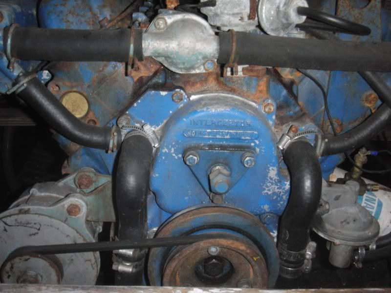

Verne_Frantz 12-22-2011 12:58 AM
Re: Identify this '63 Ford V8?
Upon further investigation, it seems it is actually in a '64 boat. The std motor was a 221cid 140hp Ford Interceptor. It has this number on the front <span style="text-decoration: underline">No. ER90R319043</span> but that may be unique to the marine version. Specs say 3.50 bore, 2.87 stroke.
Would '68 302 valve covers fit on this 221?? Sorry, but I know nothing about Fords....... (I never thought I'd have to apologize for that....) [img]<<GRAEMLIN_URL>>/rolleyes.gif[/img]
Verne [img]<<GRAEMLIN_URL>>/biggthumpup.gif[/img]
http://i83.photobucket.com/albums/j3...ontofmotor.jpg
John Brown 12-22-2011 03:40 AM
Ford small block W motors (221, 260, 289, 302 and 351W) take the same valve cover gaskets from 1962 thru 1987, so I'd bet the valve covers would fit also.
Sportyworty 12-22-2011 05:33 AM
The casting dates on the block and heads (under the valve covers) will be the answer. There will be one on the intake possibly but some marine manifolds did not. That timing cover is marine specific as well and also interchanges. Yes all of the Windsor family valve covers interchange. The 351 has its own intake and oil pan. There is also a stamped engine assembly date on the block to the right side of the timing cover. It is located on a pad just below the head. Many of these H/M boat engines were just garden variety engines. Some were solid lifter hipo 289's with Paxton blowers. I have bought a few Granatelli versions and the Paxton Gauges were worth more than the boat and the engine if not a solid lifter. Hipo. A pre 66 engine will also have a five bolt Bell as opposed to a six.
221 3.50x2.87 offered in 62
260 3.80x2.87 late 62-64
289 4.00x2.87 late 63-mid 68
302 4.00x3.00 mid 68-93
