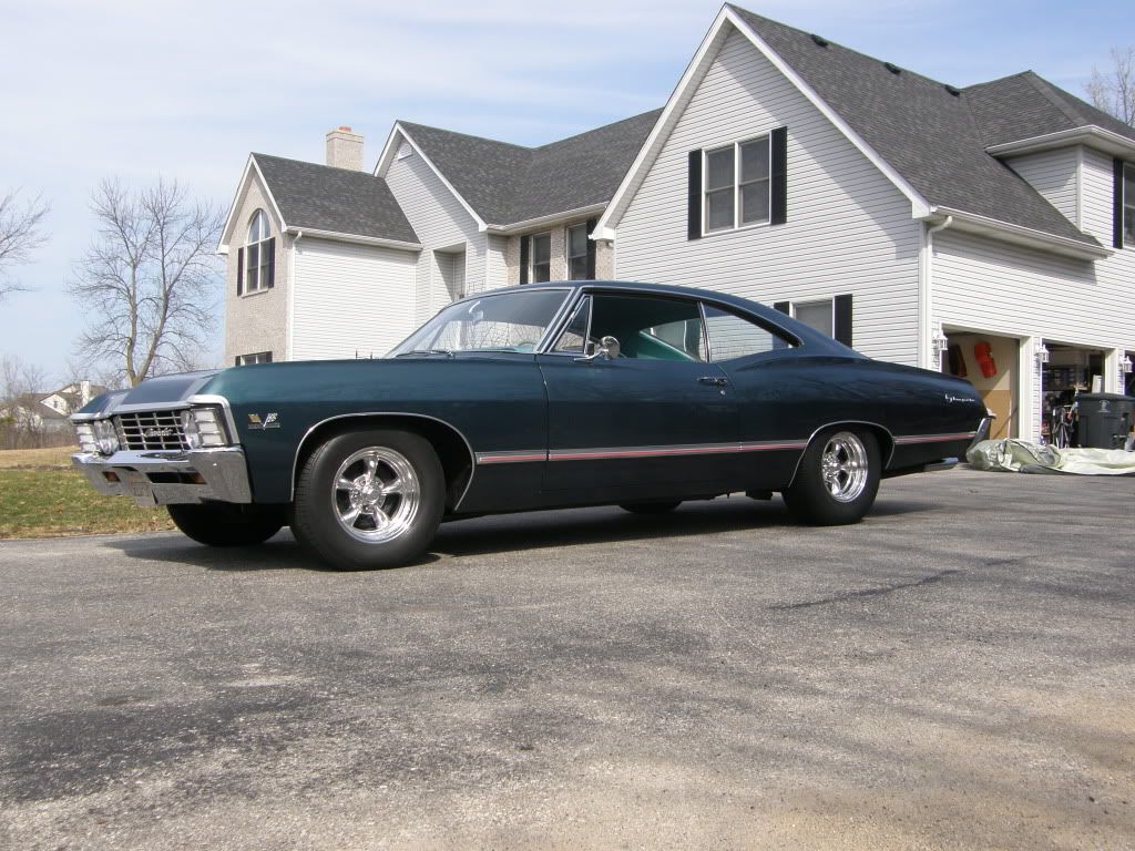

If that is a Nova then the radiator is completely wrong...also must have a shroud!! It appears to have a short water pump..is this a 68..?? the 68's had a fatory clutch fan with 5 blades. I also see a vacuum tube for the tranny...but, I don't see cooling lines..??

Looks like a 67 SS396 Impala and you are in fact missing the #3903958 fan shroud. Not a real easy item to come by.

Sorry, I thought I mentioned it is a 67 impala. Kwizz, psyco some others know the car. I didn't want to run a shroud if at all possible i'm trying to keep the factory look. The radiator has been recored since the photo.
http://i271.photobucket.com/albums/j...P4050124-1.jpg
I was trying to keep the car stock, it does have an aftermarket exhaust, it is the born with drivetrain. The assembly manual does not indicate a shroud, the radiator frame is not set up for a shroud. I was thinkig of running a clutch fan.Also I was almost thinking maybe running the colder stat (180)was allowing the coolant to run to fast, Ill try some of the suggestions
