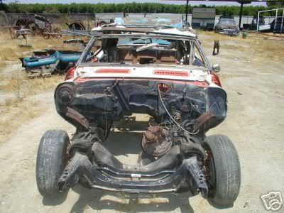

Did LA remove cowl panel to paint this area? I would say yes.
Bob
al8apex 07-24-2009 11:12 AM
Re: 1968 Z28 COWL COLOR
the cowl was painted before the cowl panel went on
SSRSBOB 07-24-2009 04:48 PM
That's what I thought, I have photos somewhere showing that.
Bob
al8apex 07-25-2009 05:34 AM
Here are some pics of some VN Z11's:
http://i8.photobucket.com/albums/a26...69pacecowl.jpg
http://i8.photobucket.com/albums/a26...carcowllos.jpg
http://i8.photobucket.com/albums/a26...arlosccowl.jpg
ALLZS 07-25-2009 05:54 PM
SO ON A BLACK STRIPE CAR THE COWL AND FIREWALL WILL ALL BLEND TOGETHER ?
firez 07-25-2009 06:09 PM
I wonder why some of these pics show the stripe colour all the way across the cowl and others as mine is were masked off and done like the one in Jerrys book on page 75. Mine was this way before restored,a tape line and then body colour beyond that out to the fender.
