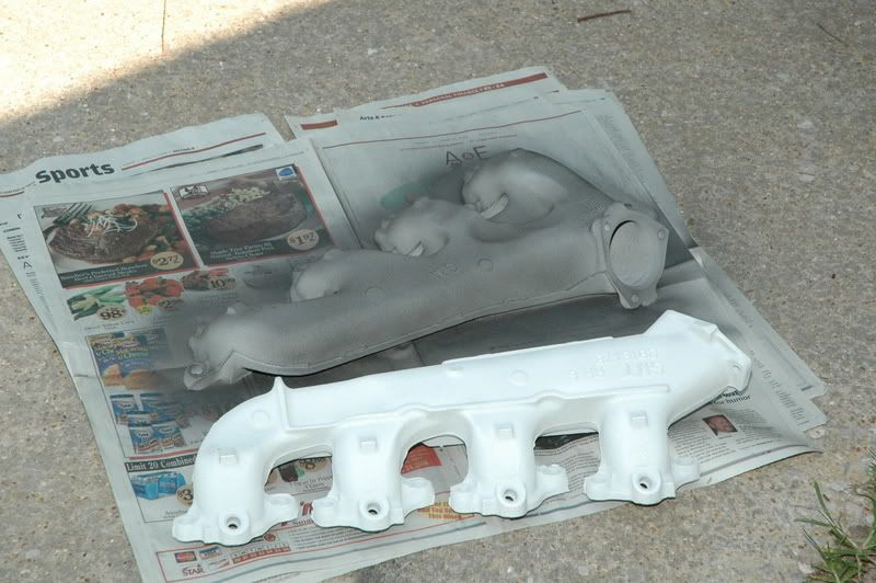

Chris396 11-09-2008 06:10 AM
Re: Painting Exhaust Manifolds
http://i23.photobucket.com/albums/b3...6/DSC_5527.jpg
I had a pair done by Jerry. Here's a before and after shot that I took when I sprayed them.

They will never rust because in MY opinion they have been "flame sprayed" with ALUMINUM giving them that whitish/silverish color.......The aeresol cast blast paint cosmetically covers the new "skin" and makes them appear more natural...............
