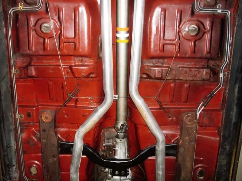

I took some underside photos while I had the car on the lift. You can see that we had the inspection cover off the bellhousing chasing that oil leak which looks more like a leaky oil galley or camshaft freeze plug since the oil seems to be coming from above the rear main seal. We put some leak detector dye in the oil a couple days ago and used the black light to find it. All it did was put a nice mist of dyed oil on the underside as part of the original Canadian self-rust proofing option.
http://i599.photobucket.com/albums/t...c/SDC11747.jpg
http://i599.photobucket.com/albums/t...c/SDC11748.jpg
http://i599.photobucket.com/albums/t...c/SDC11749.jpg
http://i599.photobucket.com/albums/t...c/SDC11750.jpg
http://i599.photobucket.com/albums/t...c/SDC11751.jpg
http://i599.photobucket.com/albums/t...c/SDC11752.jpg
