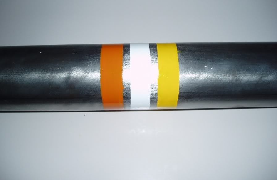

I spent a few hours chemically stripping the paint off of the driveshaft and then polishing it with the coarse wirebrush disc on my bench grinder. It worked very well. The finish matched the shiny areas under the stripes exactly. I then restriped it with one shot striping enamel and a brush. I let the paint dry overnight and then installed the U-joints and sprayed the whole assembly with the wax based Nyalac metal preservative. It works pretty well at keeping natural metal from rusting.

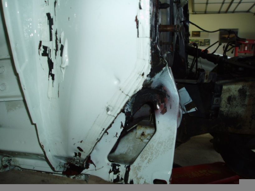

The one interesting thing I have noticed after the hours spent under this car, is that it appears that the factory undercoated the cars PRIOR to painting them. If you look at the wheelwell shots you can see the areas where the undercoating has chipped away: you see red primer and not white body color. (See the photo of the rear frame rail with the big red section where a large piece of stray undercoating fell off during the cleaning process)
So I guess if you are correctly restoring one of these 2nd generation F-body cars, the wheel wells should have body color overspray on top of the black undercoating (rather ugly in my opinion).

Maybe they changed the procedure by 1972 but from the photos there is no other logical explanation if you go layer by layer. Top layer is white, middle layer is undercoat and bottom layer is red oxide. If you chip off a piece of the oversprayed undercoating right next to a white section of metal, you only see red oxide. Here's a shot of the untouched front lower cowl area. You can see where the original paint has flaked away from the black undercoat/sealer from overzealous pressure washing (-my fault) On the rear frame rail the large red spot is where a large glob of undercoating fell off during the cleaning process, leaving only red oxide. If the car was painted white before undercoating, there should be white overspray under the undercoating and not over. (Now I'm sounding like a scene in the Movie Airplane: "Roger Over, Over Under, Under out") Do we have any former Norwood employees out there who can chime in???
http://i20.photobucket.com/albums/b2...8/a6d052e7.jpg
http://i20.photobucket.com/albums/b2...8/P1140002.jpg
