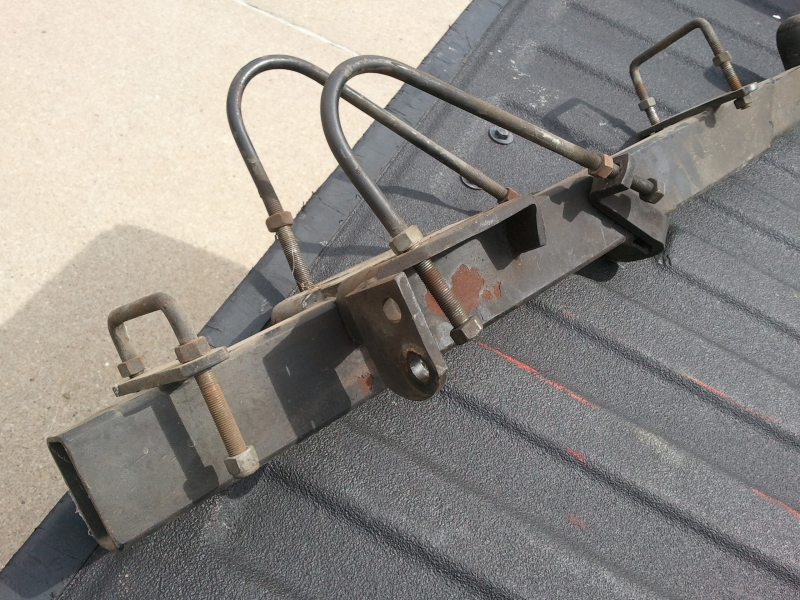

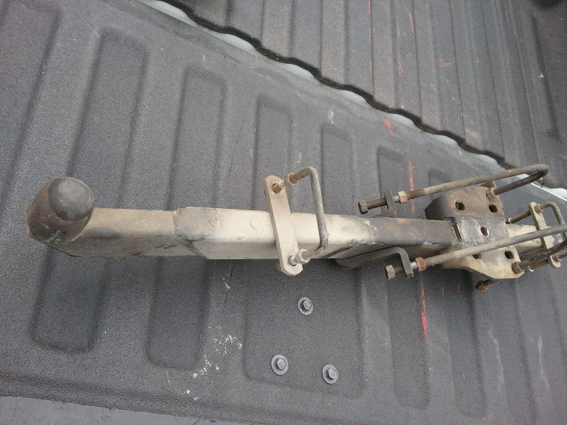

Anyone able to ID these?

chevyandpontiac 04-14-2013 02:40 AM
Re: Traction bars
Lakewood competition for Mopar part number 21300. The extension was an add on by some one

Thanks for the help. Are you sure on the application? They were supposed to be off a 71Nova. My cars buried & my sons (who's car they are for) is away for the winter. I had a feeling they were modified to reach the spring eye & that's ok. Now I'm hoping they will fit his car.
whitetop 04-14-2013 12:08 PM
Re: Traction bars
Yep, Duster/Demon A-body--you can tell by the shock absorber bracket

This is a little upsetting. Seller said he removed them from his 71 Nova to put Cal Tracs on.

<div class="ubbcode-block"><div class="ubbcode-header">Originally Posted By: notstock71</div><div class="ubbcode-body">This is a little upsetting. Seller said he removed them from his 71 Nova to put Cal Tracs on.
Thanks for the help. </div></div>
They will work on your Nova..the spring pad perch are basically universal and those bolt holes are grooved out for several different u-bolt diameters.

Thanks for making what appeared to be a bad situation a good one. Now I'm torn, do I cut the extension off to make them as they were or do I leave them as is since they are supposed to hit right at the spring eye. Opinions on color?
