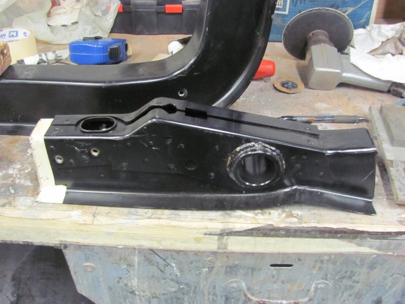

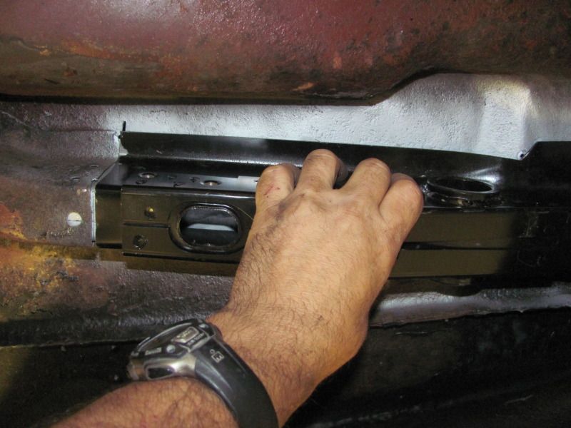

Here's some updated photos on the frame rail repair and trial fitting of the replacement outer section on the passenger front of the rear rail.
http://i599.photobucket.com/albums/t...8c/s72f007.jpg
http://i599.photobucket.com/albums/t...8c/s72f010.jpg
http://i599.photobucket.com/albums/t...8c/s72f011.jpg
http://i599.photobucket.com/albums/t...8c/s72f012.jpg

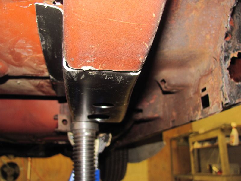

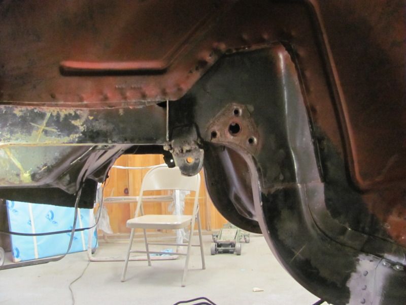

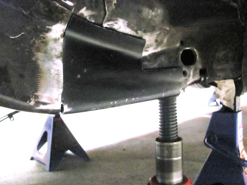

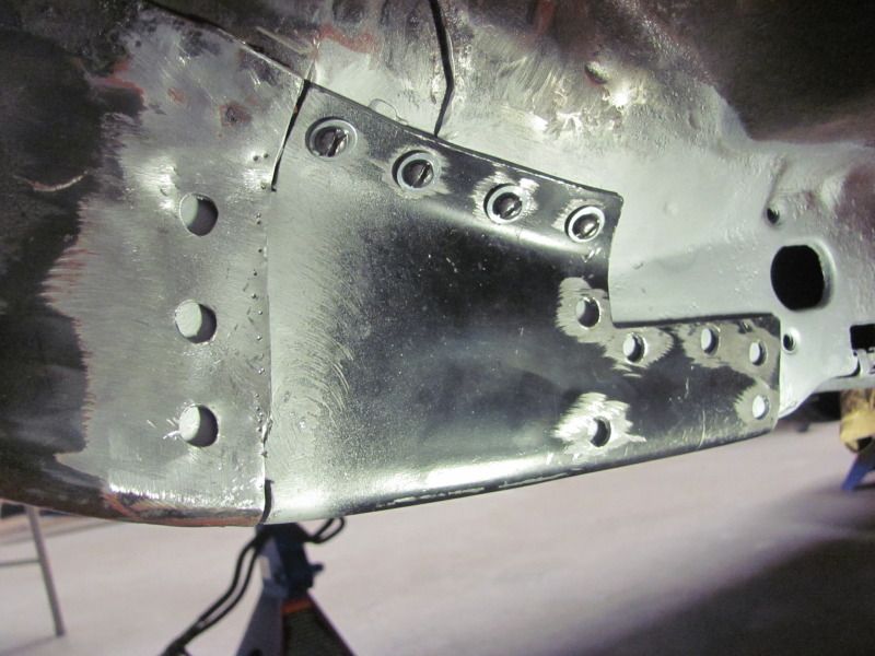

Frame progress.
Front replacement section held in place for trial fit prior to welding:
http://i599.photobucket.com/albums/t...8c/s72f032.jpg

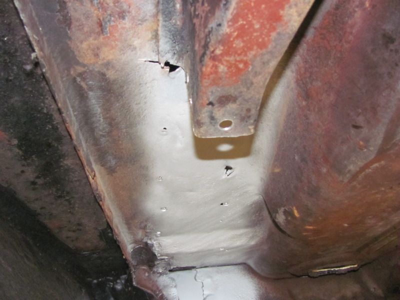

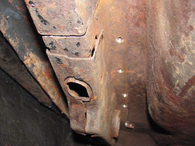

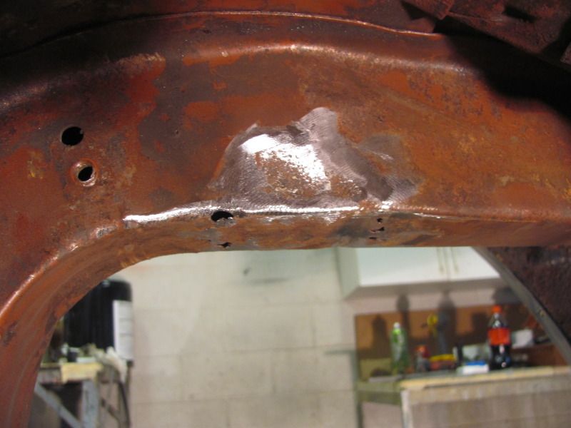

Sway bar hanger removed. Showing the burned through spots from unsuccessful attempts at stick welding the broken mounts back in the 1970s.
http://i599.photobucket.com/albums/t...68c/s72036.jpg
http://i599.photobucket.com/albums/t...68c/s72051.jpg

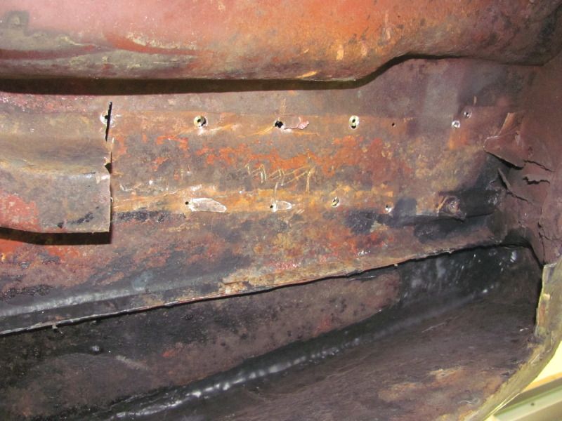

The bad section of rear rail getting trimmed for removal. The trunk floor was actually rather nice above the rail.
http://i599.photobucket.com/albums/t...8c/s72f041.jpg
http://i599.photobucket.com/albums/t...8c/s72f046.jpg
http://i599.photobucket.com/albums/t...68c/s72012.jpg

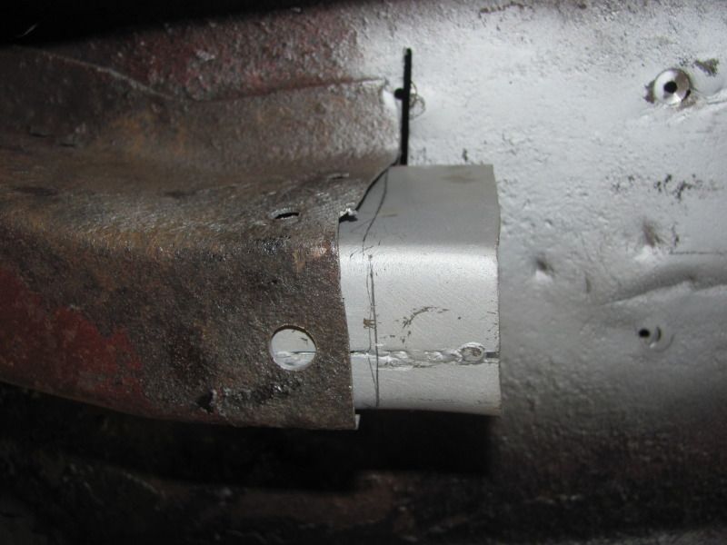

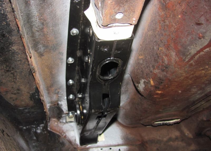

Inner brace being fitted in place:
http://i599.photobucket.com/albums/t...68c/s72016.jpg
njsteve 07-19-2012 02:41 AM
Re: The New Project: Part Deux!

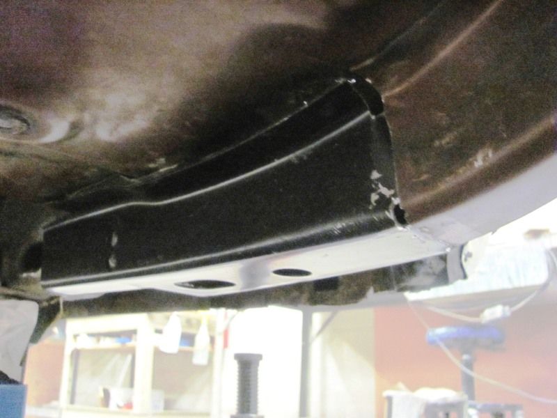

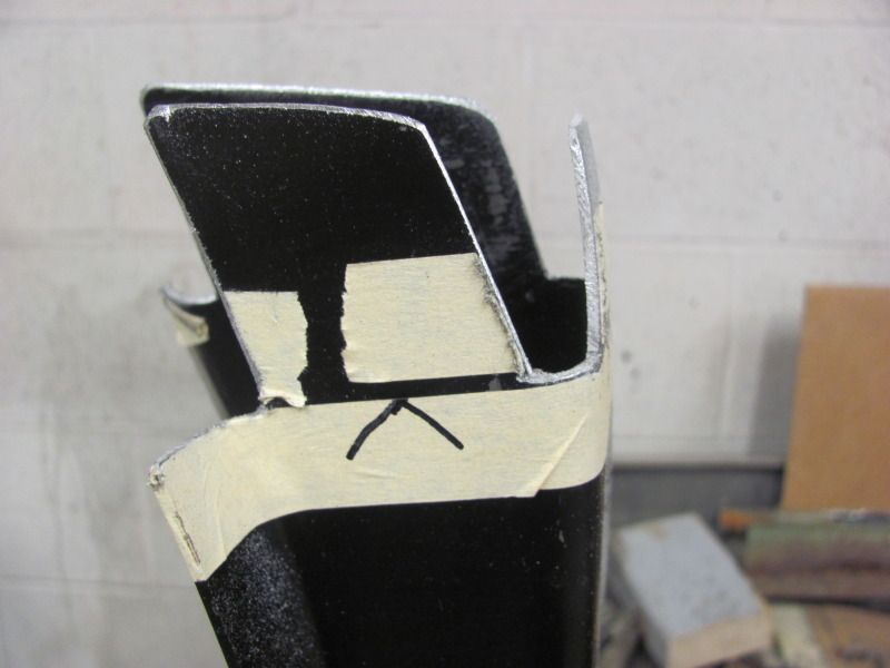

The replacement section trimmed and fitted:
http://i599.photobucket.com/albums/t...68c/s72001.jpg
http://i599.photobucket.com/albums/t...68c/s72017.jpg
http://i599.photobucket.com/albums/t...8c/s72019a.jpg
