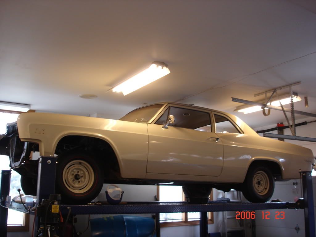

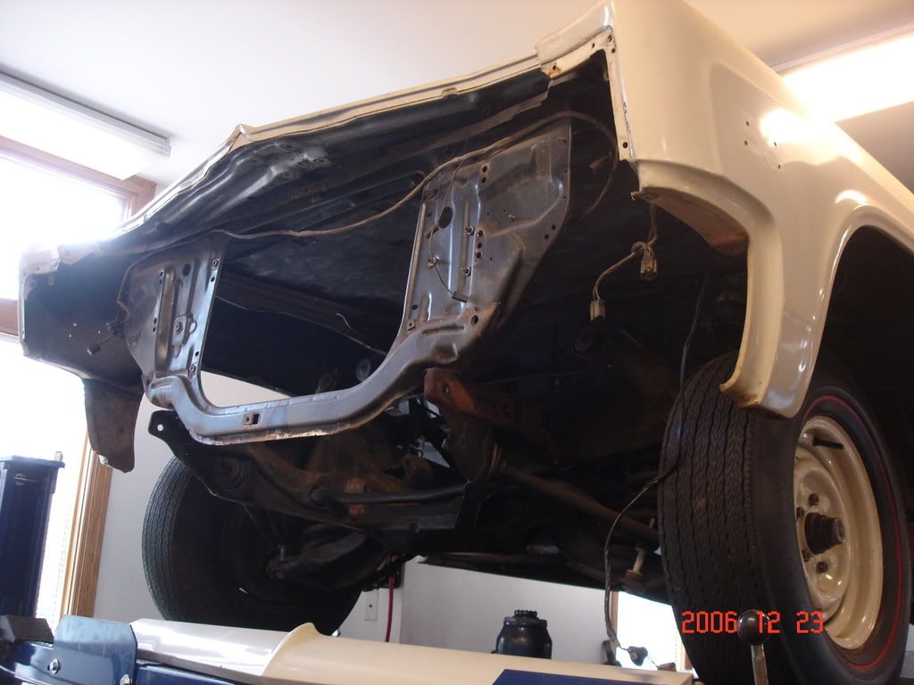

The Floor Pan is just about done.....that Red Clay is a Pain to wire brush out of all the nooks and crannies....Scotch Brite tomorrow and give it a light coat of chassis black, when it gets back from the body shop I'll give it the final detailing........
