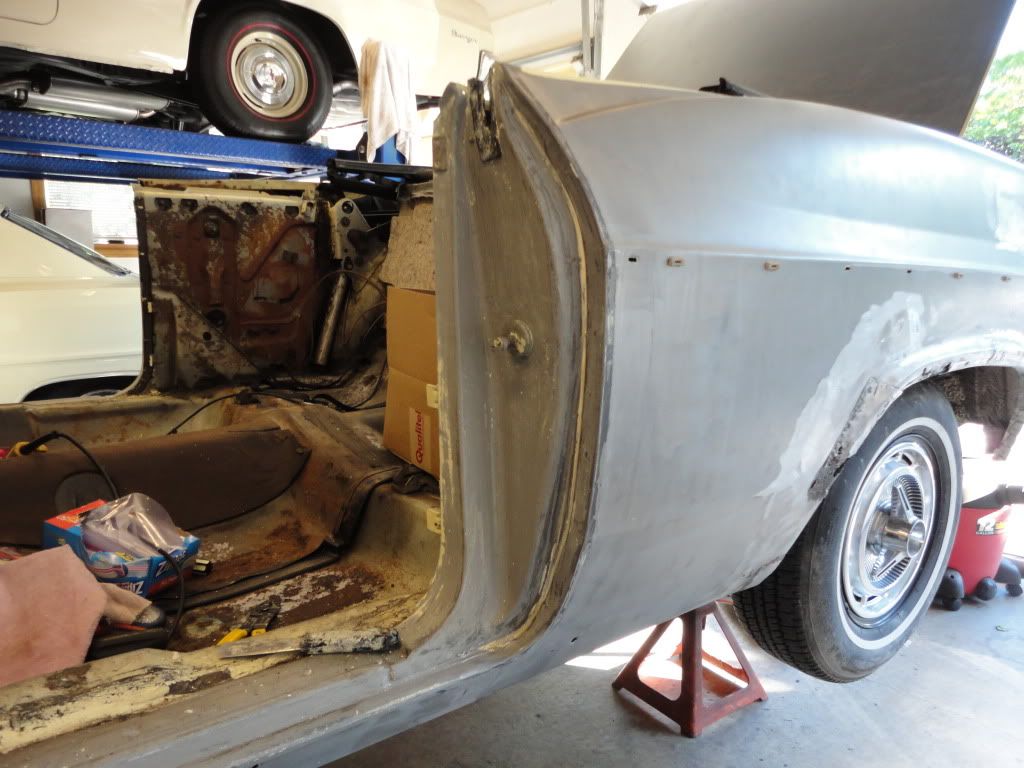

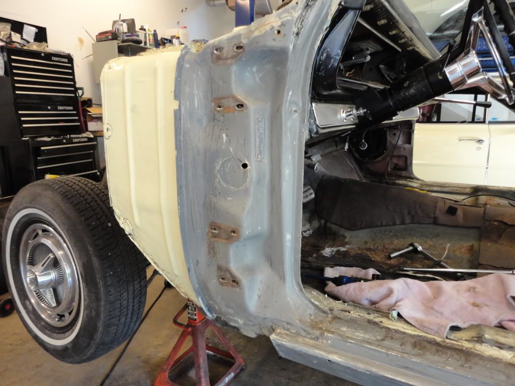

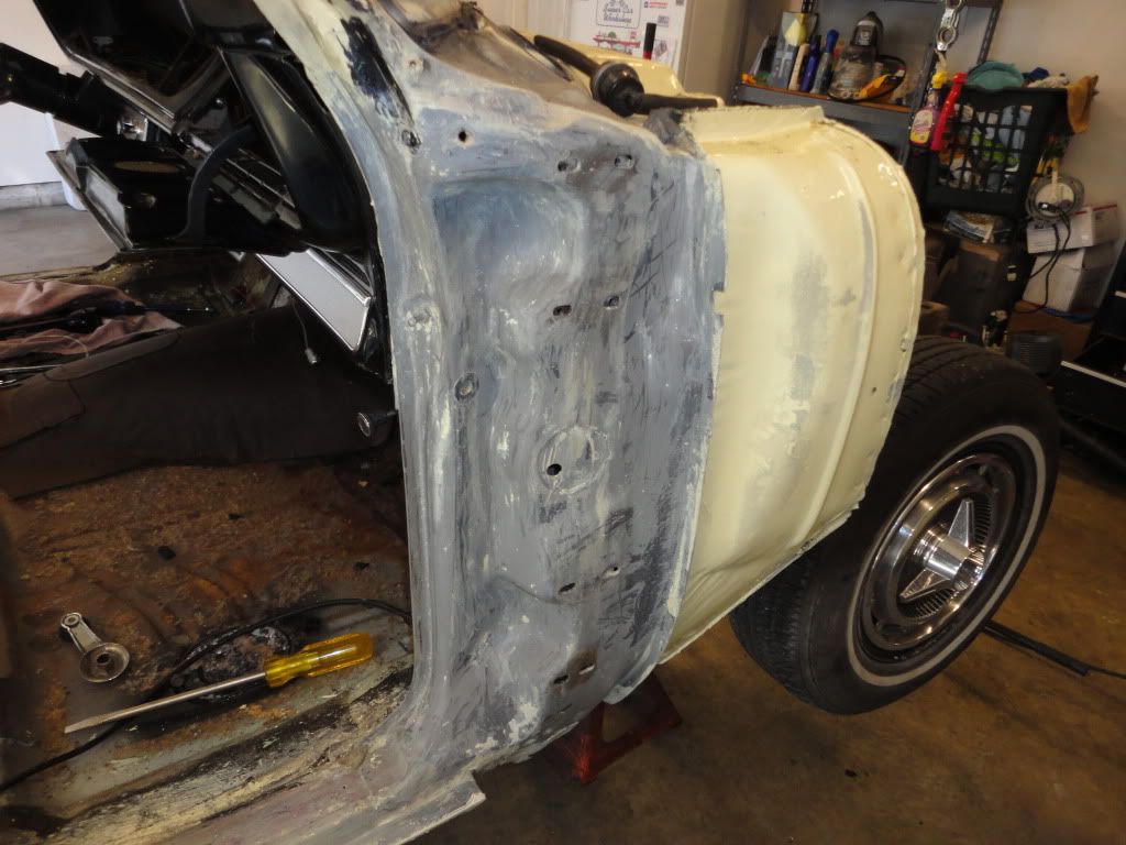

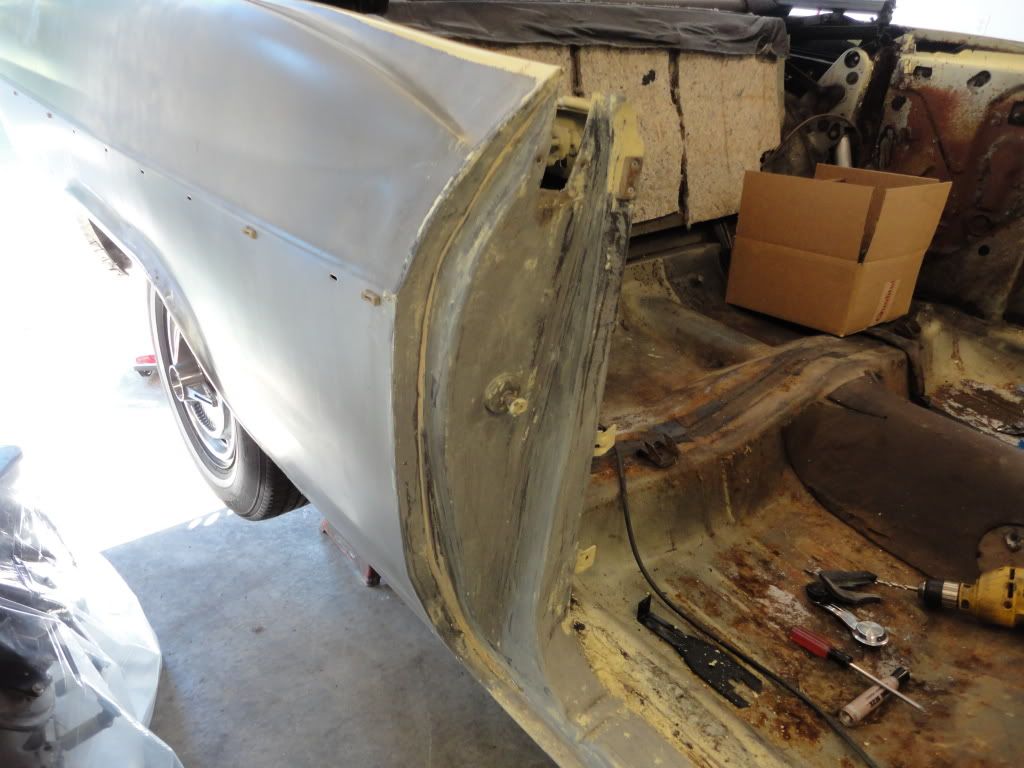

While waiting for the car to get into Pulera's, I decided to get spme paint stripper and continue on.....Got the door jamb areas paint free......No Rust...
http://i13.photobucket.com/albums/a2...t/DSC04220.jpg
http://i13.photobucket.com/albums/a2...t/DSC04221.jpg
http://i13.photobucket.com/albums/a2...t/DSC04223.jpg
http://i13.photobucket.com/albums/a2...t/DSC04224.jpg

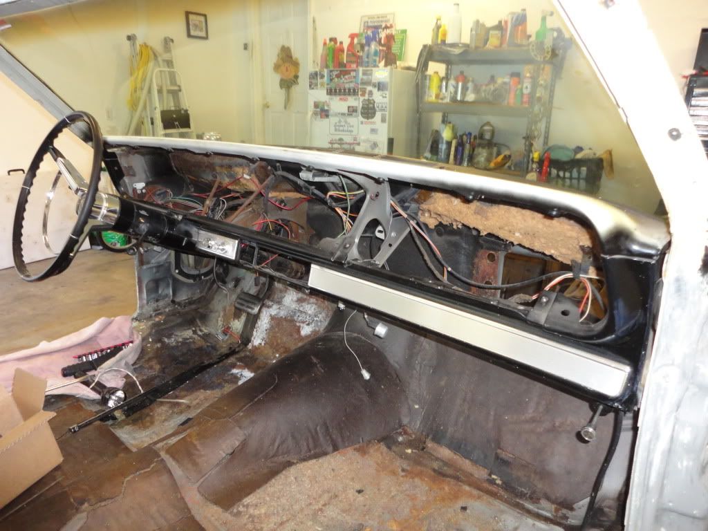

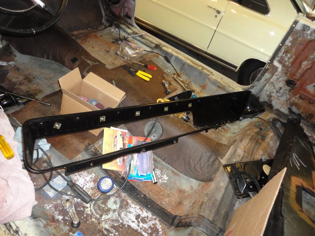

Also got more of the dash taken apart.....

I ordered a new set of Body mounts and want to change them before the car go's to Pulera's......Started loosening the old bolts but needed to soak them in some penetrating oil....so in the mean time I pulled the fuel tank down.....bottom of the trunk floor looked pretty good....
http://i13.photobucket.com/albums/a2...t/DSC04233.jpg
http://i13.photobucket.com/albums/a2...t/DSC04234.jpg
Then I continued with the paint stripper around the trunk are......Boring!!
http://i13.photobucket.com/albums/a2...t/DSC04230.jpg
http://i13.photobucket.com/albums/a2...t/DSC04232.jpg

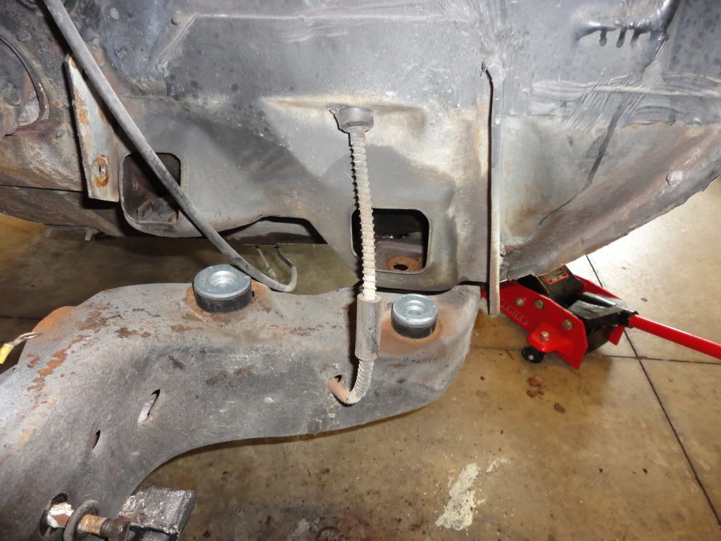

Changing the Body mounts.........Its like should I let the sleeping Dog lie......or should I kick it......LOL....I decided to Kick it and I'm glad I did........I started by removing the front ones first and they were rusted away so bad they just snapped off......
http://i13.photobucket.com/albums/a2...t/DSC04235.jpg
http://i13.photobucket.com/albums/a2...t/DSC04237.jpg
Did one side at a time with some wood and a jack....
