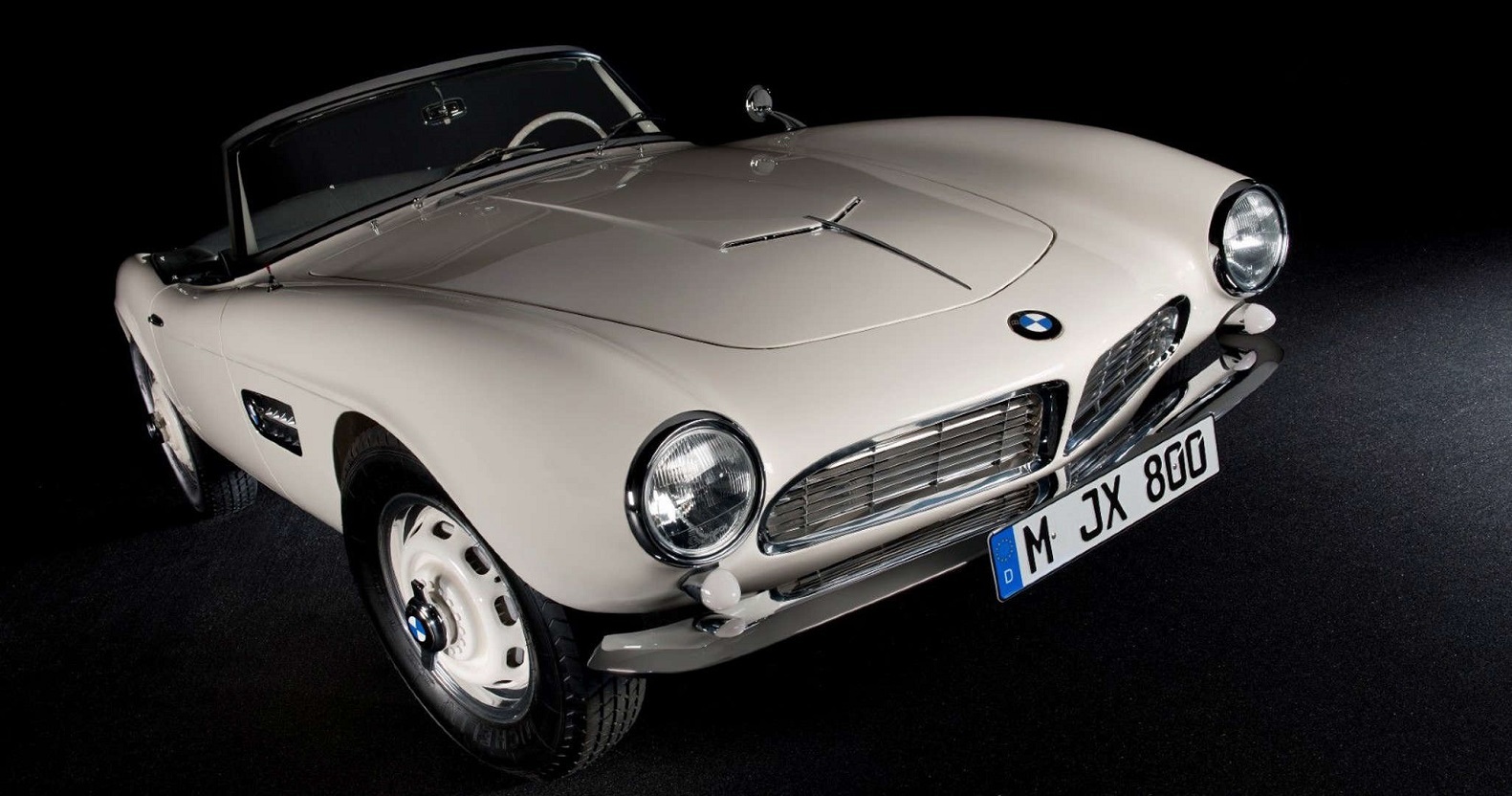

A12pilot 01-21-2023 11:42 PM
2 Attachment(s)
Chassis #70110 delivered new to Venezuela. :biggthumpup:
Attachment 232686
Attachment 232687
The driver door is done with functioning locks, handles, window regulator, and the inner panel will be removable for servicing.:biggthumpup: Window regulator; Toyota pickup. Latch mechanism; Jaguar XKE. Exterior handle; Chrysler Windsor. Door shell; SuperDave!!!:tongue:
More to come…
Cheers
Dave
