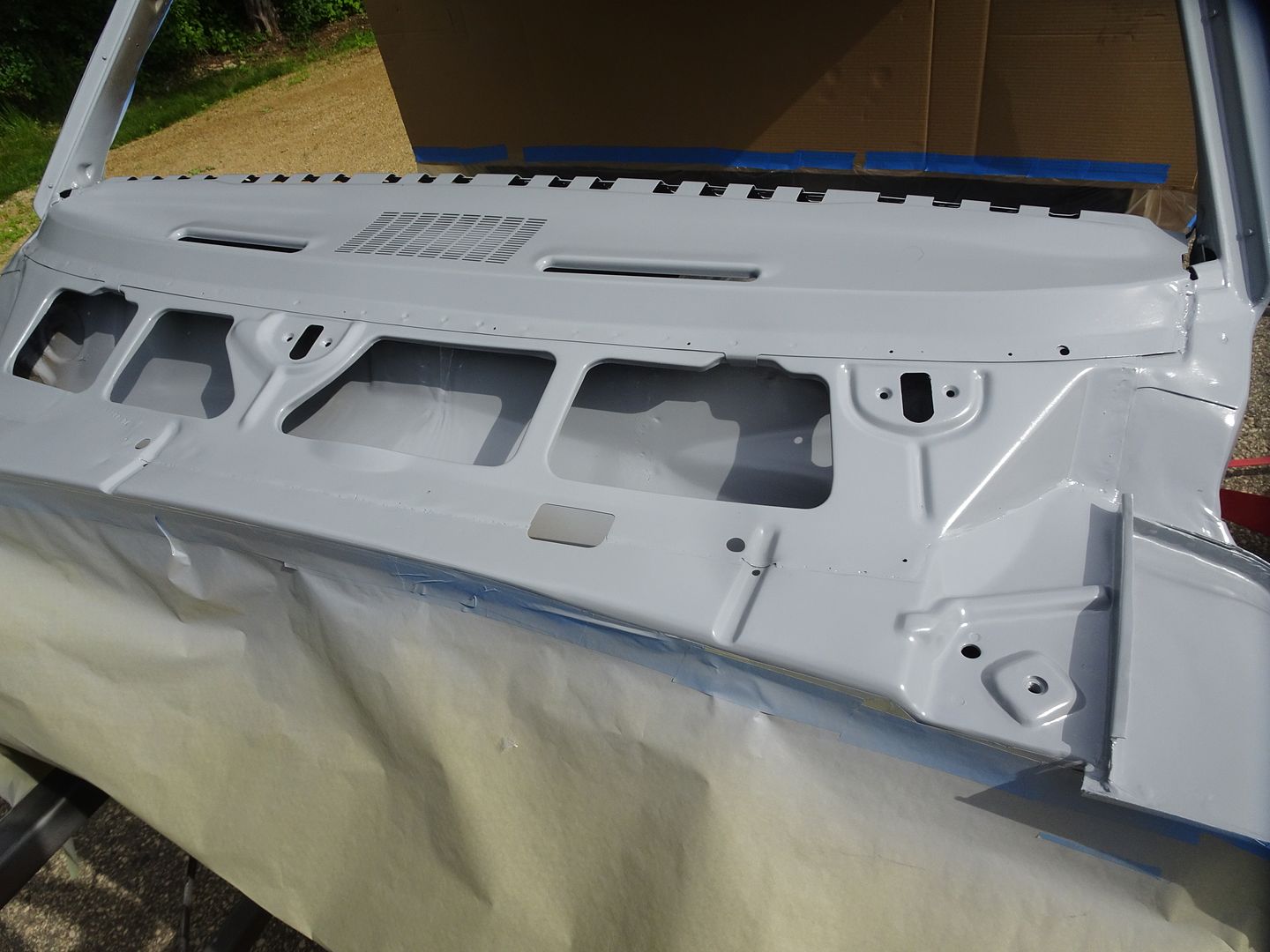

We have had a VERY rainy Spring/Summer so far and I finally got the car outside 2 days ago, to get epoxy sealer/primer on the raw dash/instrument panel. Had a few peeks of sun thru the clouds and it was windier than I would have liked, but ya gotta get stuff done when ya can....
Now to get all the seams sealed up.

Looking great. How did you weld the dash panel at the base of the windshield - were those plug welds or spot welds?
Too Many Projects 06-21-2024 06:59 PM
Most of it I did with the spot welder, you can see the dimples. The left wiper transmission mount prevented me from getting beyond it and there are about 8 plug welds on that side and I think 3-4 on the far right as well.
