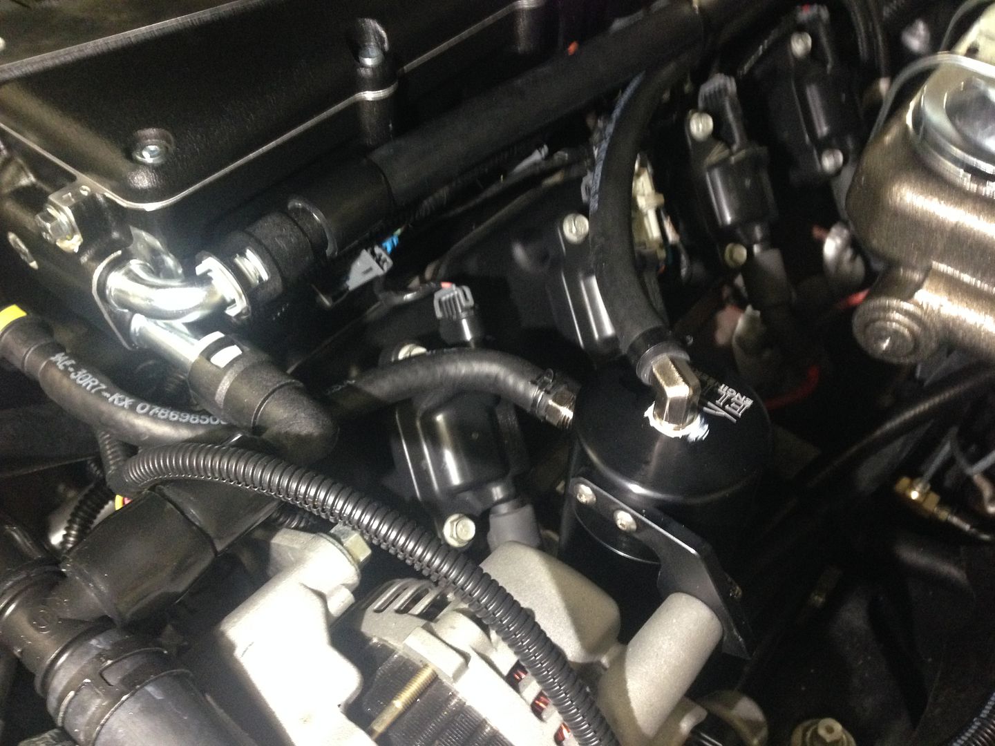

Another detail that popped up and after thinking about it........According to the Edelbrock instructions the PCV system takes air from the inlet Tube (after the MAF sensor and before the Throttle Body) and the hose go's to the passenger valve cover, then it comes out of the drivers side valve cover right into a vacuum port just behind the throttle body....So....I called them and asked if there should be some sort of a PCV valve or something in the system.......they said no........Humm....that didn't make any sense to me as that would be the same as just leaving the hose off and having a dead open vacuum leak...So.....I stop at Frame-up wheelworks and talk to Donnie about my concerns......He agreed and told me the norm was to have a restrictor in the line with a .105 dia hole in it.......this will allow the PCV system to function in a restrained condition.........so.....I made one up and put it in the line and he also recommended putting a Catch can in the line between the throttle body and the valve cover.........Her are the final pic's before being Dyno-Tuned........
Restrictor fitting in the PCV line
http://i13.photobucket.com/albums/a2...BF204F52A4.jpg
Catch can.........
http://i13.photobucket.com/albums/a2...917977A0B8.jpg

resto4u 11-19-2015 12:49 AM
Re: Next Years Power Tour Car
ken, did you just make a restrictor on the lathe from aluminium solid round stock?
kwhizz 11-19-2015 12:16 PM
<div class="ubbcode-block"><div class="ubbcode-header">Originally Posted By: resto4u</div><div class="ubbcode-body">ken, did you just make a restrictor on the lathe from aluminium solid round stock? </div></div>
Yep.......Took some 5/8&quot; bar stock and turned both ends down with Barbed profile and drilled a 1/4 hole from both ends and drilled thru with the .105 drill.................
Ken
