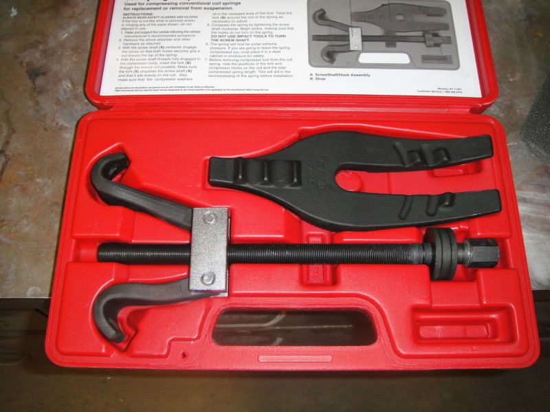

I got the springs installed over the weekend. I took Greg Roberts advice from Nova Research and used the spring compressor through the shock hole. What I did was put this internal spring compressor bolt down through the shock hole. Then I put the spring into the pocket inserted the hooks and tightened the spring into the spring pocket. It worked out great. Just a little touch up nothing major. Thanks again Greg.

Real Nice Jason. Who makes that tool?

Rick OEM makes it. This is the link to Amazon. Very nice quality. The last internal spring compressor I bought was junk after 1 use.
http://www.amazon.com/27035-Internal-Coi...8372&sr=8-1

----Yup,,,Thats the one! I have been using mine for the better part of 20 years.....Bill S
