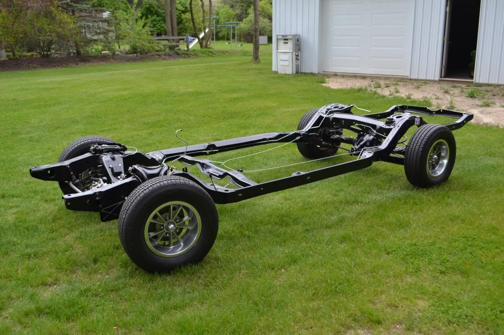

So far powder coat is beyond your budget correct? A arms, rear end housings, and suspension pieces dont need to be powder coated. You can source really nice pit free pieces from out west and paint them to look like brand new for less than powder coating your original pieces. Nothing on my frame is powder coated except for the core support. Everything was blasted, filled, epoxy'ed and painted.
http://img.photobucket.com/albums/v3...ps4eb3da92.jpg
Powder coat your frame if its a must, but the other stuff doesnt need it.

Your frame looks really nice!!!

Obviously it's Ryan's choice, but I would agree that powder coating can leave much to be desired over a good quality gun-sprayed paint. I would say painting is even more advantageous on a Midwest car with rust pitting on the undercarriage...because it can be filled and sanded smooth.

So apparently we cant offer any tips other than &quot;nice job&quot; and &quot;looks good&quot;. Scuncio said what I said weeks ago about powder and pitting.
Powder coating his frame is the wrong idea and will not turn out like he wants it to. He has his springs in the blast powder pile. No idea if he plans on coating them but that is a bad idea too. New springs are relatively cheap. Eaton says this about powdercoating them...
<span style="font-weight: bold">In order to get the paint particles hot enough to bond they must be heated very close to the annealing temperature of the spring steel. Annealing means the heat treatment of the springs is being removed. Annealed springs will no longer support any weight.</span>
