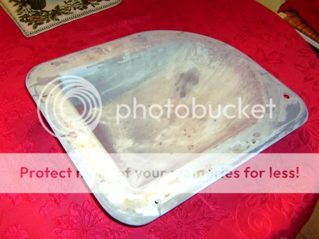

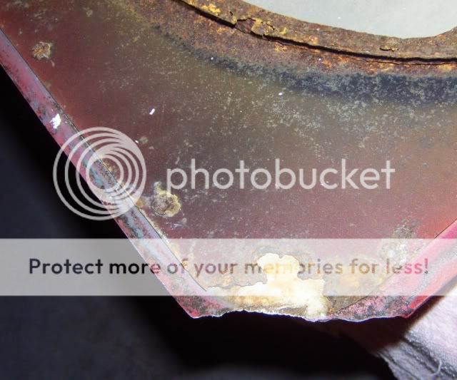

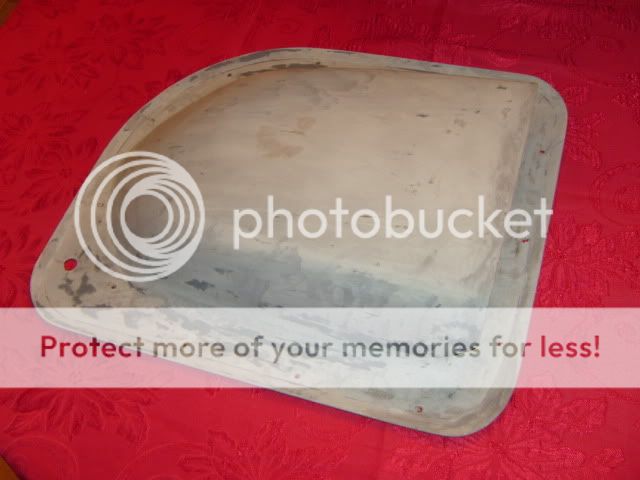

Once all the underside repairs were done, I grooved out the corresponding areas on the top side and applied more fiberglass filler to repair the remnants of the stress cracks on top.
Here is the semifinished shaker dome after all the fiberglass repairs were done. Still needs some primer, redrilling of the rivet holes to the correct size, and epoxying of the door assembly into the opening, before the metal base plate can be riveted back on.
http://i466.photobucket.com/albums/r...b/S7006159.jpg
http://i466.photobucket.com/albums/r...b/S7006158.jpg
And the underside:
http://i466.photobucket.com/albums/r...b/S7006160.jpg
The before and after of the reconstructed missing edge:
http://i466.photobucket.com/albums/r.../S7006093b.jpg
http://i466.photobucket.com/albums/r...b/S7006161.jpg

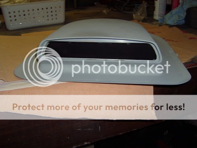

Primed the shaker today and epoxied in the flapper door. More sanding on the schedule for tomorrow.
http://i466.photobucket.com/albums/r...b/S7006179.jpg
http://i466.photobucket.com/albums/r...b/S7006175.jpg
http://i466.photobucket.com/albums/r...b/S7006177.jpg
http://i466.photobucket.com/albums/r...b/S7006176.jpg

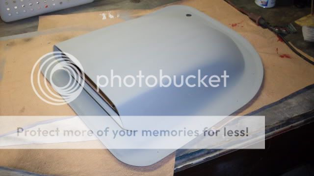

Almost done! Got the final layer of primer on and the detail work on the seam where the trap door mounts.
http://i466.photobucket.com/albums/r...b/SDC10026.jpg
http://i466.photobucket.com/albums/r...b/SDC10024.jpg
http://i466.photobucket.com/albums/r...b/SDC10029.jpg

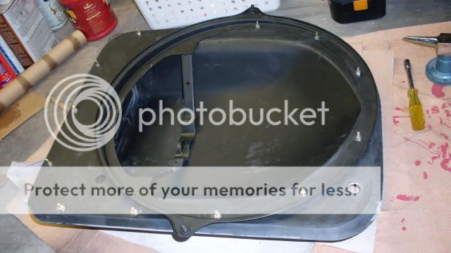

I did the preliminary mounting of the base plate ring. I carefully drilled the holes in sets of two at a time, and then secured the plate to the shaker with 13 small nuts and bolts that are the same diameter as the rivets in order to get everything fixed in place and mated up properly.
http://i466.photobucket.com/albums/r...b/SDC10030.jpg
http://i466.photobucket.com/albums/r...b/SDC10031.jpg
http://i466.photobucket.com/albums/r...b/SDC10032.jpg
