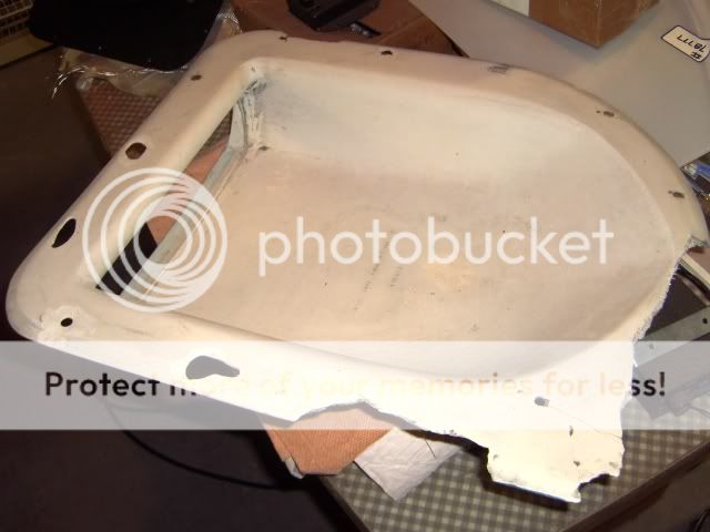

I found a 76 shaker dome on ebay for $70. I got it rather cheaply, since nobody wanted it because the metal mounting flange was unuseable as it was rusted with holes in it. The fiberglass, though was in remarkably nice shape with only one rivet stress crack and a small edge of the lip missing.
http://i466.photobucket.com/albums/r...b/S7006096.jpg http://i466.photobucket.com/albums/r...b/S7006097.jpg http://i466.photobucket.com/albums/r...b/S7006094.jpg |

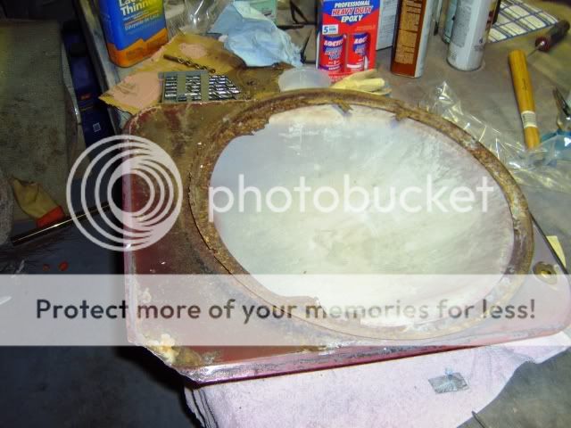

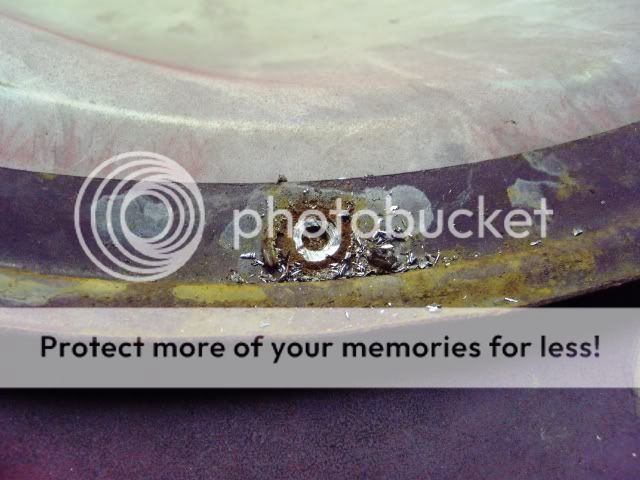

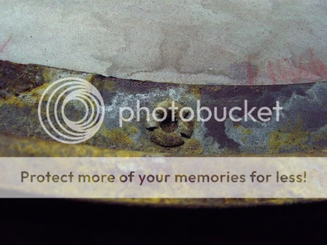

Removing the rusted late model base plate flange was rather easy. There are a dozen or so rivets and I gently used a drill to cut the bottom of the rivet off, allowing the base plate to be removed.
http://i466.photobucket.com/albums/r...b/S7006117.jpg http://i466.photobucket.com/albums/r...b/S7006114.jpg http://i466.photobucket.com/albums/r...b/S7006125.jpg The remaining portion of the rivet can then be popped out of the hole with the tip of a pencil. http://i466.photobucket.com/albums/r...b/S7006121.jpg |

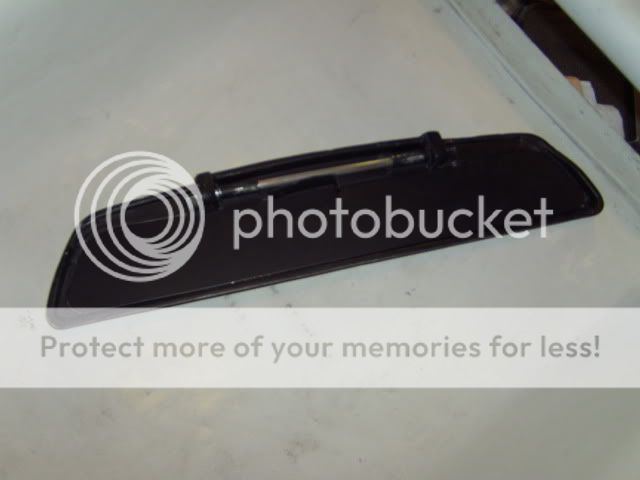

This is the flapper door assembly. Sorry I didn't take any photos but I was so busy fixing it, I forgot. The frame was a fiberglass jigsaw puzzle busted into four different pieces but I was able to reassemble and repair it with epoxy and fiberglass bondo.
http://i466.photobucket.com/albums/r...b/S7006104.jpg http://i466.photobucket.com/albums/r...b/S7006105.jpg This assembly was originally glued into the shaker domes with some type of red resin epoxy that gets rather brittle with age, which is actually a benefit since it is easy to chip away in order to free either the flapper door assembly or the block off plate assembly. Here it is set into its original position in the busted shaker. http://i466.photobucket.com/albums/r...b/S7006107.jpg |

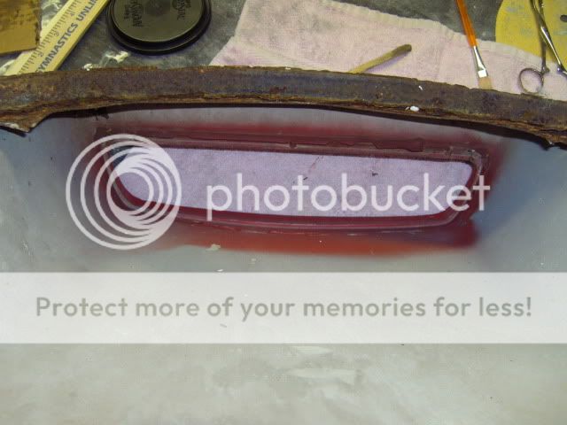

Luckily the prior owner of the 76 shaker dome had already relieved it of the block off plate and frame, leaving only some excess red resin epoxy to remove.
http://i466.photobucket.com/albums/r...b/S7006095.jpg That's it at the moment. Next step is to strip the paint off the red shaker and do the repairs of the rivet crack and the missing edge. |

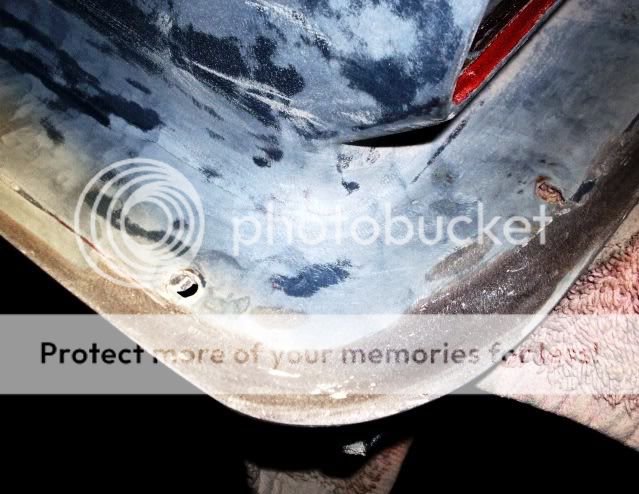

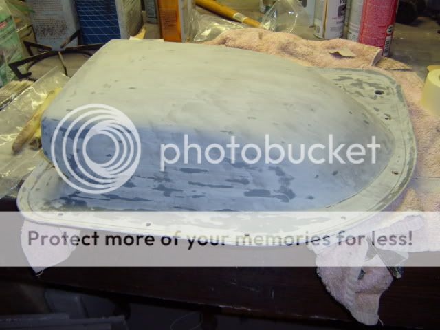

I used some paint stripper and got the majority of the original red paint off the dome. Went pretty quick. I then washed and sanded it down with a handheld Black and Decker mouse sander.
http://i466.photobucket.com/albums/r...b/S7006133.jpg You can see the missing edge that needs to be reconstructed on the lower left. Also, anywhere I thought it looked like a stress crack was forming from a rivet hole, I grooved that area out with a Dremel tool. http://i466.photobucket.com/albums/r...b/S7006134.jpg |

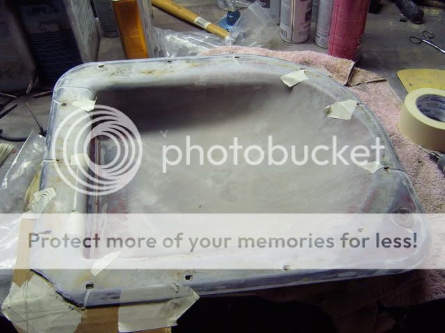

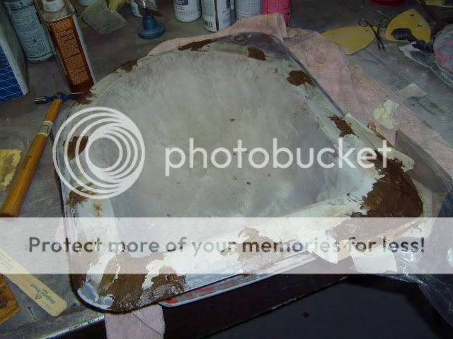

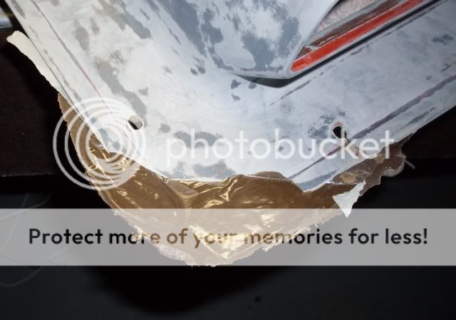

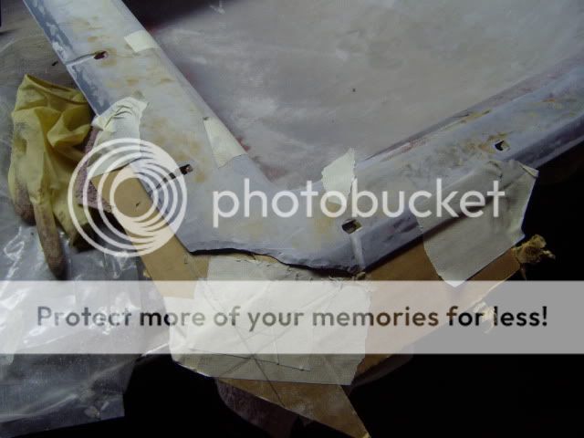

To map out the area for the reconstruction, I taped some cardboard underneath and then estimated the outer dimensions.
http://i466.photobucket.com/albums/r...b/S7006135.jpg I then used a plastic bag under the supporting cardboard to prevent the fiberglass filler from sticking to the cardboard. After mixing the fiberglass Bondo, I applied it "liberally" to all the grooved areas and the edge area. http://i466.photobucket.com/albums/r...b/S7006141.jpg |
