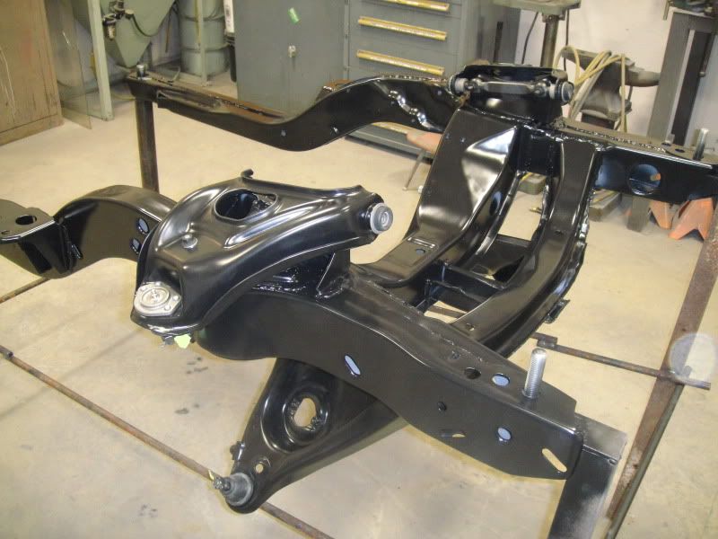

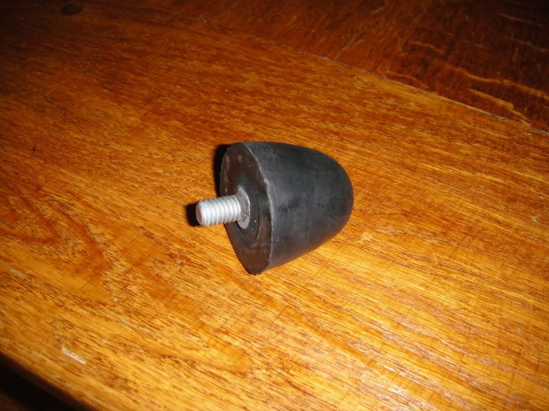

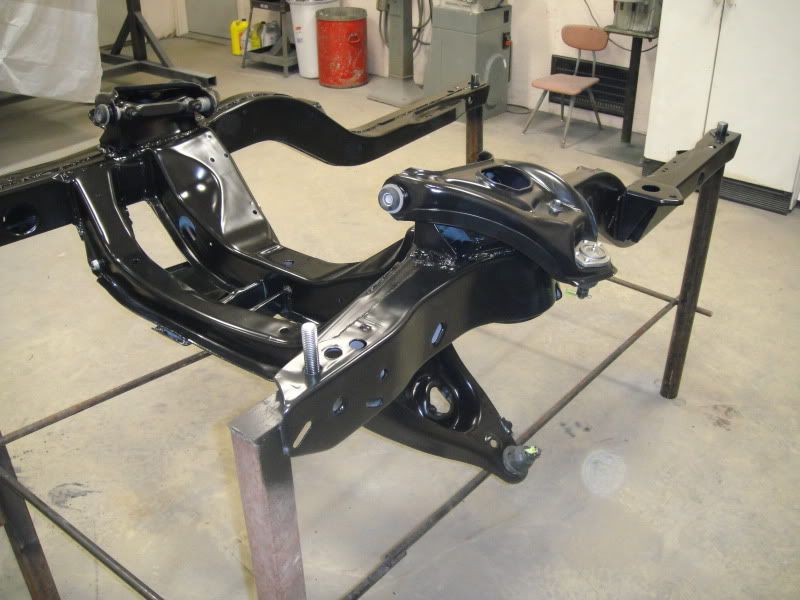

As for the L79 I have been moving forward with the restoration. Just slowly! I have both the upper and lower control arms all painted with the new bushings and ball joints pressed in. I am working on the sub frame now. This is one of the control arms finished, I just have to install the 68 nova heavy duty suspension bolt in snubber .

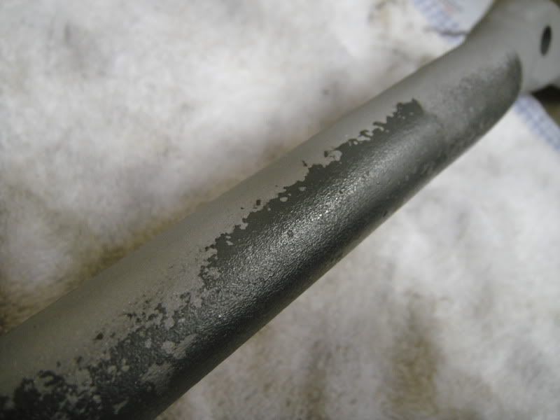

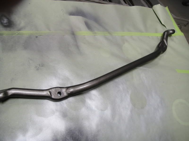

One thing I did find on my steering center link was a unique finish. The center link had a silver/ blue finish that was very hard to remove in the sand blast cabinet. I tried to duplicate it the best I could. Some say the finish is part of the heat treating process?

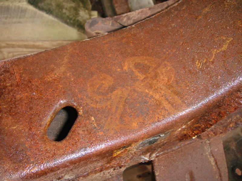

On the driver side of sub frame I found some grease pen markings. At first I thought it was an (EP) marking but after I cleaned the area it looks like (SP)
http://i35.photobucket.com/albums/d1...hale/007-1.jpg
On the passenger side I found an (L-I) marking.
http://i35.photobucket.com/albums/d1...nchale/001.jpg
Not really sure what these mean. The SP might be special performance maybe? But the (L-I) I have no idea? Anyone?

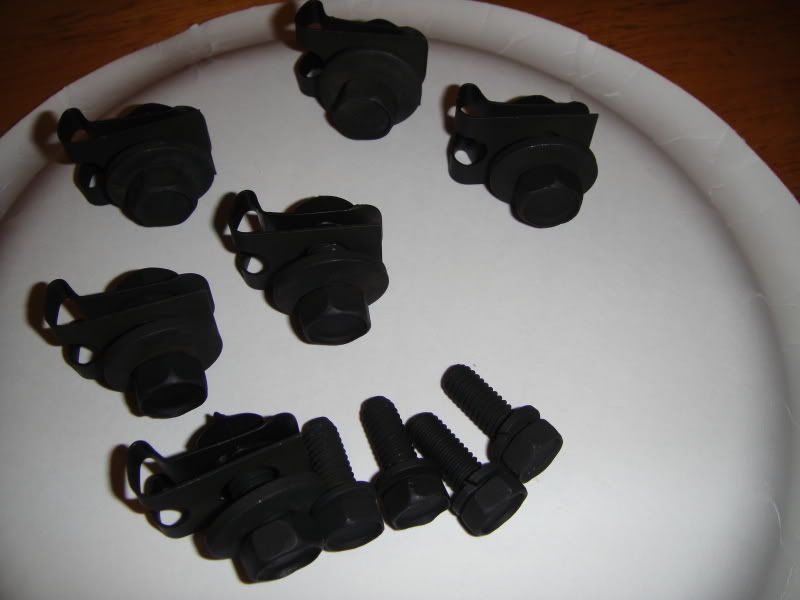

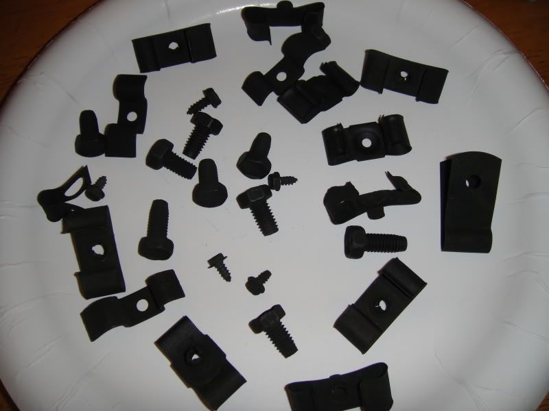

A lot of my time lately has been spent cleaning and detailing all the small brackets, nuts, bolts, and clips. I bought a phosphate kit from Caswell INC. It has a penetrating sealant you put on the parts after you phosphate them. It seems to help the parts from flash rusting after the phosphate process. Overall it’s a very easy process and the parts look great. Anyone else use this kit from Caswell?
http://i35.photobucket.com/albums/d1...nchale/002.jpg
http://i35.photobucket.com/albums/d1...hale/001-1.jpg

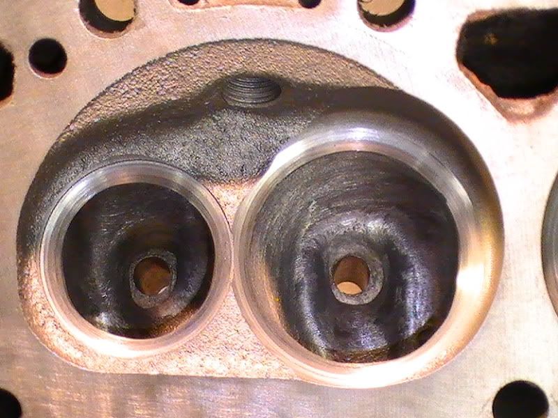

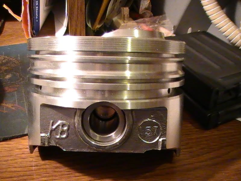

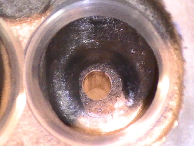

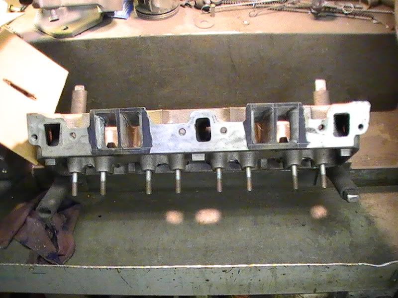

The machine shop did some mild port work to the heads for that little extra power out of the L79. Just in case someday we end up at the ¼ mile.
http://i35.photobucket.com/albums/d1...e/PIC_1260.jpg
http://i35.photobucket.com/albums/d1...e/PIC_1259.jpg
http://i35.photobucket.com/albums/d1...e/PIC_1255.jpg
The new heartbeat!

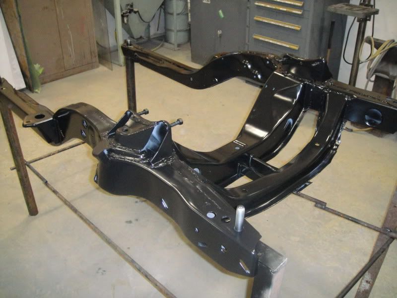

Any tips for installing the springs in the perches?
http://i35.photobucket.com/albums/d1...ubframe002.jpg
http://i35.photobucket.com/albums/d1...ubframe003.jpg
http://i35.photobucket.com/albums/d1...ubframe004.jpg
olredalert 12-24-2011 11:03 PM
Re: My new 1968 Nova L79 project.
----Internal spring compressor. If you can figure how to do it without scratching something, somewhere count yourself as very lucky and go buy a lottery ticket.....Bill S
Plowman 12-25-2011 06:08 AM
Put the moter mount stands in before you put the springs in,will be easy now. Hope that helps. *Paul
Nova Jed 12-29-2011 12:46 AM
Jason, last year I put my springs in with the internal spring compressor and used a lot of blue painters tape on the subframe, springs, and compressor arms. Worked out pretty well. I just had to peel the compressed tape off the shock mount hole in the top of the subframe after the upper and lower control arms were bolted to the spindle. Cheap insurance! Hope this helps?
