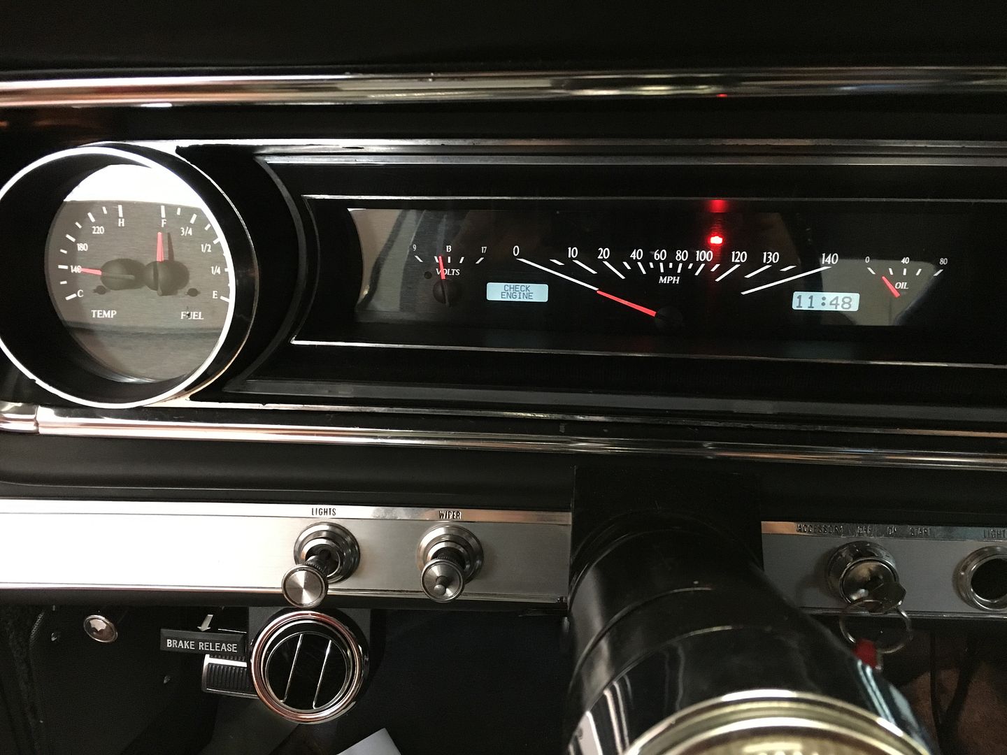

Pulled the gas tank out today and got the leak fixed (Teflon Tape instead of pipe joint compound......Lesson Learned-AGAIN !!!!!)......Then I finished the Dash install......Started programming the Dakota Digital system and got a few issues........I'll call them tomorrow and their Tech Support will walk me thru the programming sequence........LOL.......Also.......the neutral safety switch is fighting back.........waiting for a call from Shiftworks to resolve that issue.....
Here's a pic of the dash.........(engine off , key on, lights on)Check engine light is on because the O2 Sensors aren't installed yet..........Going for the Exhaust on Monday........
