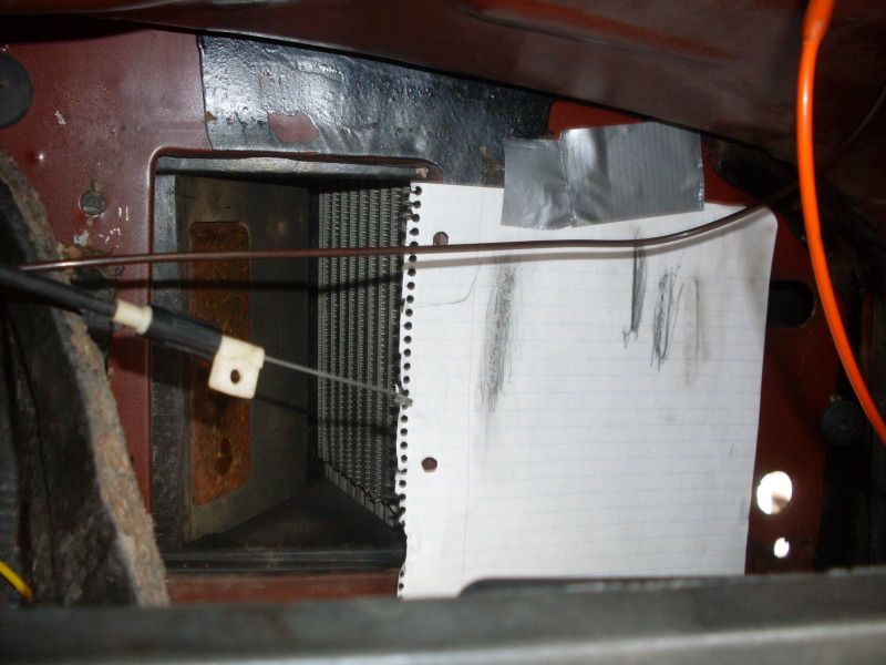

Today's project was getting the heater core out. It actually went rather well. You have to remove the pass side inner fender to do it properly in order to access the lower studs and the heater hoses. Otherwise you will spend hours with extensions, lost sockets and scraped hands. It took me ten minutes to pull the inner fender and then another ten minutes to get the nuts off the studs. Once inside the car you have to pull the glove box door, glove box and the A/C ducts from one side to the other. That way the heater assembly comes out easier. In total it took about an hour to get everything out of the car. Now I have to wait for the new core to arrive....
While the heater was out I was able to see the VIN stamped in the firewall which was a reassuring thing. I then wiped the giant black seam sealer waterfall away from the area and was able to do a pencil tracing of it. Remember it is upside down and backwards since it was stamped from the engine side - so don't have a heart attack if you try this on your car and it at first doesn't match. Take your tracing and hold it up to mirror and it will magically transpose. Or you can always just flip the photo in your photo editing program.
[img]<<GRAEMLIN_URL>>/scholar.gif[/img]
